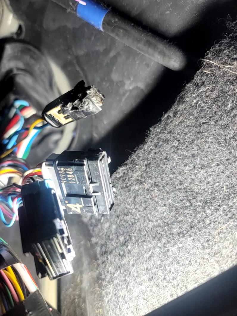

Tried figuring out why my rear lights are not working . Think it has something to do with this burnt diode.
" help be nice please "

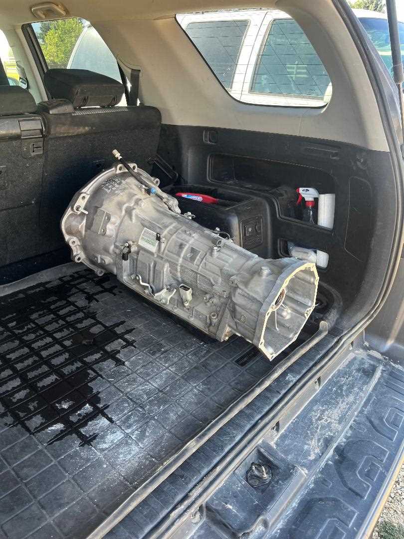

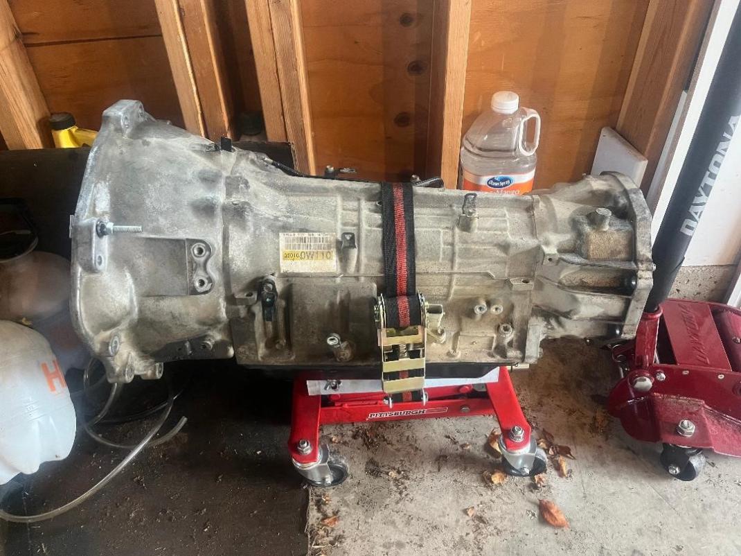

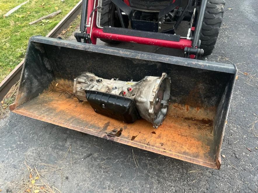

I opted not to do the transmission replacement in our 2014 and let our local mechanic handle the replacement transmission install in the 2014 4Runner. The truck is back to running good as new. Mechanic said it would take him 4 hrs, but it took him 6. Said there were 6 bolts that were a challenge, but relative to a 10 year old car with 365K miles, it was nothing.
$800 for salvage takeout transmission with 43K miles delivered to Missoula for free.
$1,085 for removal and install.
$85 for rear main engine seal, front and rear transmission seals.
$85 for transmission fluid.
By comparison, a reman Aisin 750 transmission runs $2,700.
We did good on this.
Pics 1 and 3 of the old transmission, middle pic is the replacement transmission. Finding many uses for the tractor I bought this summer.

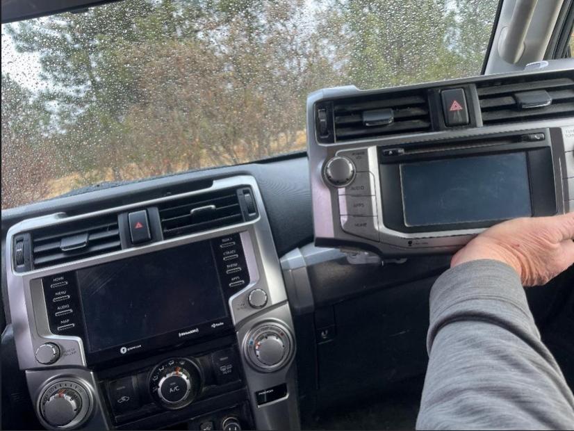

After experiencing the Entune 3.0 with CarPlay and larger screen in her 2023 ORP, my wife asked for CarPlay and bigger screen in her 2014. I went the retrofit route with the Entune 3.0 and retrofit harness by autoharnesshouse.com. Took a bit to figure out, but I got it there and it's working. One issue left, the salvage goons cut the navigation cord thinking it attached to the harness of the salvage vehicle. It does not. It simply jumps from the back of the navigation box to the rest of the head unit. New cord on order and it's $73.
