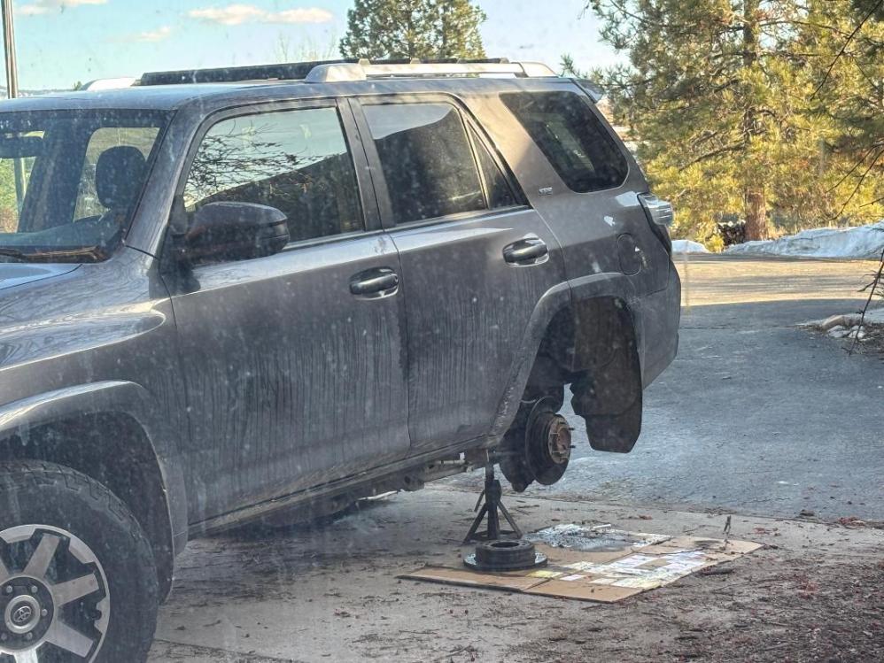

Rear brake pad wore through on the 2014 4Runner. Rotors already had a nice lip on them, so they were due to be replaced. This is probably the 4th set of pads. I had cleaned up the caliper pins and lubed them the last time. The unequal pad wear improved signicantly, but it’s time for new calipers.
I ordered new (reman) calipers (Raybestos), new rotors (Raybestos slotted) and pads (Raybestos
Light Truck). Left the 4R disassembled on stands at Montana home. I’ll be back on 4/5 to deal with it. Will take me less than an hour to put back together and bleed the brakes.

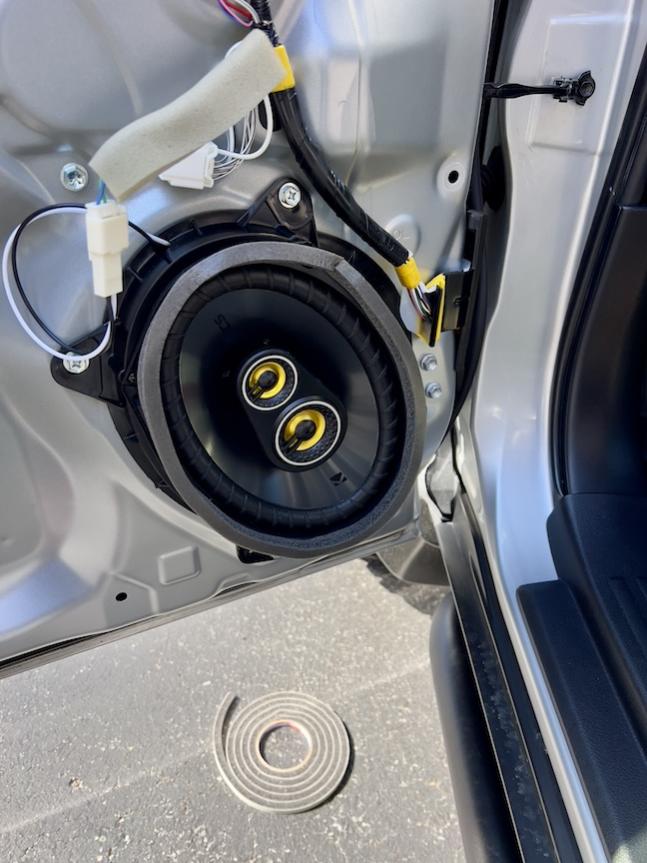

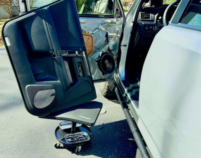

Quick front door speaker upgrade.
Not a 3-5k full stereo, amp + subwoofer system but a nice improvement for $100.
Kicker 46CSC6934 (Crutchfield)
The magnet on this was the size of a hockey puck vs the half dollar sized OEM speaker magnet.
Metra 72-8104 Speaker Wiring Harnesses
Metra 82-8146 Speaker Mounting Brackets
Cut a thin strip of Gorilla HD mounting tape (VHB) for my gasket between the speaker bracket and metal of the door.
Auto/Marine foam strip form Home Depot for around the outside of the speaker edge against the door panel (mimicking OEM speaker setup) I also used remaining pieces of this to wrap new harness wires to keep from rattling against metal.
Along with the Subaru Tweeter Kicker upgrade back a cpl years ago there is definitely a noticeable sound difference, good clarity and now an added low end/bass.
May do the rear doors/hatch at some point but in no rush as there's usually something packed blocking those speakers in the back.
Simple procedure and it's so much easier pulling panel straight off - after removing 3 screws and popping clips starting from the bottom, up both sides - pull towards you not up. That window piece stays in place and the panel goes back on just as easy.
I also didn't even remove the door lock or handle cables, just rested the panel on available stool.
First time I think since I was a teenager (a long time ago!) I just sat in the driveway and rocked out for a bit. :rockon:
