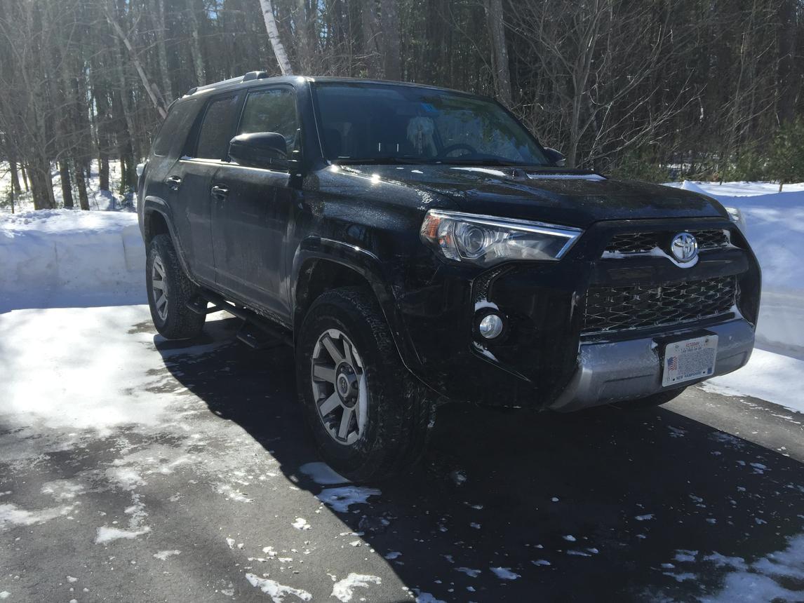

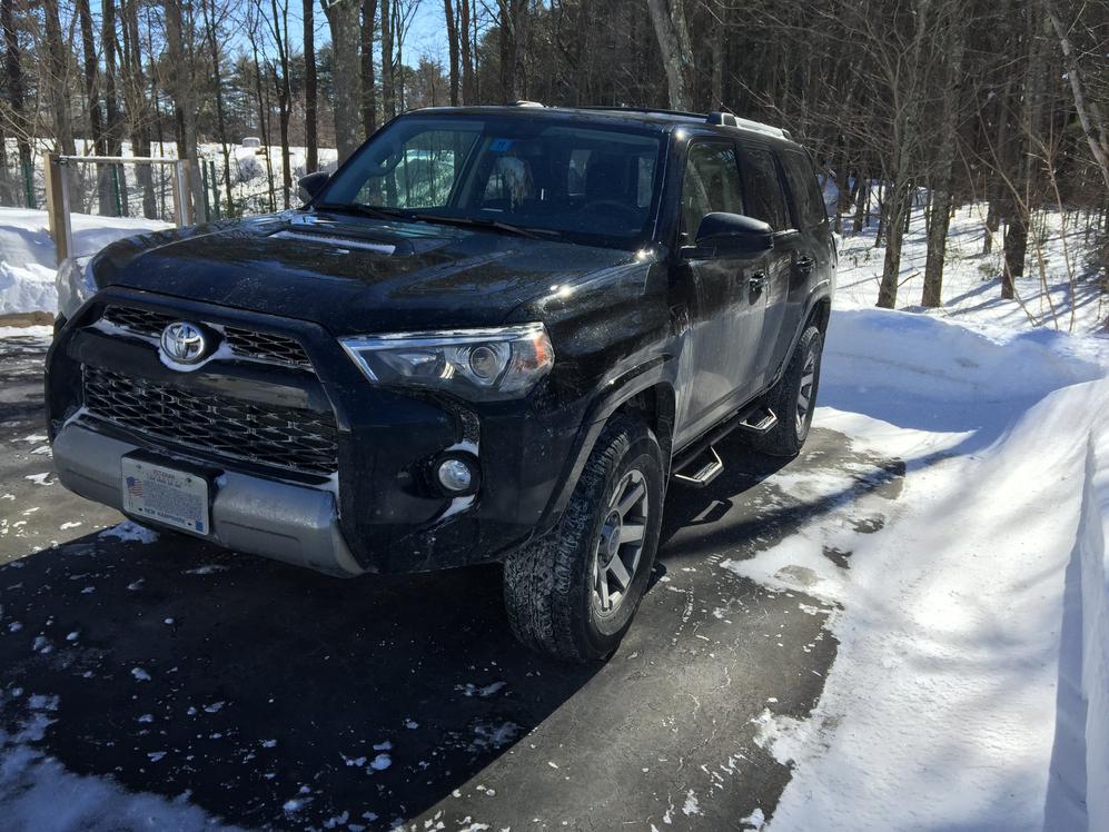

N-Fab Steps
Not today but Saturday... installed the N-Fab steps. Easier than the Tacoma... the 4Runner had bolts to remove. The Tacoma had paint in the threads and plastic plugs so the threads had to be cleared first. These just bolted right up with the provided hardware.

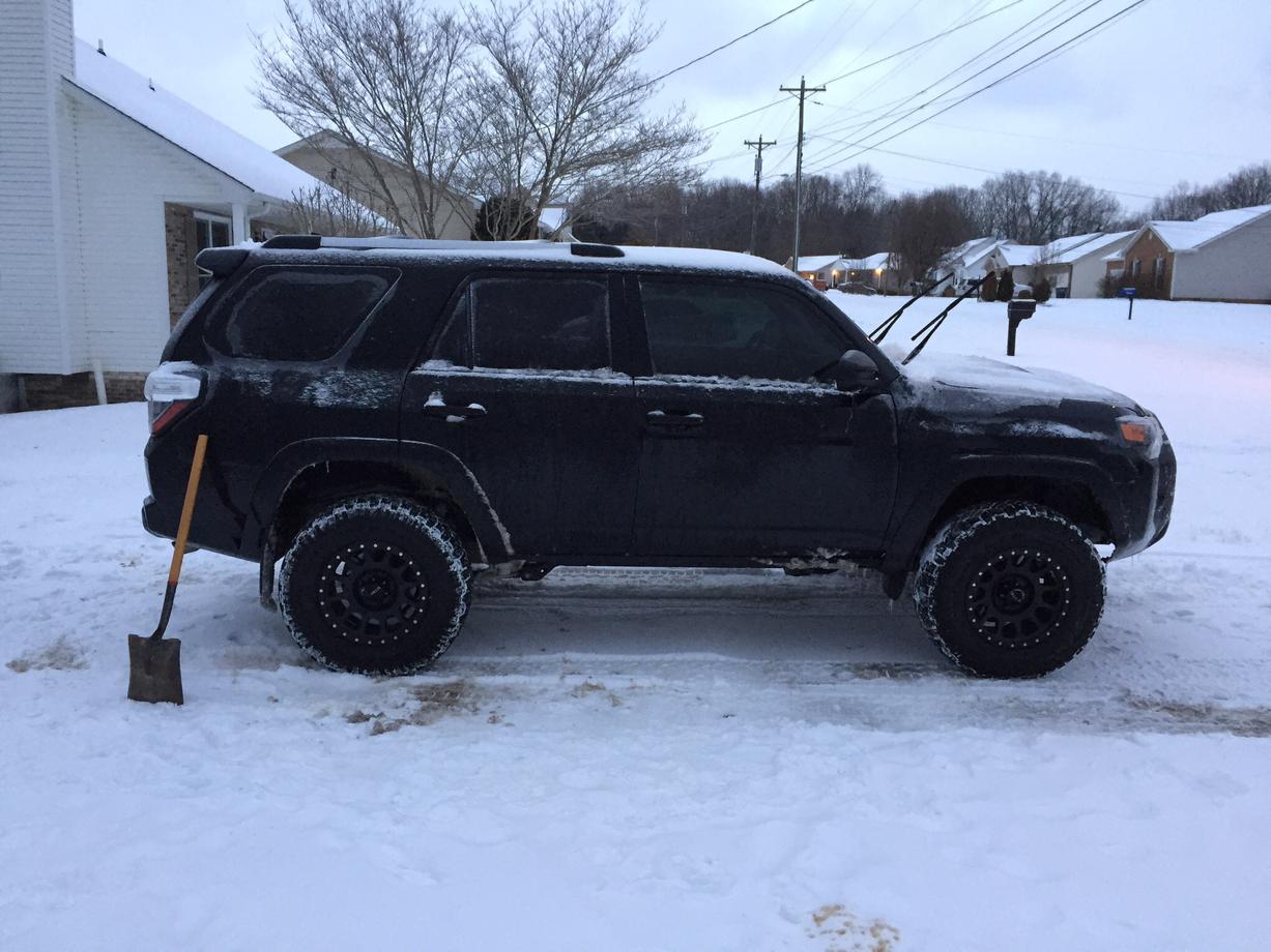

Lift install
Installed 5100's all the way around today. Set the fronts 2.5" and put some sway a way sprigs in the rear. Got the spidertrax 1.25" spacers in and did a little plastic fender cutting. Went pretty well despite the snow here in TN. Don't worry I know the snow here is a joke. I'm originally from Michigan so any snow the south gets is nothing in comparison. image.jpg

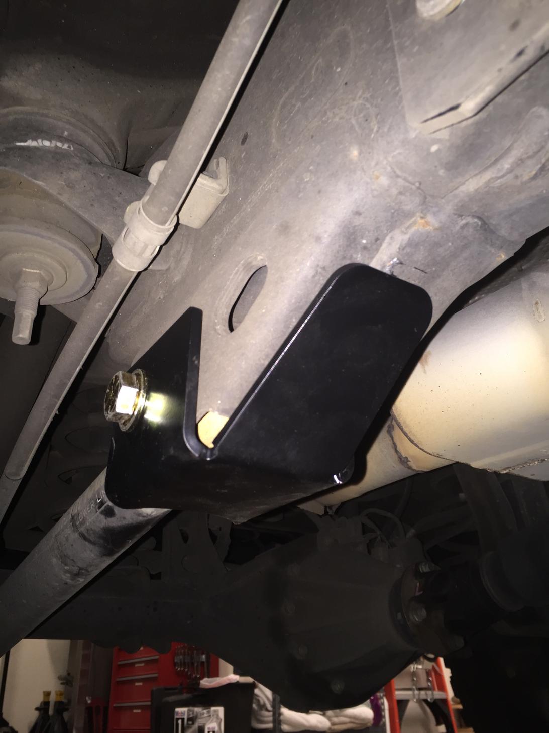

Installed OPOR (Metal Tech) lower link bracket skids.
Nice! I need some of those..dented the stock pieces I have now. Looks nice and smooth too
I am happy with them. Simple, yet effective design and they are reasonably priced. Some of the bracket skids do not fit with the oversized Johnny Joints on the Metal Tech Lower Links. These are specifically designed around the Metal Tech links, so it was an obvious choice.
Looking good. I placed an order for some last week. How long did it take you to get them in from the time of ordering? They quoted me 3 weeks lead time.
I think it took about 4 weeks delivered. The extra week was for the powder coating. I have to say I'm really happy with them but the wife says they are really not good for a step to get in.
