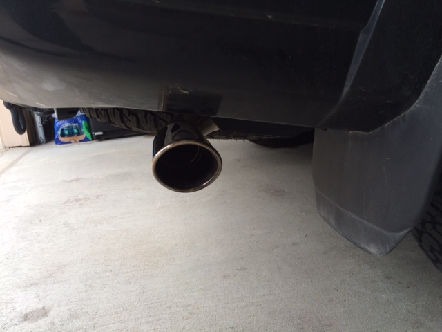

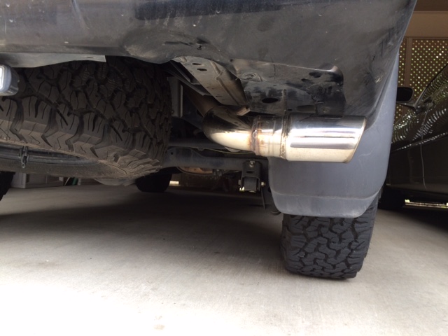

Had my side exit exhaust mod done today & pleased how it turned out!

Looks good man! What are the details on it?
[MENTION=115334]Mistaken[/MENTION],
Thanks on the "Looks good man!"
I already had the SS 4Runner Exhaust tip, so I bought the following off of ebay.
Yonaka Part# YMSS9025
Fully Polished!
304 Stainless Steel
2.5" OD 90 Degree Mandrel Bent Pipe - 6" Legs
1.5 MM Thick - 17 Gauge
Yonaka 2 5" Polished 304 Stainless Steel 90 Degree Mandrel Bend Pipe Tube 6" Leg | eBay
The guy I used (doing this for 20 years at his own shop), cut the OEM pipe just behind the hanger, cut the new SS pipe just before one of the bends, expanded the opening so he would be able to angle it down (so it would not be pointed down, but horizontal), but still fill the gap with the welds.
Before welding, he measured where the tip would be positioned, cut off excess amount of pipe for the side exit, flared the end slightly and welded to the OEM pipe and then my tip on the SS pipe.
It would have looked good with the SS pipe exiting without the tip as well, but since I already had it.....I told him to weld it
He did this effortlessly without issue!
OH, he charged me $40.00 out the door. :reddance:
Hope this helps!

Looks great!
I wish I could find a "guy" around here that would do something like this at that price for me! $100 here, $250 here .. :playball:

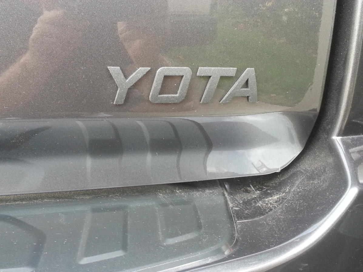

Dipped my free "Yota" badges and found a good spot. Limited to 8 characters so I just spelled Yota twice. Worked out good.:reddance:

Thanks on the "Looks great!"
Sorry to hear that TBrock
That's insane!
It took him less than 30 minutes time to do the whole thing with my parts.
That time is on the rack to out the parking lot.
He didn't cut/reweld any hanger, just worked on piping behind the hanger!
