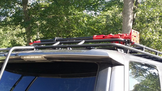

Hi Lift Mount and MaxTrax
Copied custom idea from [MENTION=116723]Spixelz[/MENTION] and mounted Hi Lift Jack. Used plastidip to cover the white spacers.

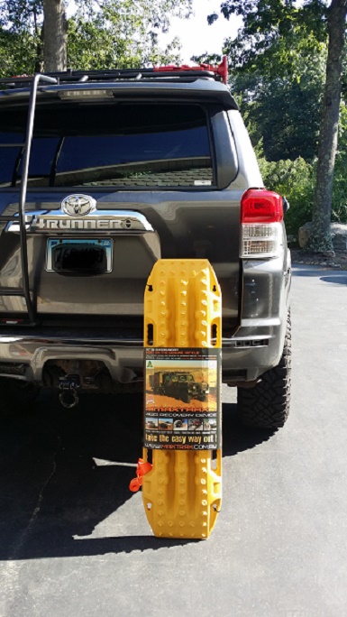

Planning to store MaxTrax behind passenger seats.
Will they fit back there? I didn't think there was room between the wheel wells, hence why mine are on the roof.
Hey, not sure what you're expecting to use your maxtrax for, if sand then your storage should be ok, if mud, you might wanna rethink. Mine get super dirty and caked so putting them inside the vehicle wouldn't be wise.
Yes sir, mounts from MaxTrax on order. Missed that option during the group buy.
They fit in front of the wells behind the 2nd row. Just barely.
I keep a painters plastic and a cheap towel in the car. If the Maxtraks are muddy so am I.

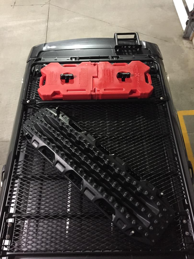

How did you mount them on the roof?
With the MaxTrax Mounting Pins and large washers to sandwich the rack between the washer and the mount. It took several tries to get them installed in a position that didn't require excessive force to get the mats on I am happy with them up there vs inside. Only major downside is currently there is no way to lock them so anyone who knew what they were looking at could make away with a couple hundred bucks in mats in a hurry. However.......I avoid sketchy places, the mats are hard to see on the roof, most have no idea what they are, would assume they were locked and I don't live my life in fear so I doubt I will worry about figuring that one out.........that said I do plan to do something about the 40" light bar as it is more visible and would not require getting on the roof to steal.

Did the MaxTrax not fit horizontally the Gobi? I just got mine but havent tried laying them across the rack yet.

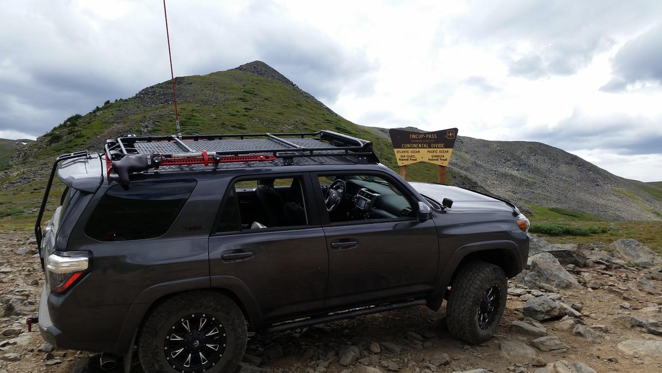

Went to the Colorado Toyota jamboree this past weekend. Wheeled Tin Cup Pass, Iron Chest Mine & Billings lake.
