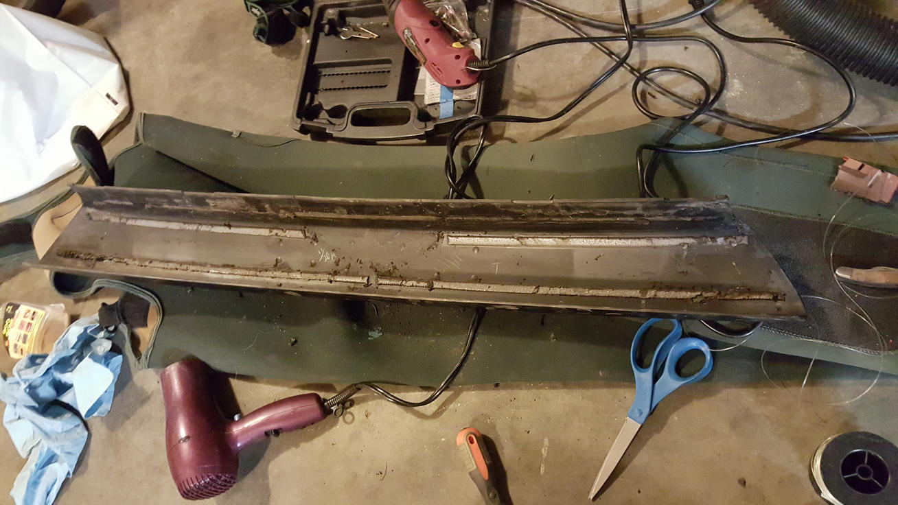

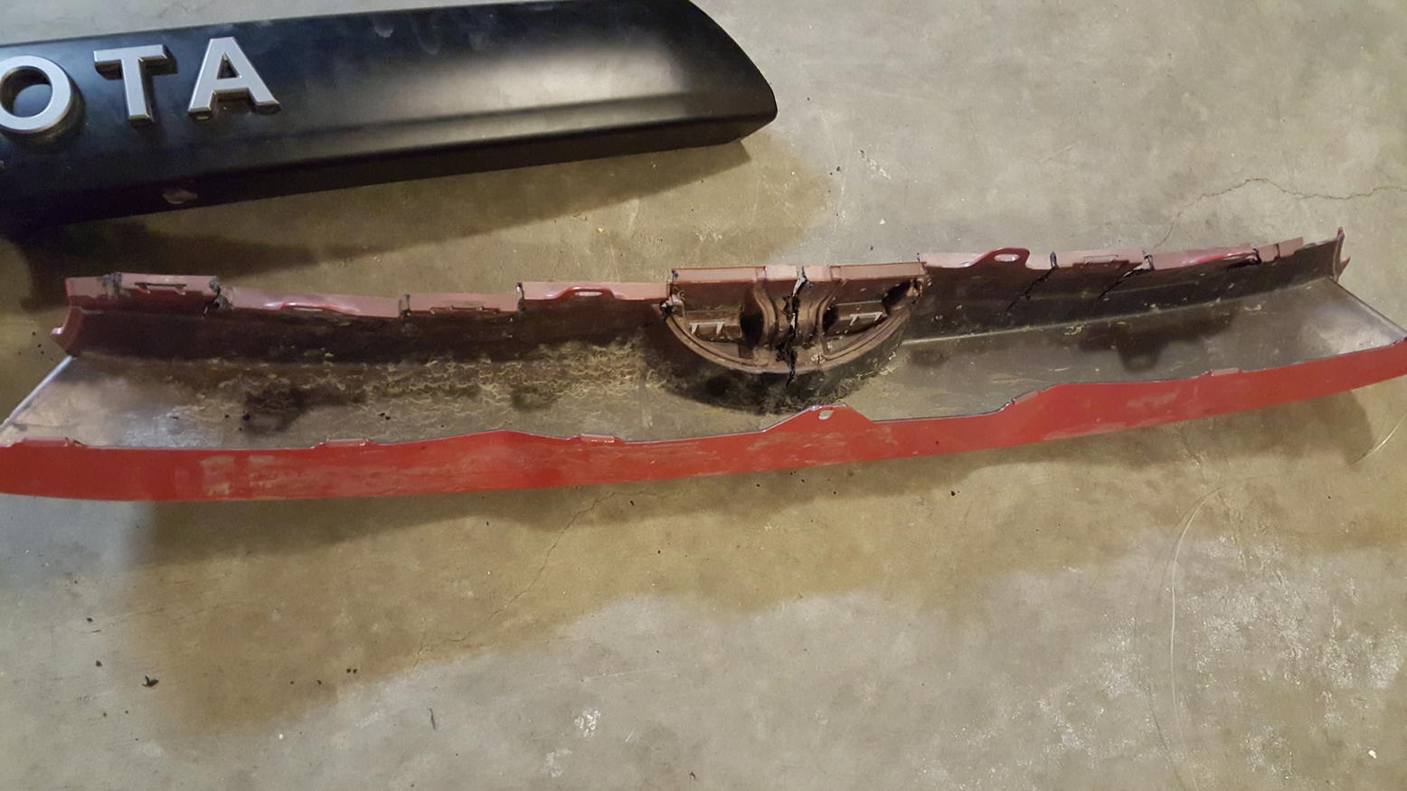

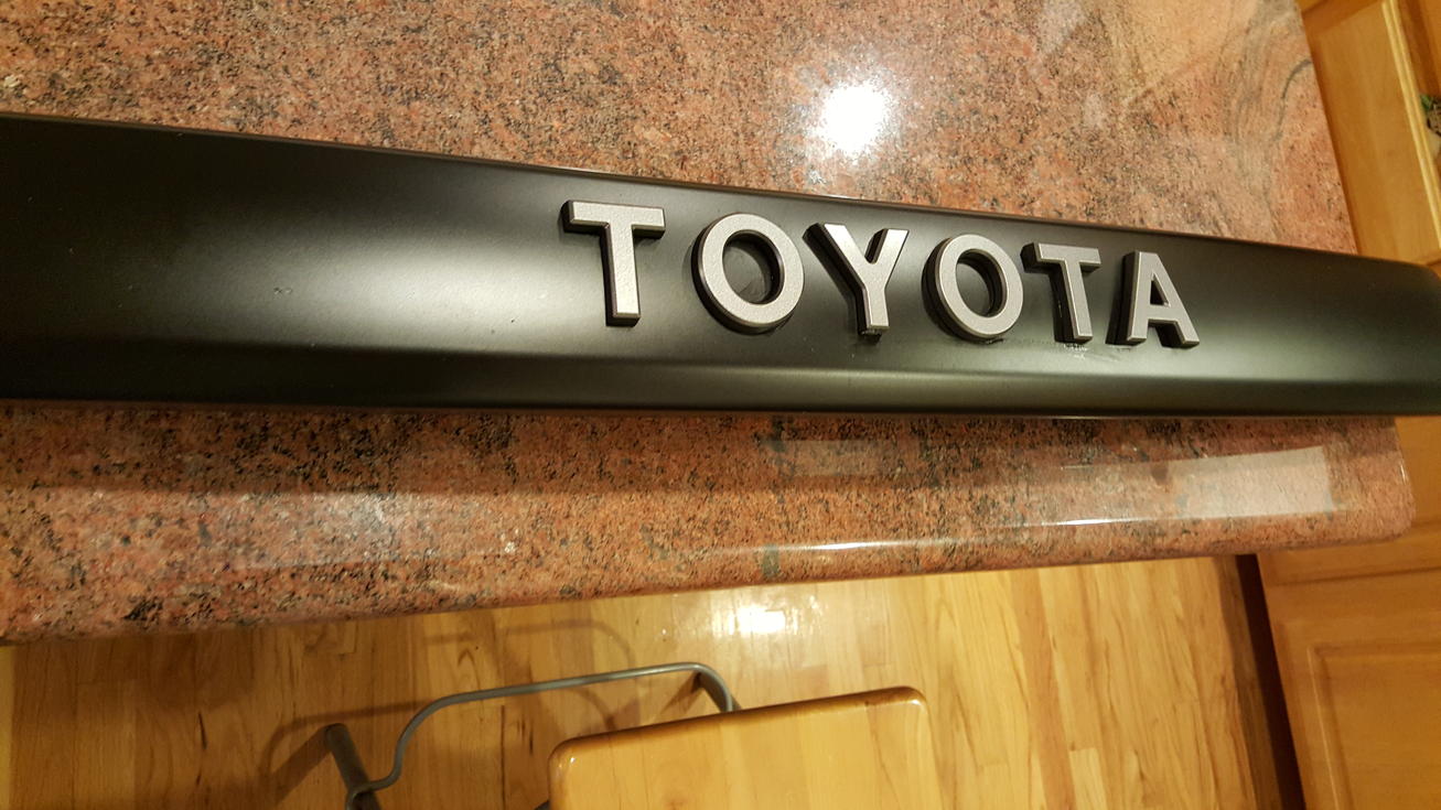

Removed the TRDPro garnish. Quite easy but just gotta be careful and patient, which both I lack. :ohwell:
Anyway, if anybody here wants to remove their garnish(to sell or whatever) I'd recommend a lot of Goo-Gone, 50lb monofilament, a long thin flathead, Heat gun/dryer. I used a HF dremel to cut some tabs to help peel the plastic support off one section at a time.
