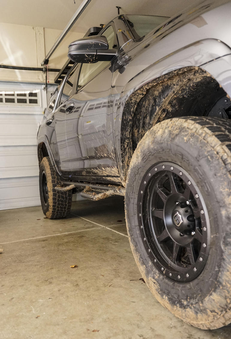

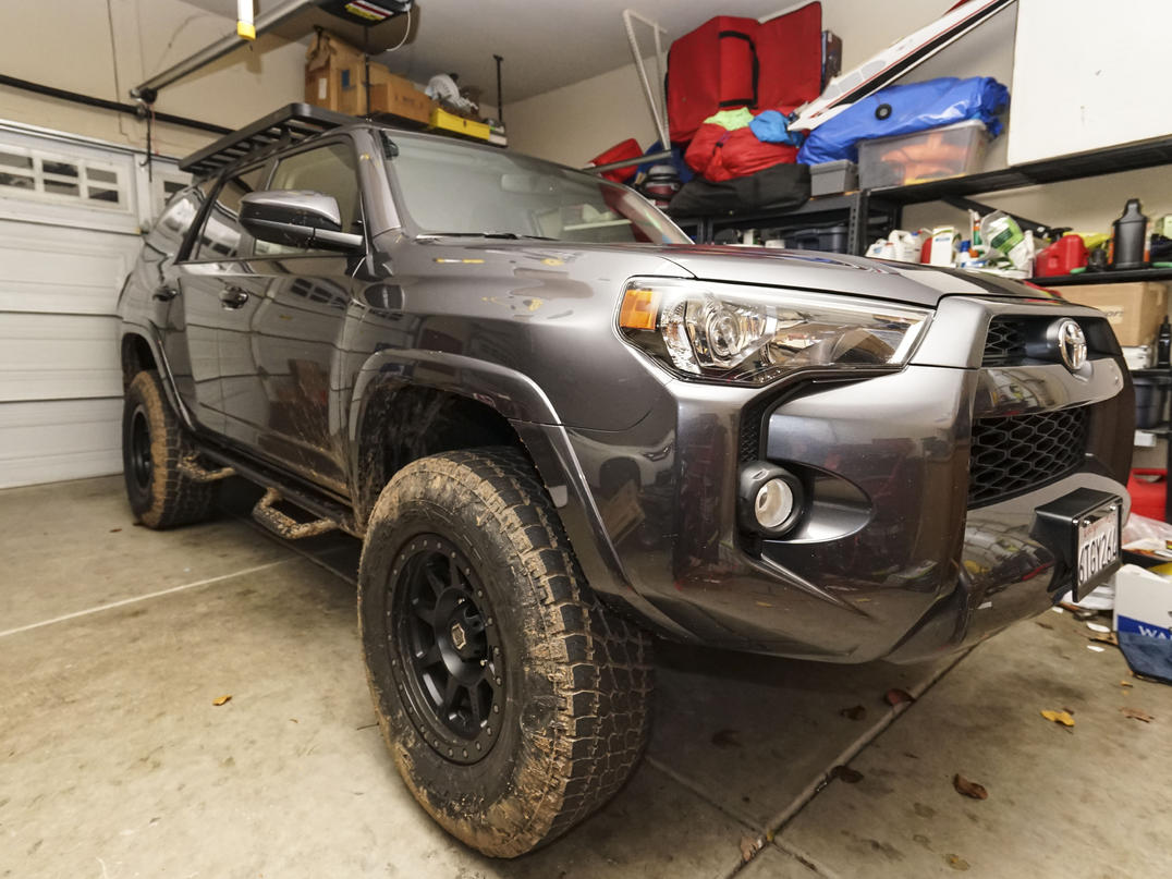

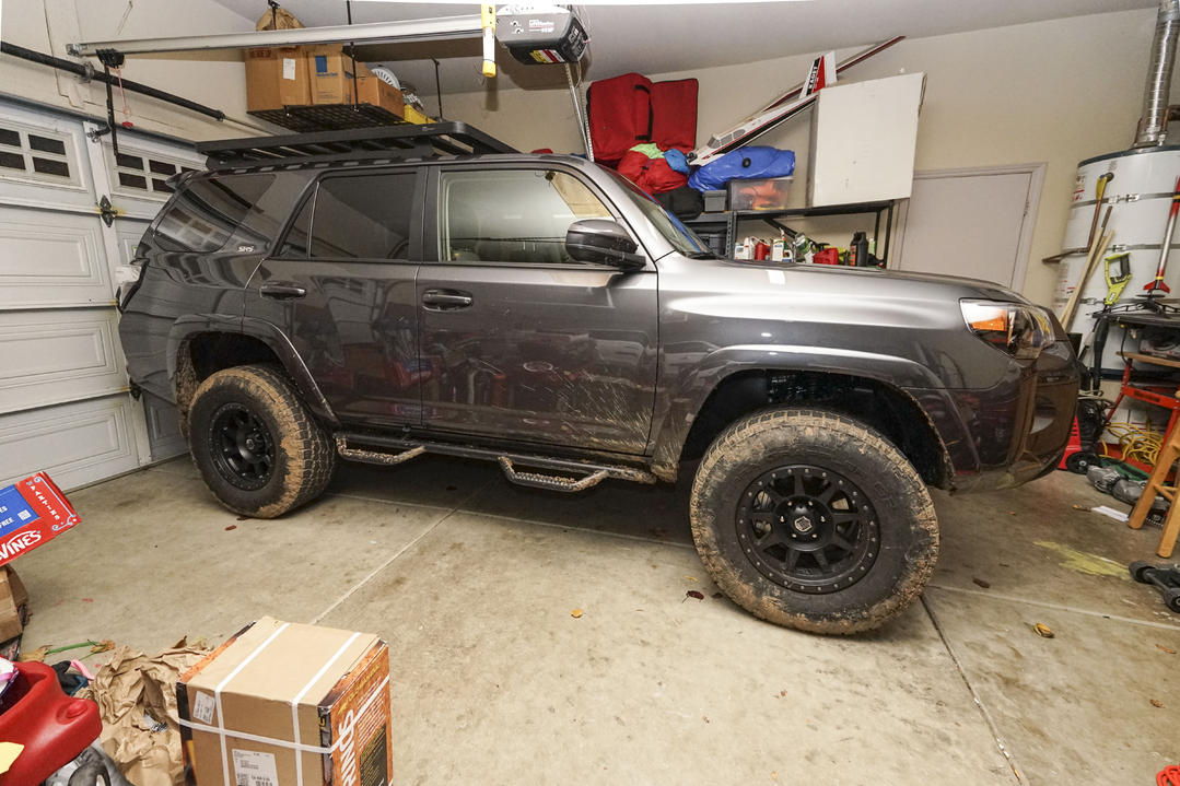

Alright! I got the front bilsteins and OME springs installed so my suspension is complete. Install of the front took about 2.5 hours. I tried using the spring compressor I bought at Harbor Freight but I couldn't get all the hooks onto the springs. They were too fat to fit in between the coils. So I removed both stock coil overs and bright them and the new springs and struts to my friends tire shop. I had them dissemble the stock stuff and assemble the new ones. After I got it all set up I did a little off roading to see how she did and got some mud on her. The new ride feels nice. Now I have to sell the Truxxx spacer kit and stock suspension I had in it.
