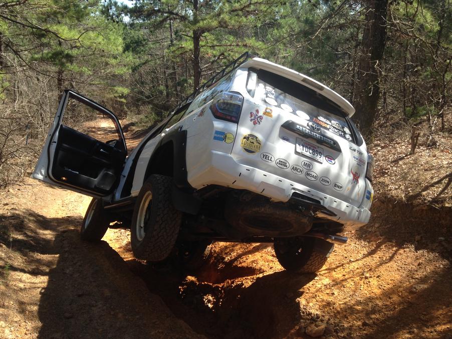

Found a tiny little hole while going to clear my campsite for Jamboree.......

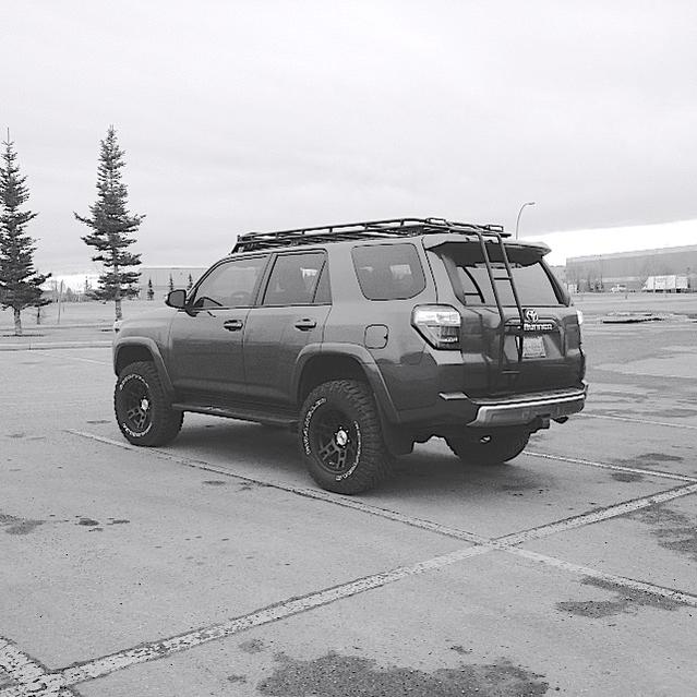

Today I removed the lower air dam trim from my front bumper. This makes it much easier to push my fender liner in to eliminate rubbing, and makes the front look taller. Thinking about adding a front skid to clean up the look a bit. I really love the look of the TRD skid and think its possible to make it fit, I just wish it was actually as stout as the aftermarket ones.
I also bit the bullet and ordered a set of Camburg ball joint UCA's. I was getting tired of the squirrelly handling on the highway, especially when there's a strong crosswind. Hopefully the added caster will eliminate the BM rubbing as well. I decided that if I was going to have to take everything apart up front I might as well upgrade from my stock front coils. So I ordered some Toytec 2.5" coils with the top spacers for a full 3" lift up front :reckon:
Finally, I ordered a set of TYC 2014 LED rear tail lights. Last weekend I smoked my stock tails with Niteshades. While they do look cool I had problems backing out of my driveway in the dark due to the reduced reverse light output.
Can't wait to see how this all looks and performs!

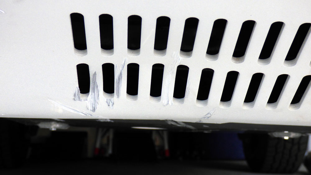

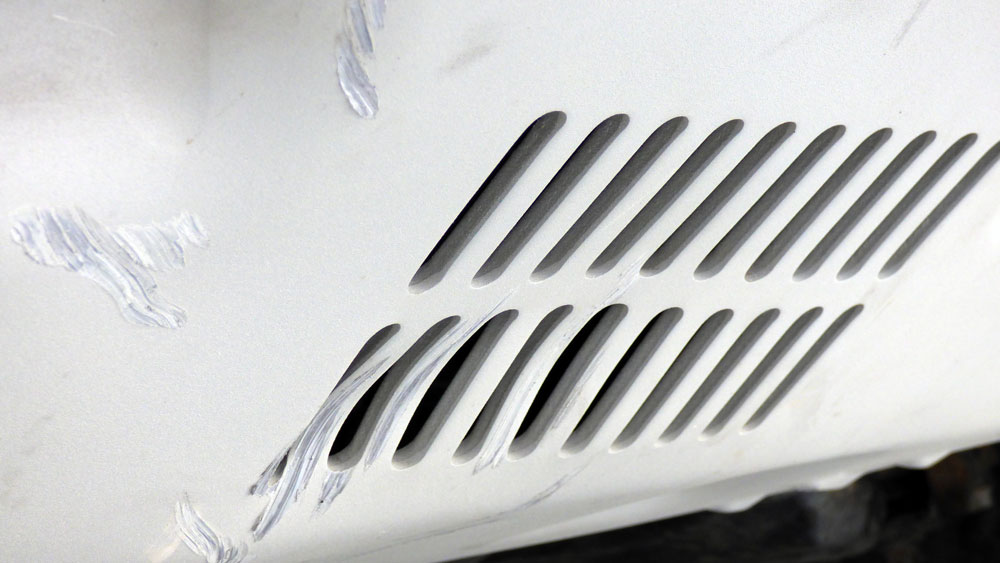

Why do you think it isn't as stout as an aftermarket one? I hit this rock hard and the only reason it bent is because it is in the vented area. It seems as strong as the rest of my RCI aluminum skids, and is just as as thick.

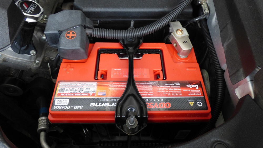

With the addition of the Fridge I really needed a new battery. THe stock one was barely hanging on as it was. If I used the stereo for 15 minutes without running the 4runner, it was hard to start. Since Sears no longer carries the Platinum series battery I went to it's sister battery, the Odyssey 34R-PC1500. I considered the 31M but didn't really want the extra weight for now, and if I ever do add more power hungry things like a winch, I may just do a dual battery setup.
I cleaned up the hold down and the battery tray. Both still had some mud even after my extensive cleaning of the belly of the beast. Changed out the red anti-corrosion spray coated stock connectors for some Platinum Monster Cable connectors from an old install. I think they look much better. When I started up the 4Runner after the install, I was shocked at how much more aggressive the starter was. It actually spun hard. What a major upgrade.

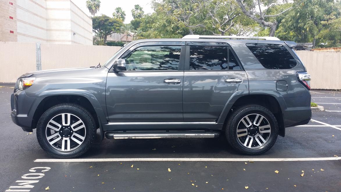

Looooooong uploadfromtaptalk1456699999917.jpgtime lurker in this thread, first time poster.
Today I was reunited with my 2014 Limited, stock aside from tinted windows and a cell phone cradle. I've been out of town for work all month driving a damn yaris. It felt so glorious mounting this familiar silver steed.
I've resolved to finally make a few mods I've always wanted. I want a bit more aggressive look but will by no means be offroading aside from some occasional snow fun.
From my limited knowledge I'll need:
-simple body lift of 2.5 in the front and 1.5 in the rear using easy to install spacers ($100-200)
-set of 17" rims (~$800)
-set of nice all terrain tires ($800-1000)
Are my assessments accurate, aside from the recommended alignment with the lift? Are my costs accurate? Any help is appreciated! Thanks in advance, guys.
