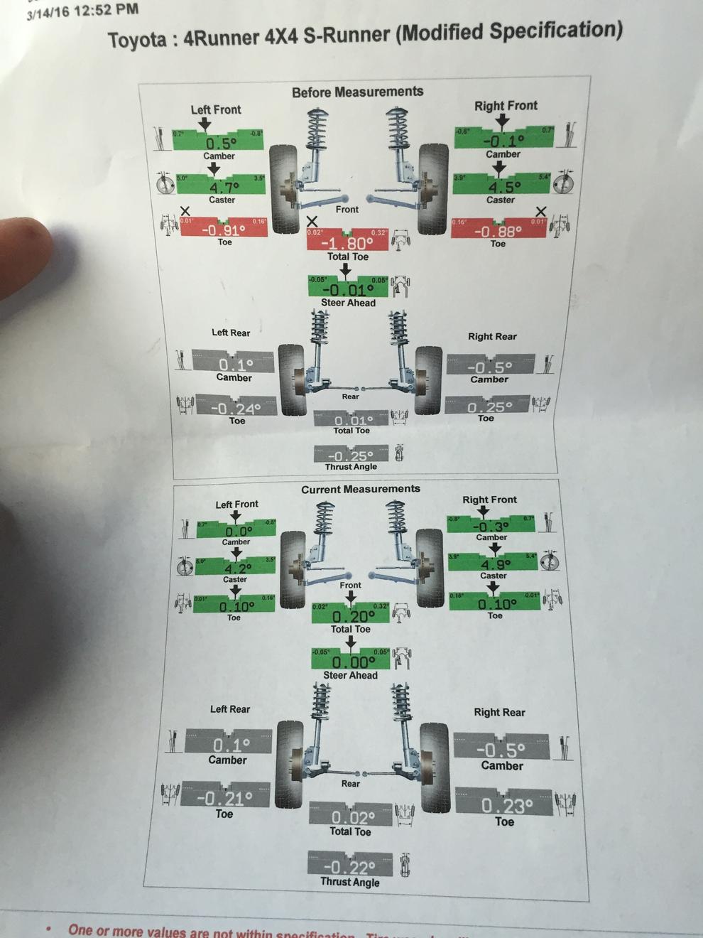

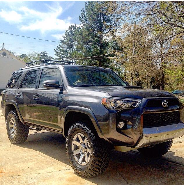

So I had a request for a picture of how my alignment came out after the JBAoffroad parts 4Runners 03 + - Toyota went on recently so here it is... And it rides like a dream now! Definitely recommend to those that are looking for a great quality product at a reasonable price, while also using materials that are easily maintained...

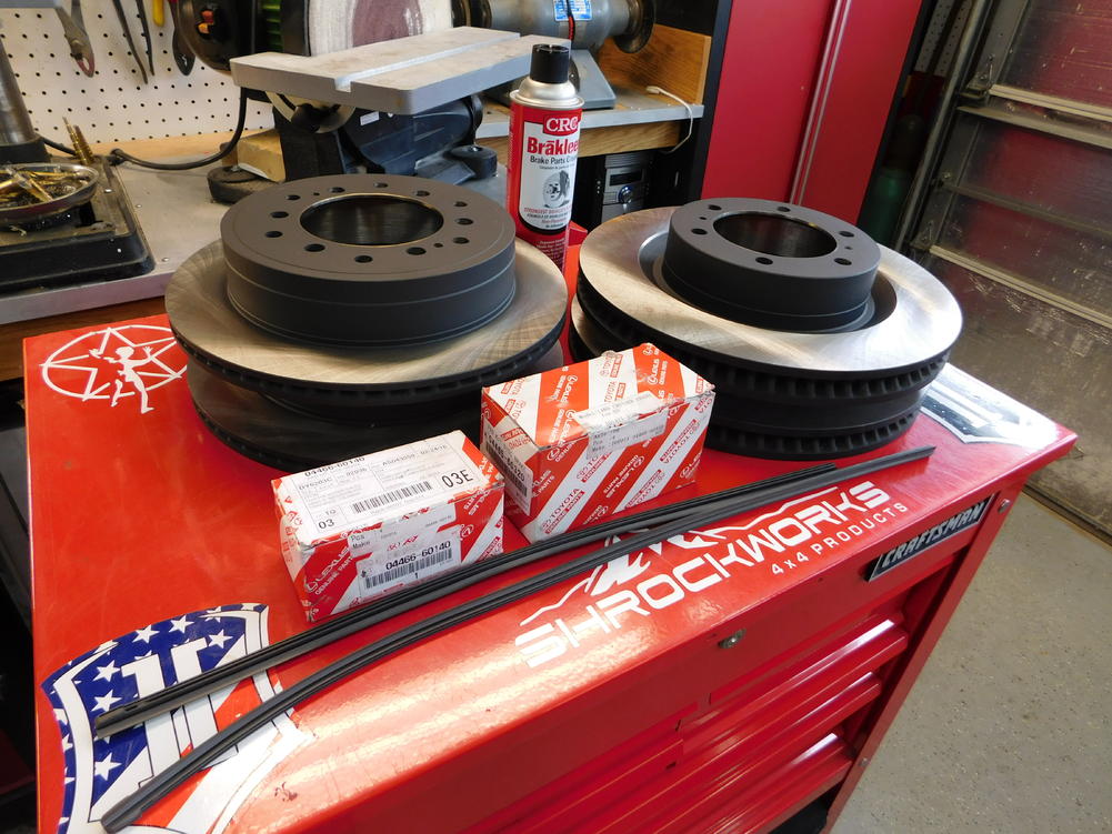

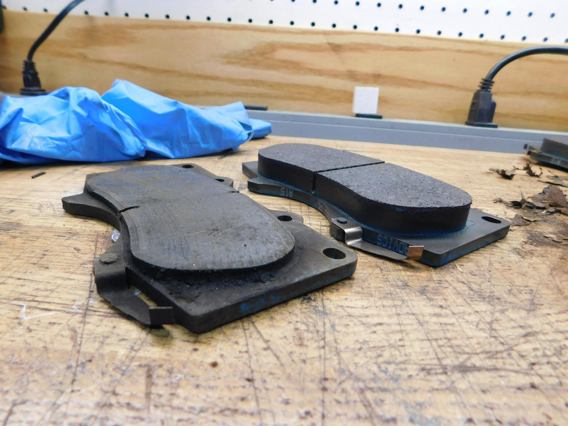

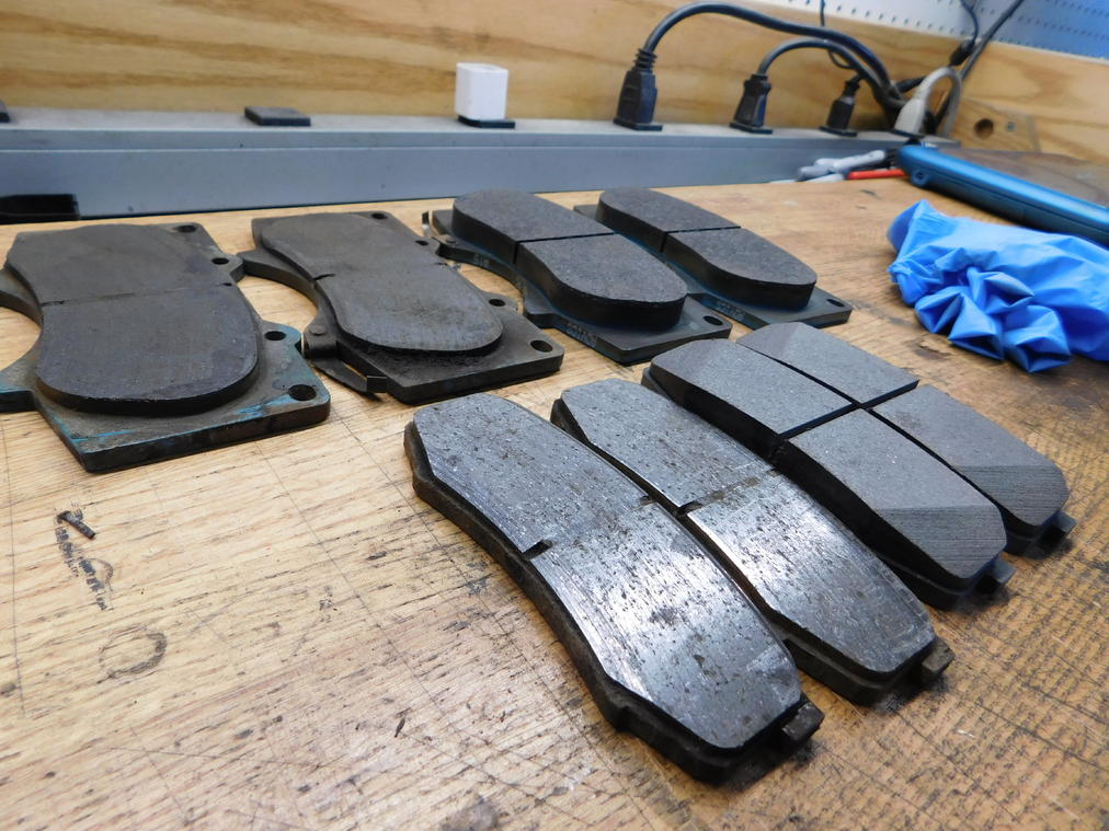

Finally replaced my pads/rotors at 95,000 miles, very easy brake job! Honestly, they still had plenty of life left. Factory spec is 1mm of pad before replacement. The most worn pad was 3mm, the others had much more than that. The old rotors are in perfect shape too. I think I'll have them turned and save them for the 200,000 mile replacement, lol. Used all OEM brake parts- a FIRST for me! Nice to get some pedal travel back, but otherwise the new brakes feel exactly the same. Amazing, really.
I also replaced the wiper inserts and while I was under the wheel wells I noticed that my front sway bar end links are leaking grease. Guess I'll replace them next, but they should still be good for a little while.
Couple of pics showing the new vs old...

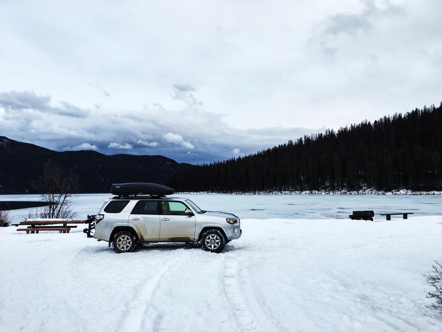

Not quite today...but my favorite thing about this thing is being able to drive up over a snow bank and head to the lake.
