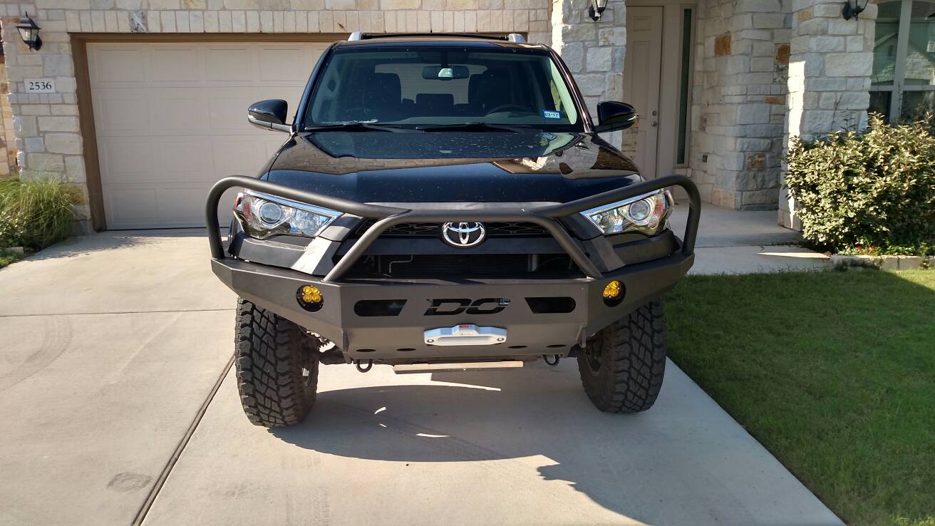

Got this installed last night. It's a work in progress still. Need to wire up the winch still, and some other things.

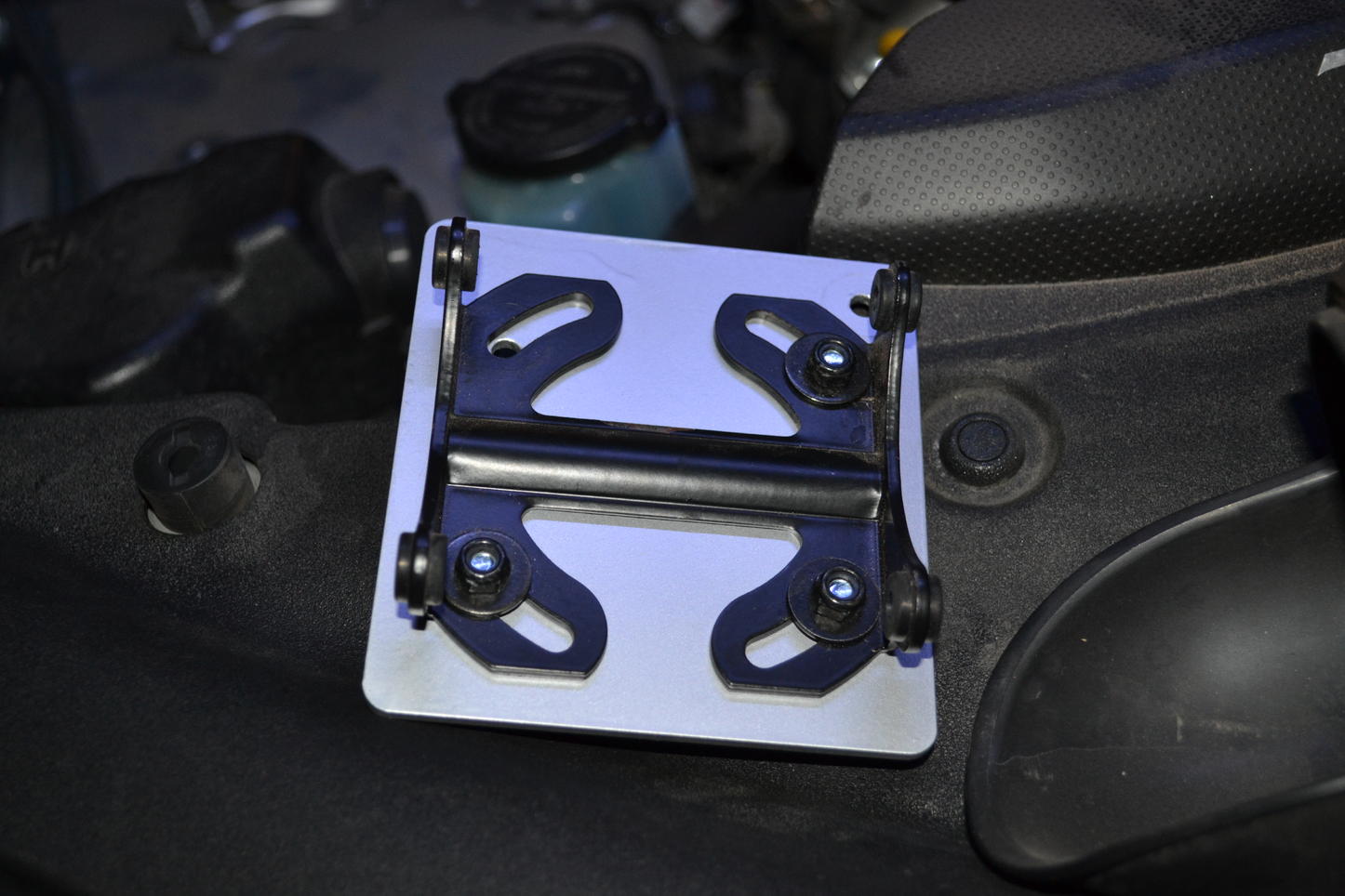

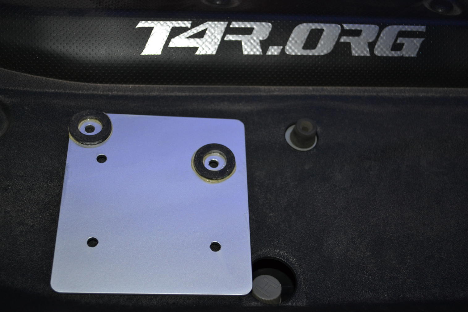

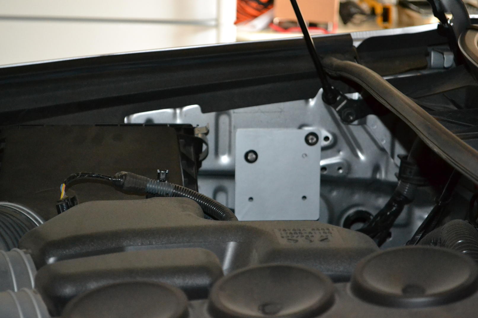

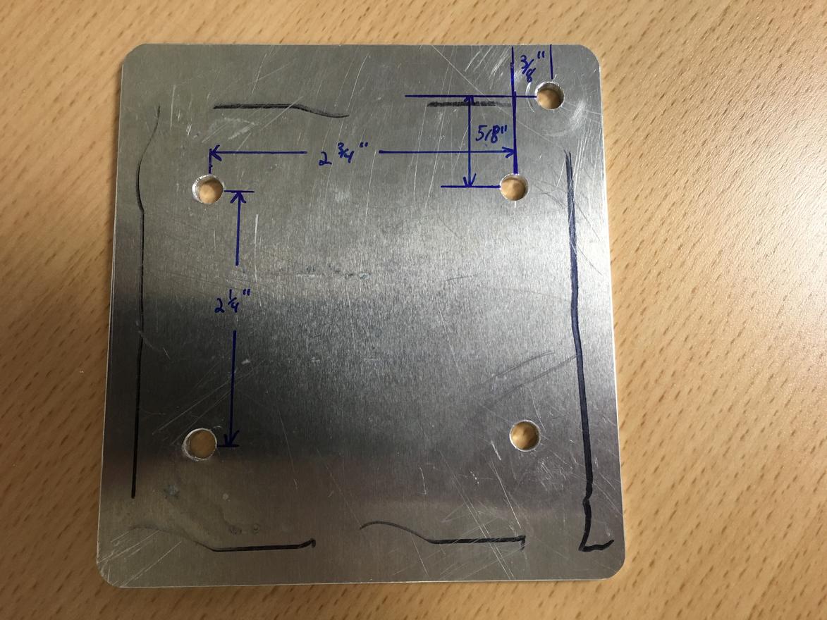

Reinstalled my ARB CKMA12 Compressor
I decided to clean up my install on the compressor. I originally rough cut the adapter plate for a dry fit, but it was installed at that point and we were going on a trip. I've been using it for the past 6 months, but decided to update some pictures since I trimmed the adapter plate and cleaned everything up. I added some rubber washers to the backside to dampen the vibration a bit more. Full write-up in my build thread.

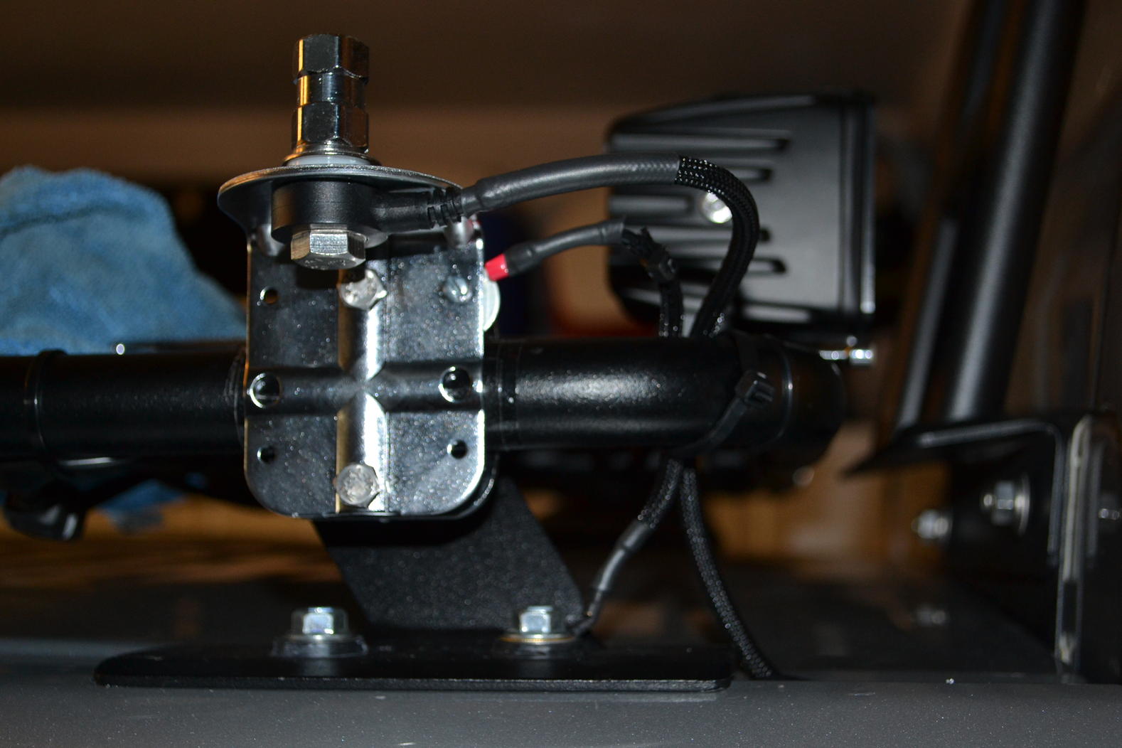

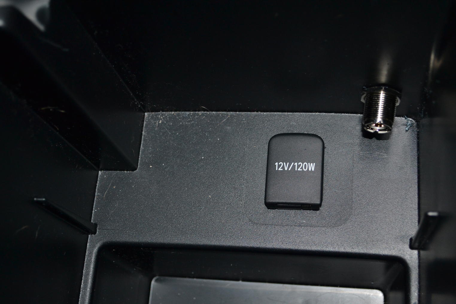

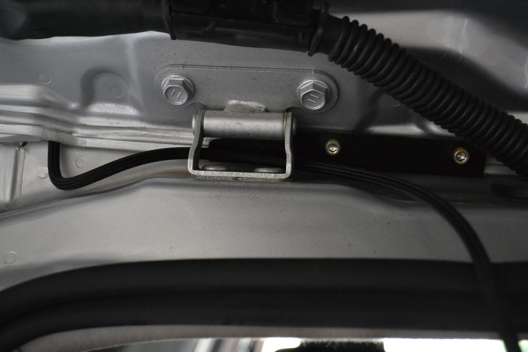

Midland 75-822 CB Intall Write-up
Finally getting around to posting some info on my CB install. I decided to go with the Midland 75-822. I liked the Midland because you can also use it as a hand held unit when on a hike. I like options. Full write-up in my build thread.

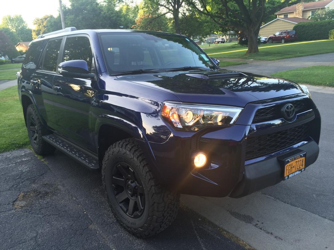

How difficult was it to dip the front bumper trim? Did you tape off the surrounding area and spray, or did you remove the trim piece first?
It wasn't difficult, just more-so time consuming because of the prep work. First I had to remove the plate/holder and clean the area. Then I taped the surrounding grill with 3M painters tape, covered the grill/front hood with newspaper and cardboard - same with the side trim. Sprayed about five/six coats and peeled it all off carefully.
It's not difficult, just time-consuming so dedicate a few hours of your day so you're not rushed!
