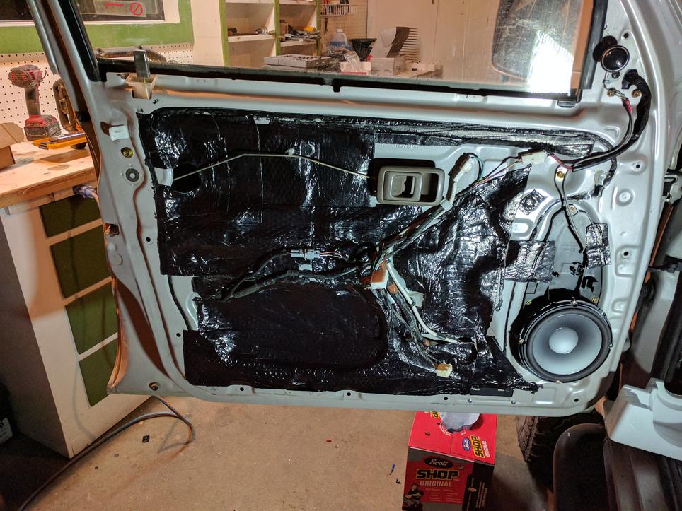

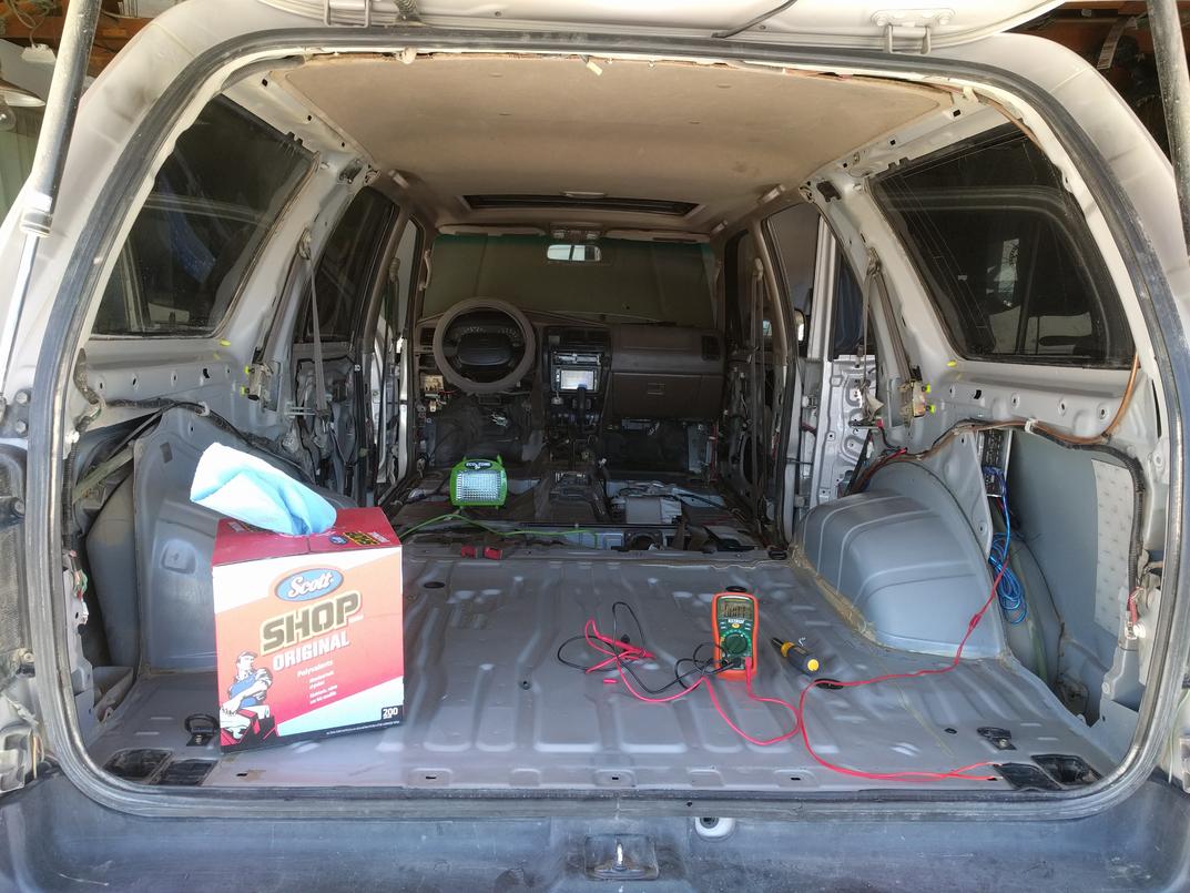

Started the install of sound deadener. Also installed the Infinity 6500CX in the front and Polk DB651 in the rear. The Polks fit using just the ring that comes with the speakers. They clear the window by about 1/8" I had some spacers in there with my old Concepts so I removed those. My rear door panel was all ready trimmed up on the inside so I don't know for sure if the Polks will clear the stock door trim but I think they might.
I managed to get the two driver side doors done in 4 hours including the speakers. This is gonna take longer than I thought. Oh well, guess I'll just have to take Friday off. lol

while your at it, spray some fluid film inside the panels. Just little bit

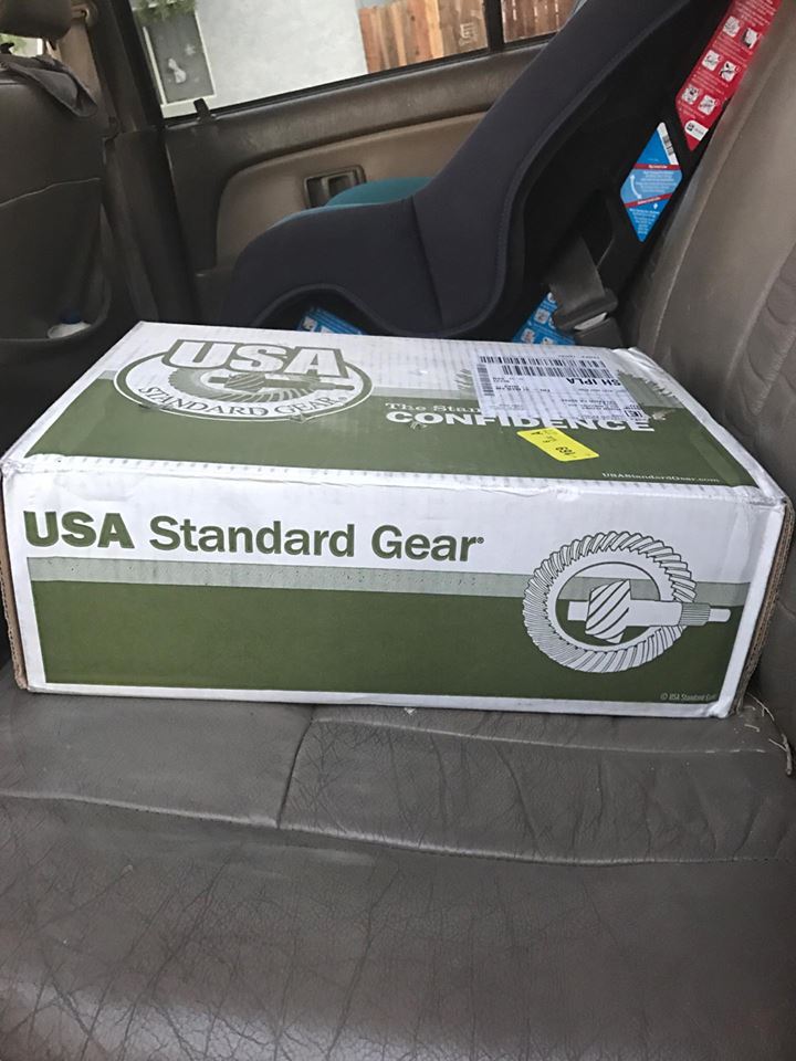

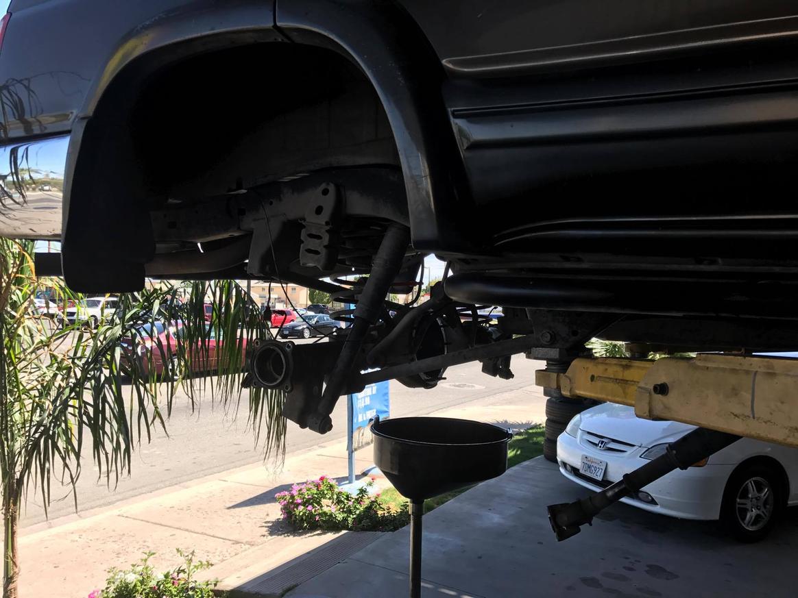

got the rear end re geared to 5.29 and got the wheel bearings and axle seals done since they were leaking. now gotta save up to get the front done. barely picked it up. will post up how i feel with it on such low gearing. i have 285s.

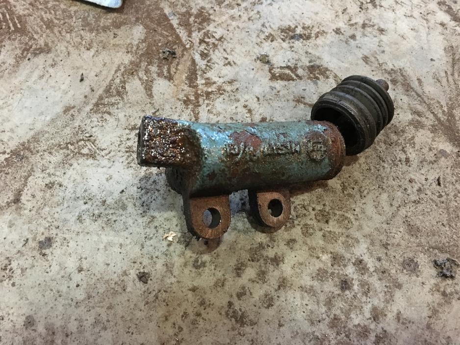

Clutch slave removed
Redoing the whole hydraulic clutch system because there are a couple of small leaks and I think the slave was shot anyways. I removed the master cylinder and rebuilt it and I have a new slave cylinder so all I need to do is get the old lines out then rebuild it.

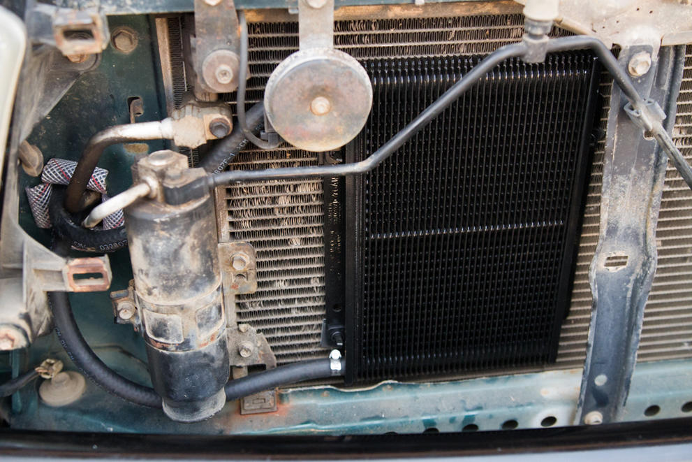

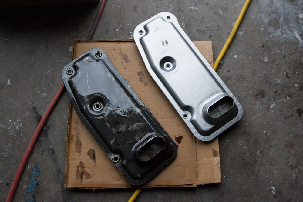

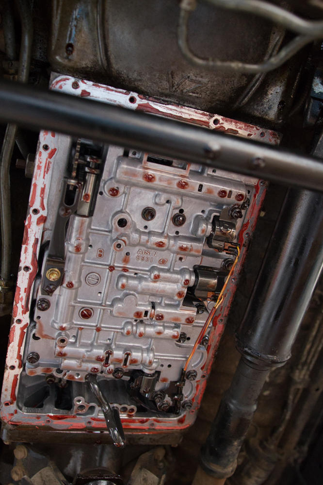

Flushed trans and replaced the filter
Also installed B&M supercooler
