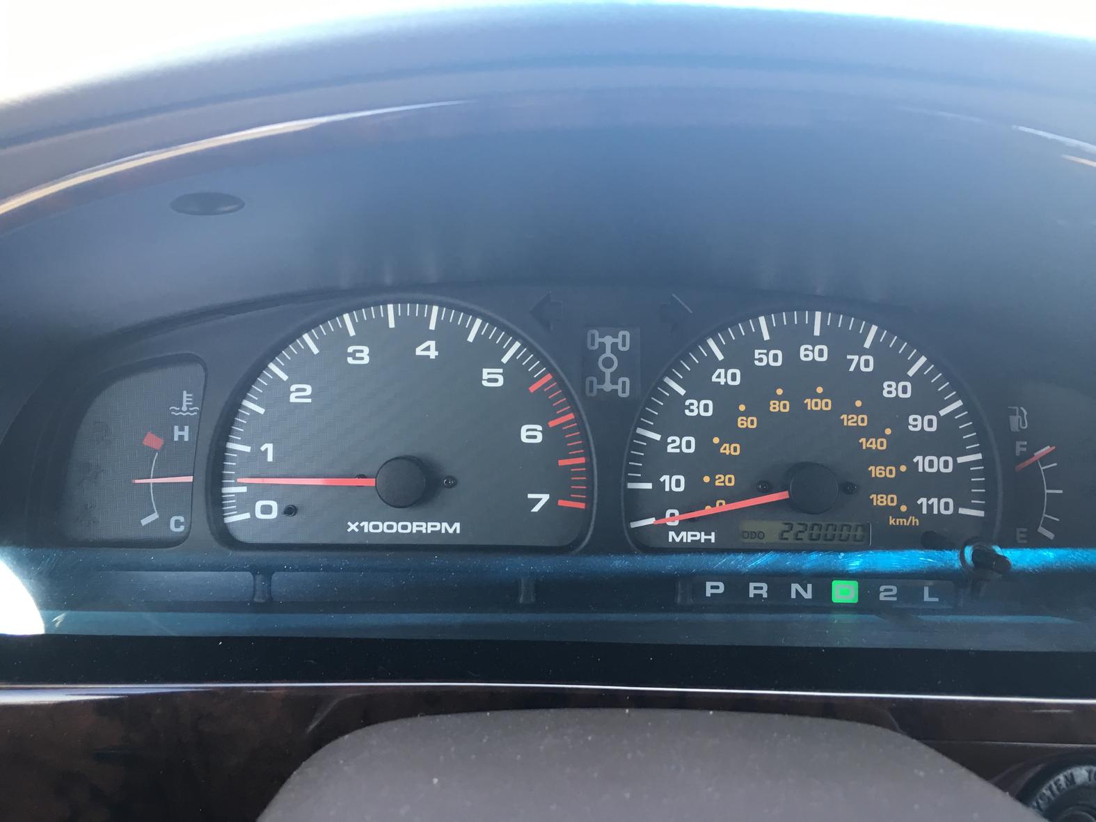

Finally put in new shifter bushings... now my shaky flaccid gear selector is like new. (and I can actually get my key to release 100% of the time when in park!!)
Did you do all 4 or just 2? That was a pain in the but but very very worth it.
I only had a pair of bushings so I ended up just doing the upper pair on the shifter mount. I really didn't feel like crawling under to unbolt the linkage, and didn't have enough bushings even if I did. I observed a lot of play in the next link so they are obviously shot there too.
It tightened up 1000x better than it was- not loose at all and it engages the P sensor every time now. I'm not sure I need to do those??

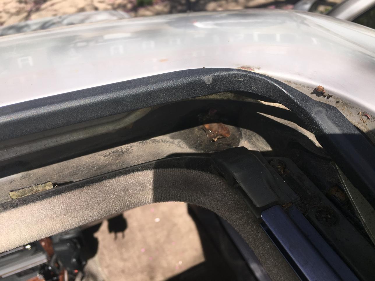

Got in the 4Runner today and didn't hear the familiar sound of water running down the sunroof drains after a hard rain. But I did get a wet lap! Pulled the external and internal wind deflectors and cleaned out the area of all the gunk (I park under a very old, big Red Bud tree).
And I have to say the sunroof is worth every bit of hassle it occasionally creates. I know some prefer not, but I love it! Debating whether to reinstall the external wind deflector...
