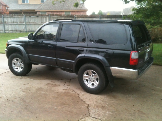

Got my '99 star wheels on. Just in time to have a flat in the rain. Also picked up a decent sports hood insert (rest of hood was toast).
