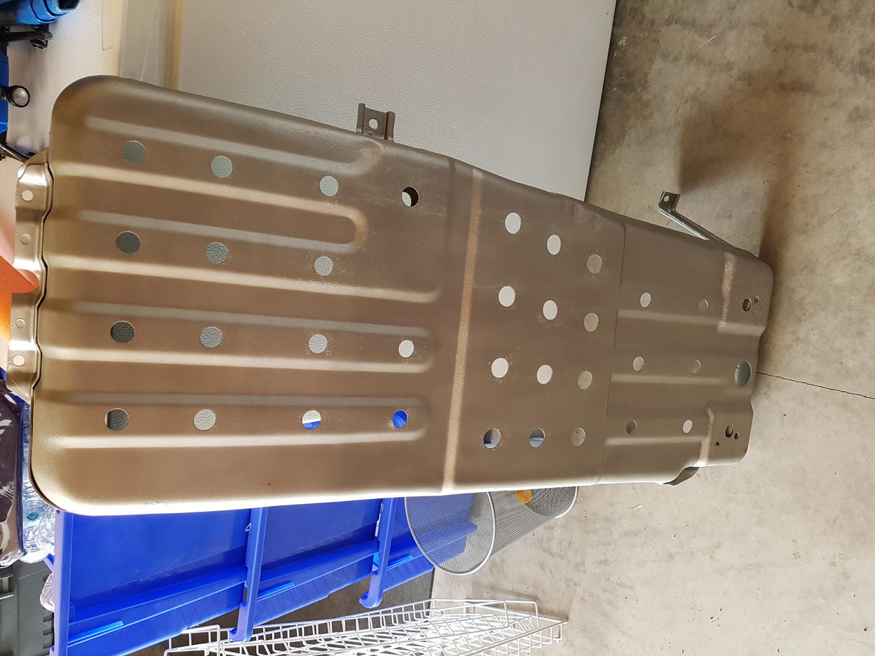

Cleaned the MSG and TB. New OEM PAPER filter (Had a K&N). Removed my stock fuel tank skids, remove the surface that and repainted it.

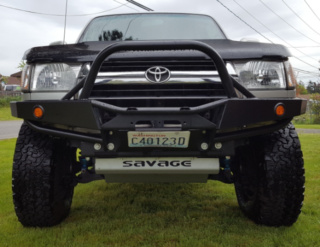

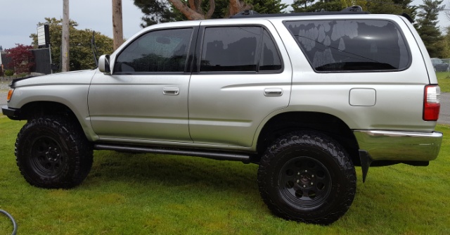

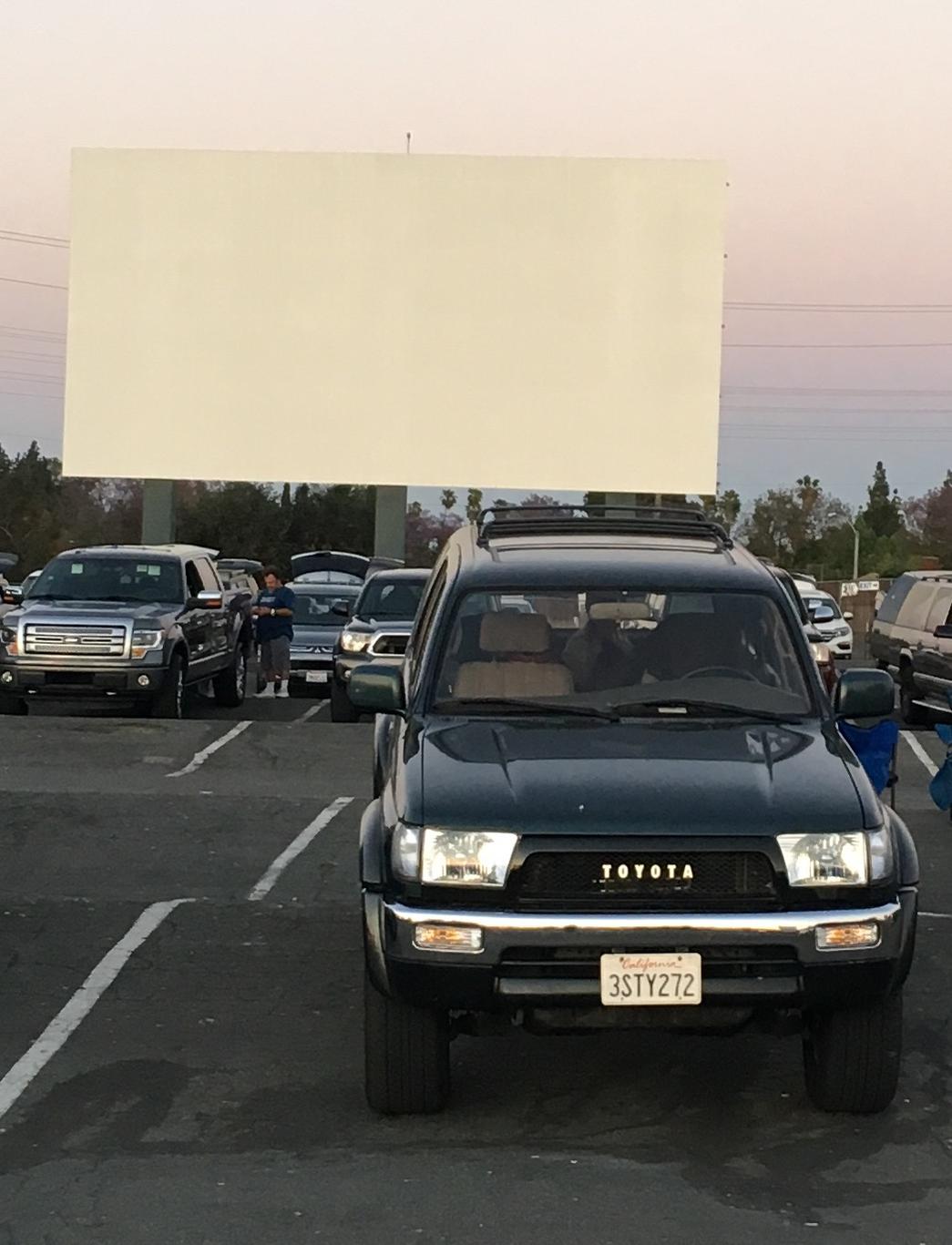

Washed. If the weather holds up I might catch up on some overdue small projects. Pinch welds, extended breather, fuel filter... who knows...
I think I have gotten used to these 285s. Somehow they feel a bit more plush than the same KO2 in the 265/75/16. My finger has been hovering over the buy button for the 4X Innovations rear swing out.

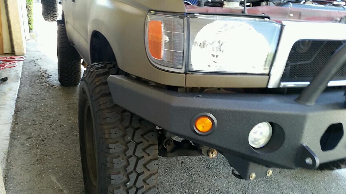

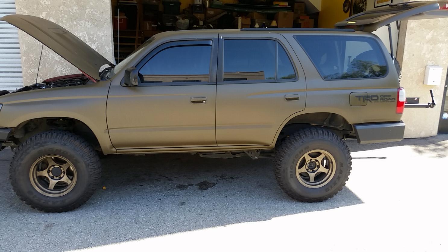

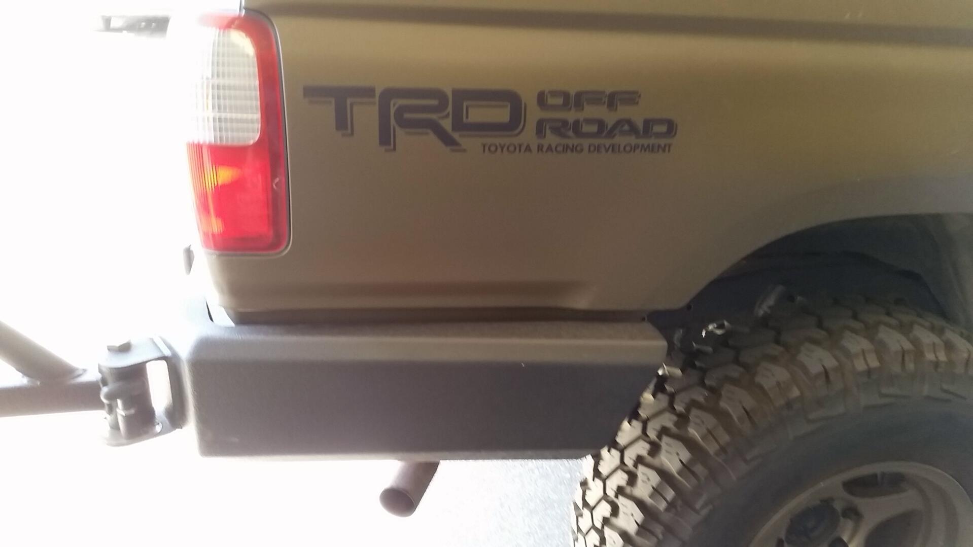

1/2" body lift
Rear 4xinnovations bumper was contacting the pinch welds and had slight rear fender well contact from my 255/85/16 maxxis big horns installed on fn wheels 5 stars so I picked up a 1/2" body lift from 4crawler and popped it in today. Only took about an hour and no change in hardware

I love those color combinations you are rocking! Have you swapped out the rear body mound for Sonoran Steel body mounts? Most people running 4X Innovations rear swing out swap them out to eliminate rear flex with that swing out.

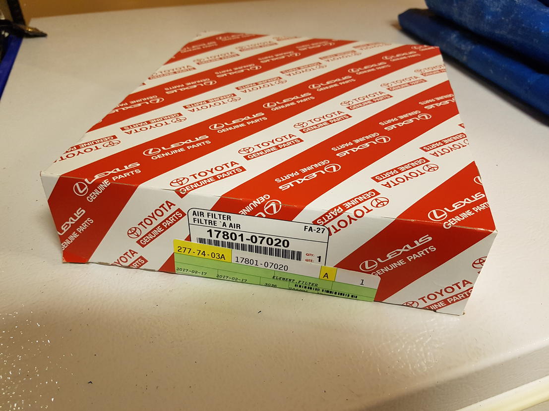

Replaced denso air filter

What color and what paint is that?
