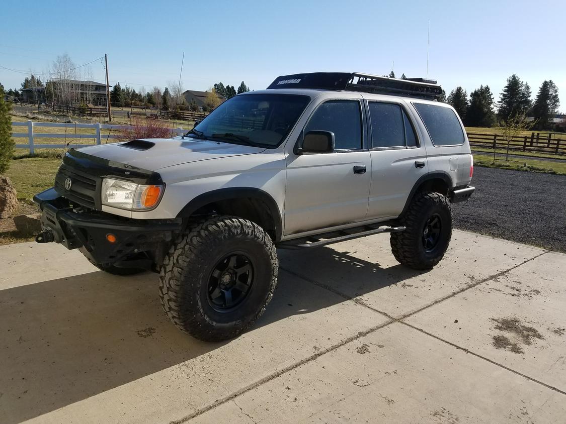

Thanks. T4r Bilstein 5100s with Moog tall springs and 1.5" Daystar spacer in rear, front on second perch. Tires are 265/70r17 Cooper At3. I netted about 2.5"-3" lift all around compared to the worn out stock 167k mile springs.

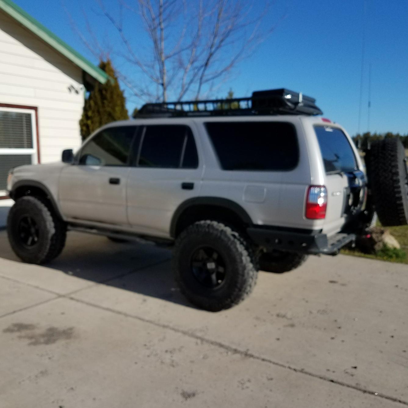

Couple pics. Wheels have 4.1" backspace so I rub the frame a little but I can stuff the 35s up in the back fender. Sorry for the blurry pic.
