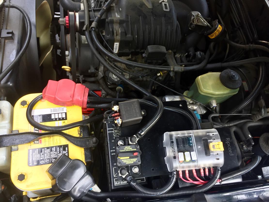

Cleaned up the wiring in the engine bay with Ripcords fuse box mount. Been a long time coming...finally cut all of the stock wiring harnesses that came wi my accessories to appropriate lengths so I don't have a birds nest of wires any more.

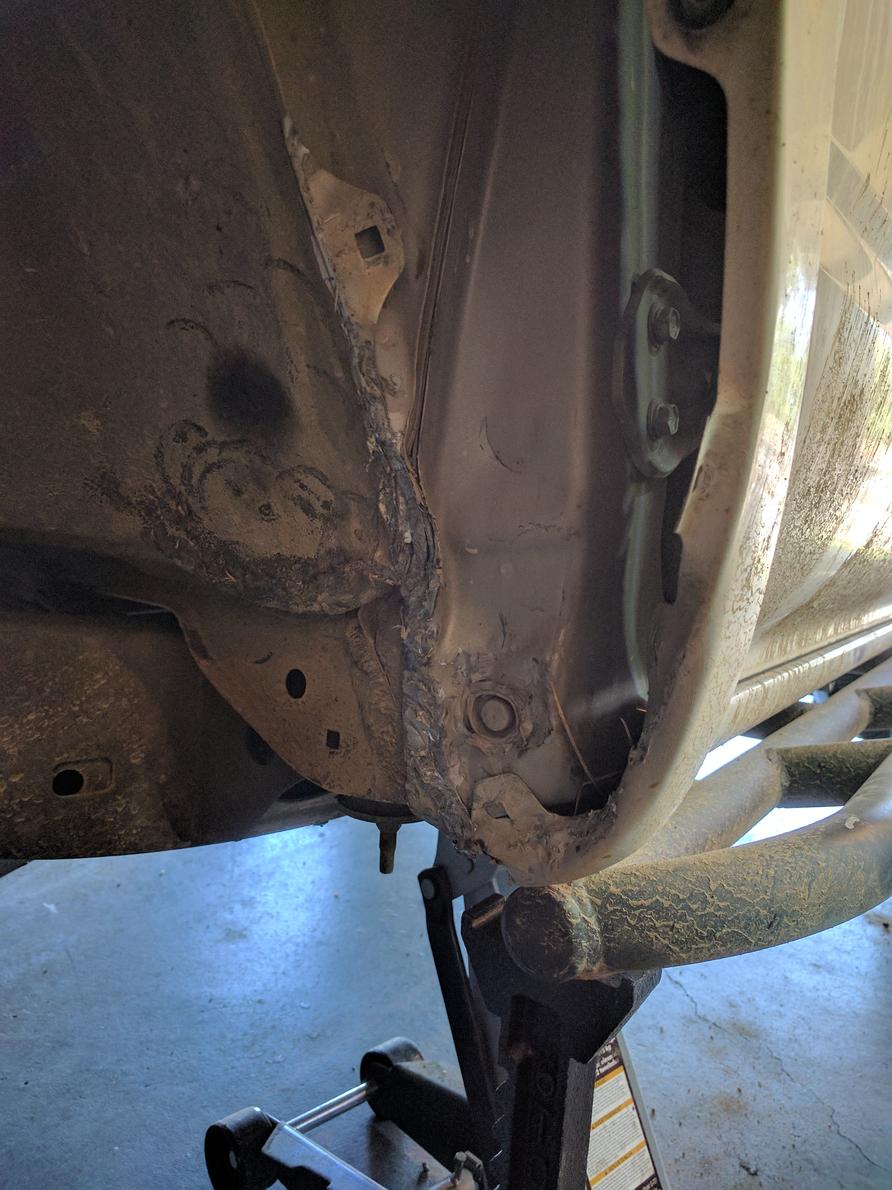

Banging and grinding on some pinch welds. Also installing an ARB compressor. Mounting that thing was a PITA. As usual I forgot the step by step photos but I'll get the finished ones up later.

After beating and beating and grinding and beating I still have a tiny rub at full lock when compressed. Sometime next week it will go to my alignment guy. I'll have him use the SPC control arms to push the caster as far positive as he can. That should gain me some more clearance.

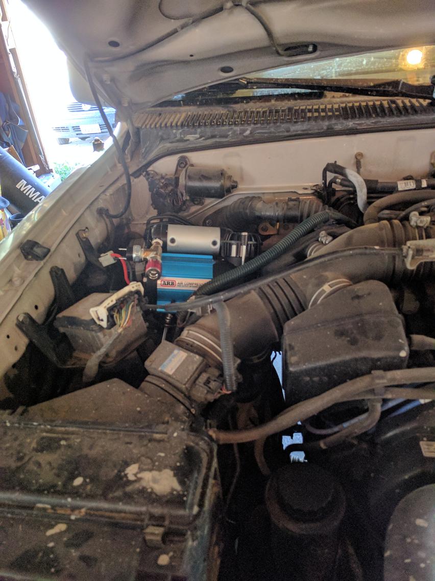

Also got the ARB CKMA12 mounted and wired up. There's plenty of room to mount it in this location without having to move anything. I used 1/4" x 4" panhead bolts to raise the compressor up off the fender well. Then mounted the ARB plate to them. It performs great. I dropped tire to 12 PSI and had it back up to 38 PSI in just over 2 minutes.

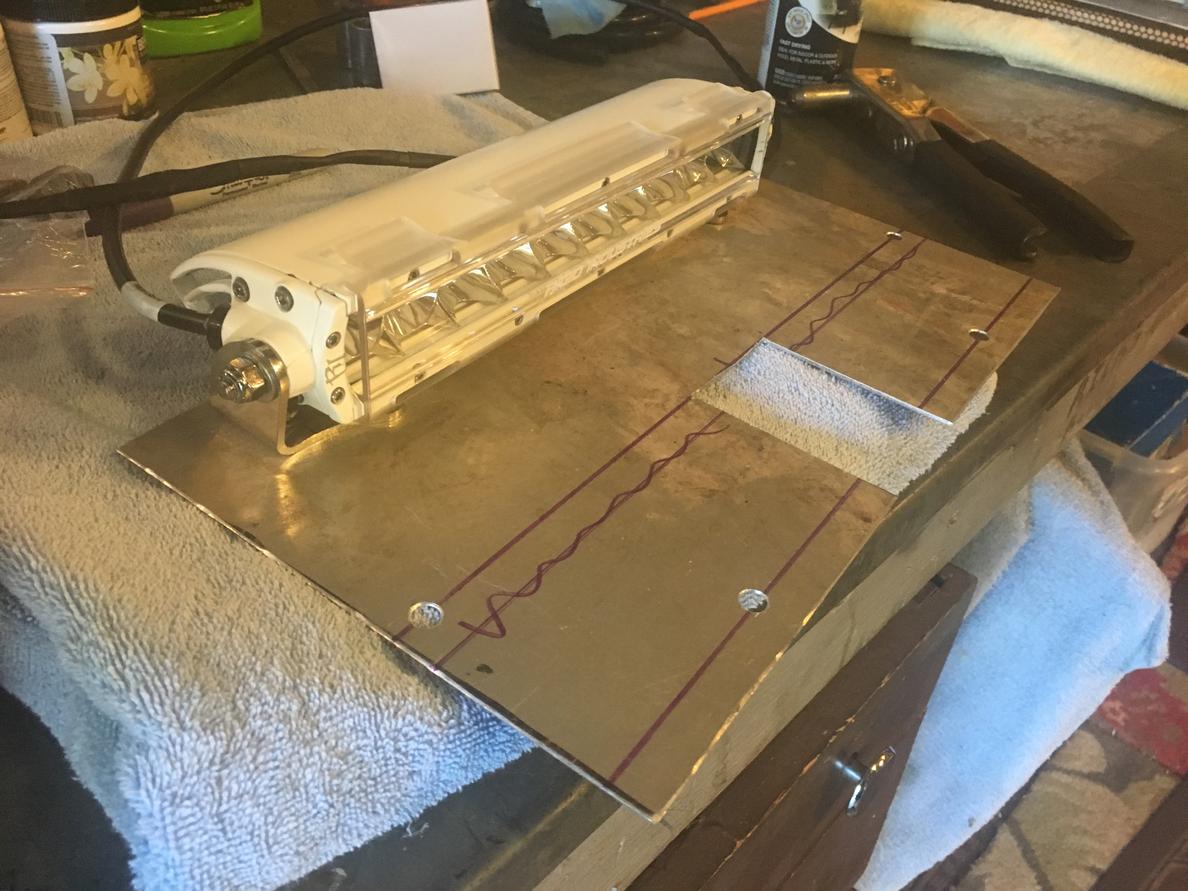

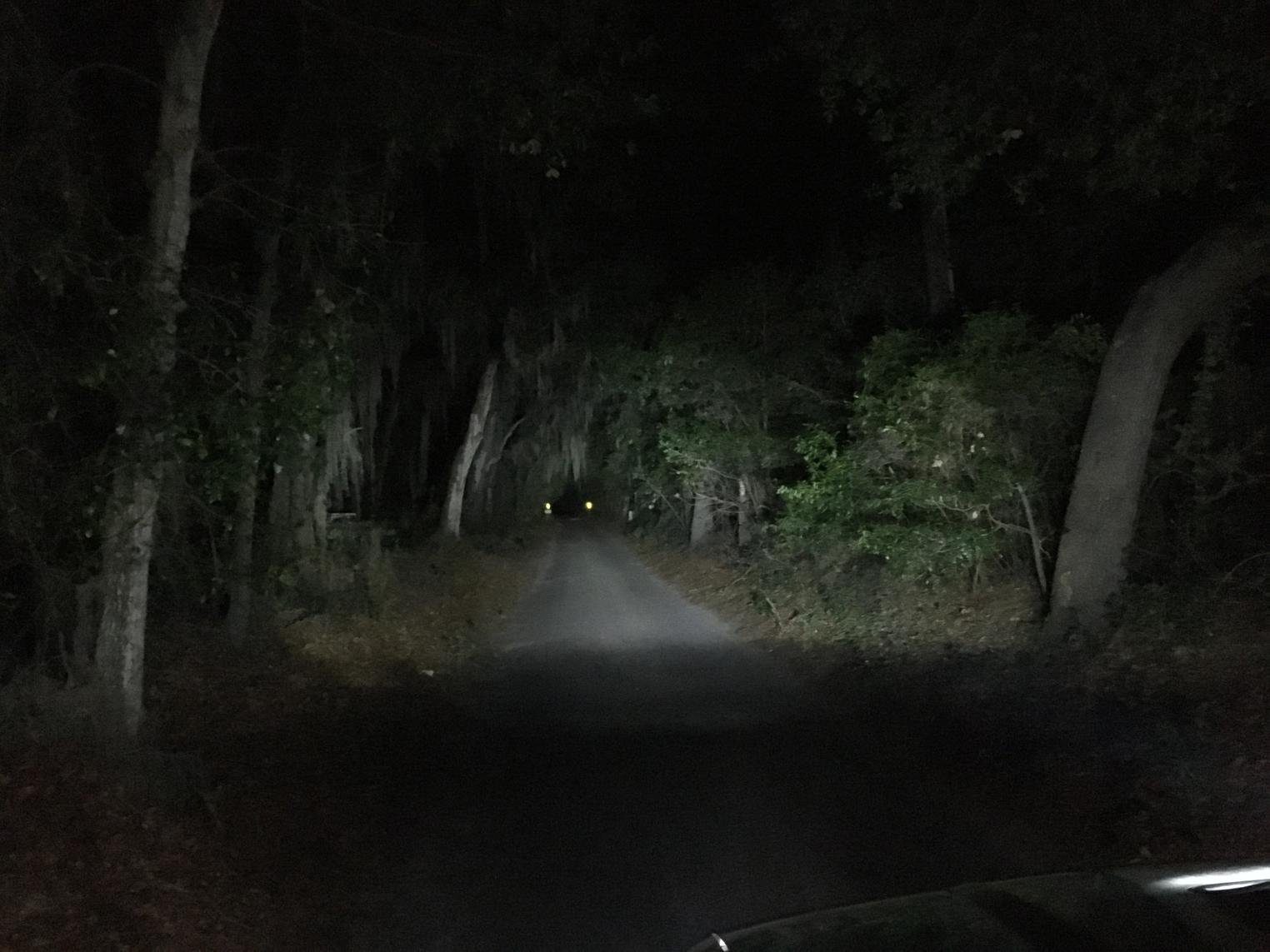

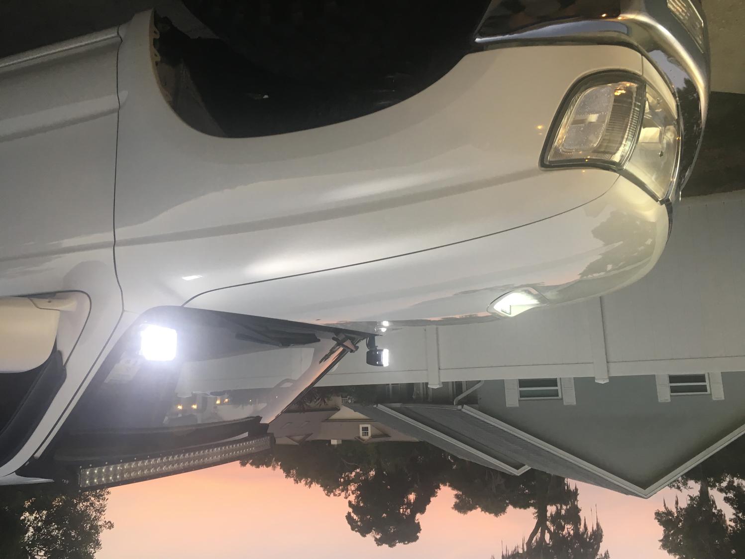

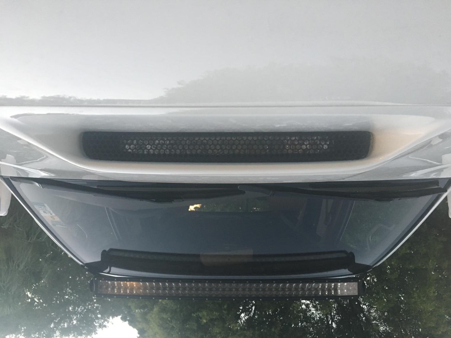

Mounted up a 10" M-SR2 series Spot/ Flood light bar in the hood scoop yesterday.
Made the bracket out of 1/8" aluminum. Going to take it back off and round some of the edges to make it more visually appealing and hit it with some paint. Cant decide to color match it white or just paint it with black engine enamel.
Wired it into the same circuit as my D2 ditch lights and it fills in the center perfectly.

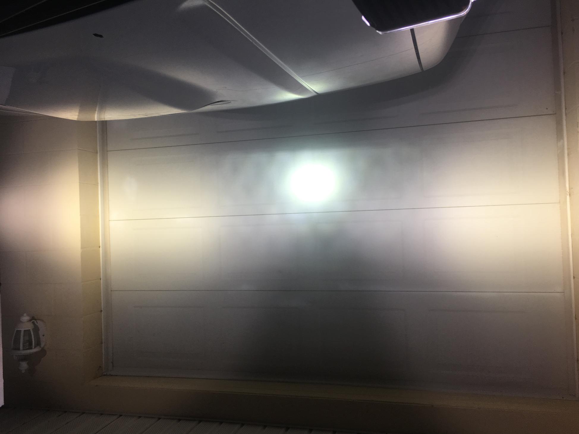

Picture up against the garage door shows the output pattern of the D2s and the light bar.
Last picture is the light bar only on an unlit road in the middle of nowhere.

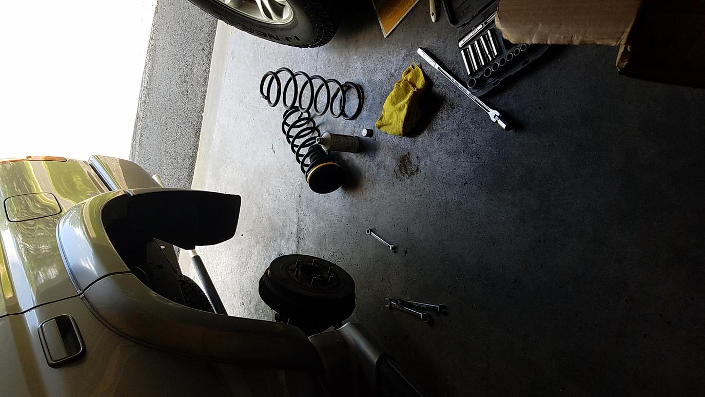

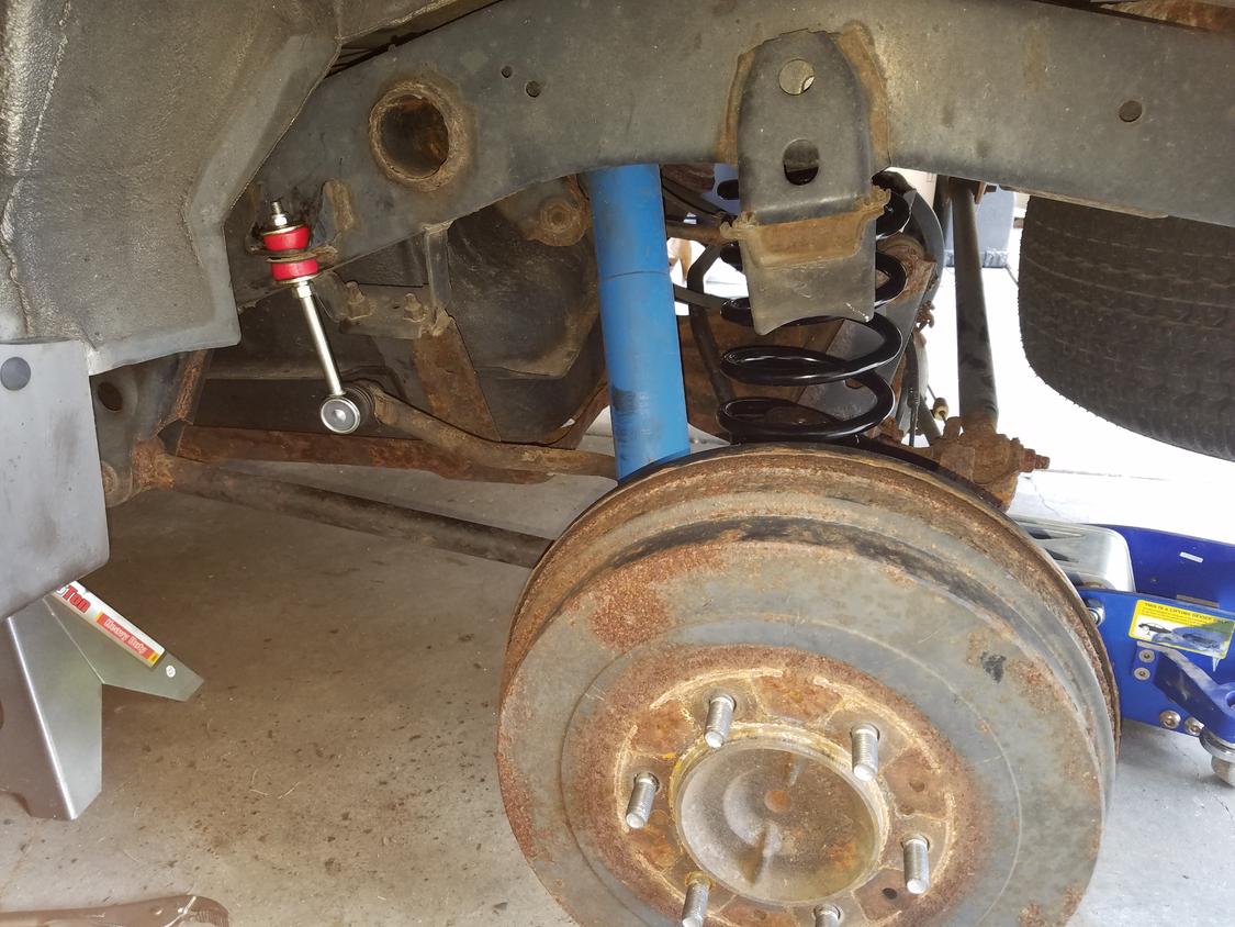

Rear springs and sway bar end links. Added one 10mm OME trim packer to the driver side. Sits about 1/4" lower on driver side with a full gas tank. I'll have to check again when it's empty. If I could do it again, I would get 3 trim packers and use 2 on driver side and one on the passenger. Pro-Forged sway bar links are very nice and substituted energy suspension bushings for the rubber ones it came with.
