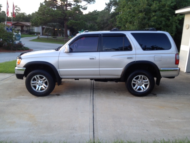

Put all 99 tall springs and shocks on with Daystar 1" spacers a week ago. Took my Daystar spacers off today!!! Wow they made my truck super JITTERY:mad:. Live and learn. I then detailed the s**t out of it. Much better. EDIT: Anybody want to buy some slightly used spacers? HA
