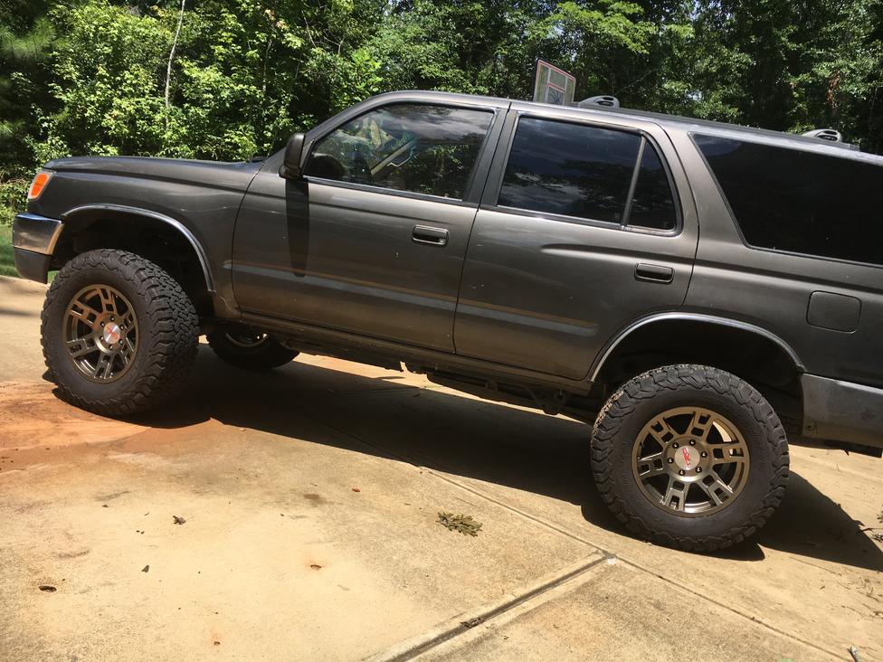

Installed a set of sport flares, and a T4R antenna mount. Also went over the front bumper, tow hitch and plastic rear bumper cover with bed liner.
<a data-flickr-embed="true" href="https://www.flickr.com/photos/152612783@N04/35519624970/in/photostream/" title="20170713_183047"><img src="https://farm5.staticflickr.com/4281/35519624970_5fe0be605d_b.jpg" width="1024" height="576" alt="20170713_183047"></a><script async src="//embedr.flickr.com/assets/client-code.js" charset="utf-8"></script>
<a data-flickr-embed="true" href="https://www.flickr.com/photos/152612783@N04/35098553523/in/photostream/" title="20170713_183000"><img src="https://farm5.staticflickr.com/4322/35098553523_7dbf69719d_b.jpg" width="1024" height="576" alt="20170713_183000"></a><script async src="//embedr.flickr.com/assets/client-code.js" charset="utf-8"></script>
Hey nice looking rig whats lift kit you got and whats the tires size? Thanks

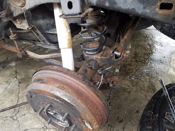

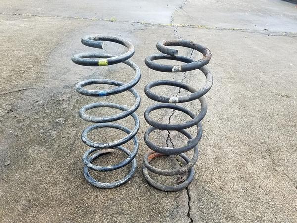

Today I replaced my factory 1996 coil springs with a set of 2002 springs that I purchased from [MENTION=158595]xxJAMxx[/MENTION]
I attempted to change them out yesterday and things did not go well. I failed miserably and called it a night. This morning the weather was really nice with a cool breeze so I decided to try again after rethinking the problem. I used the stock jack, 2x 3ton jack stands, wheel chocks and 3 wheels on the ground at all times on a not so level driveway (dont tell tim), and I was never under the vehicle at any time.
Thanks to xxJAMxx, I no longer have the dreaded "sag" and the springs raised my vehicle 1 inch. I no longer bottom out on speed bumps or potholes. He even included the frame bump stops and a set of 3 inch spacers! Your old 2002 springs are now living de island life xxJAMxx.
I would also like to give credit to my future wife who showed up on my doorstep for a surprise visit to the island a couple of weeks ago without telling me. She saw that I ordered some springs and smuggled them in her luggage so I wouldn't have to pay import fees.
My original spring on the right and the replacements on the left.
The ride feels 100x better now.
