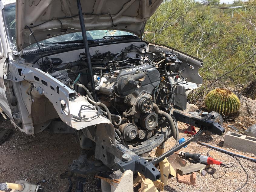

I sawzalled the front off to pull the motor and trans/tc. This is my first engine pull ever. I'm going to clean and refurb this motor for a spare. Anyone know if I can keep it all as one(engine, trans, tc) or if has to be split for certain reasons that I'm not seeing? I'll split at the trans. But just asking. Thanks
Just keep sawzaliing away and you can just leave the motor any trans there.:p
