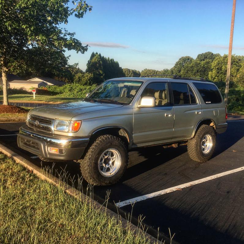

Threw on some Level 8 Strike Six wheels with 265/75/16 Treadwright Claws (cause I'm cheap like that :becky:)
