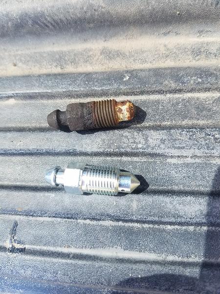

Replaced the Rear bleeders....

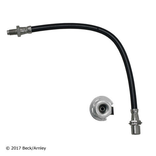

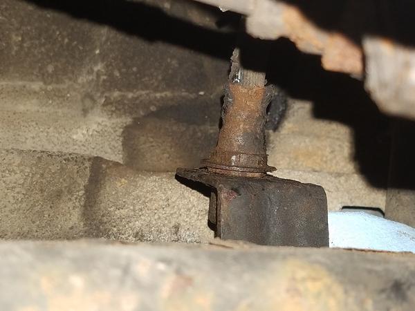

Attempted to replace the rear brake hose above the differential. That metal clip holding the upper portion in place is fighting me tooth and nail. I tried prying at it with a screwdriver and some leverage and the lip just bends. I had to stop for the rain, might start back at it again tomorrow.
This thing.... This picture stolen from google image search has a different clip but you get the idea.
Did a simple fab up for a restraining plate to go under the battery. This plate with the factory battery hold down will keep the battery firmly in place for now. Also installed an iBolt tablet mount for navigation/ camera use later.
That clip is a son of a ***** it took me a while, but I cant remember exactly how I did it. Pretty sure it involved finding the perfect length screwdriver.
Yeah it is! My screwdriver options are pretty limited at the moment. I have a rusted wood chisel somewhere. There is no room to drive a hammer. I think I will try some small channel locks next. If that doesn't work, I may have to try and "bypass" that section.

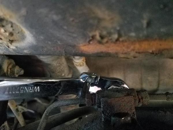

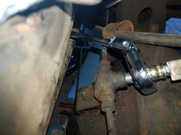

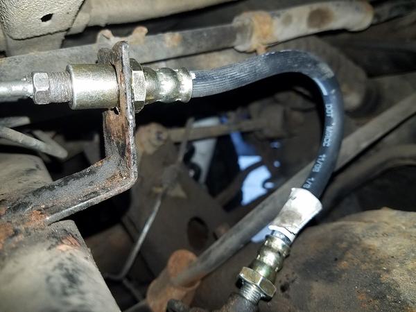

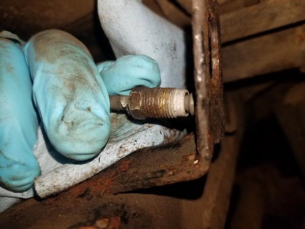

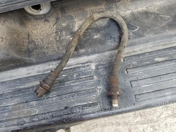

Rear Brake Hose Round 2
I found my small channel locks and pulled that retaining clip off in 2 seconds. Kicking myself for
not doing it yesterday.
Even with a tiny brake line flare wrench, I was barely able to get 1/6 of a turn in that tight space.
It took me like 30min just to undo the upper portion of the line.
I was surprised how easy it was to undo the lower portion. It was only hand tight and not seized.
It was a nice confidence boost. Got the line removed. It needed to be replaced, badly.
When installing the new line, I found it impossible to get a 17mm wrench in a position that would allow tightening.
It then occurred to me that both ends are 17mm. I 'threaded' a gear wrench onto the hose and it made really quick work to snug it down.
Not too tight, just a bit, and I put antiseize on the threads.
1st bit of bad news. The replacement hose is 2inches shorter than the old one.
I purposely left the retainer clip off in order to give the line a little more slack.
I think my cheapest option is to buy a second hose and just extend it.
At this point I felt pretty good about the job thus far. Bleeding the brakes is all that remained.
I used a promotive power bleeder and was able to put 20psi holding. The passenger side rear caliper bled no problem.
The driver side caliper refused to cooperate. I took the bleeder completely out, still no fluid.
I pumped the brake a couple times, nothing. So I cracked loose the hard line on the driver side and tons of fluid was pouring out.
I took the drum off and tried hammering on the caliper to dislodge whatever was blocking it, nothing. I scraped around inside with a pick.
At this point replacing the caliper seems like the best option. So I tightened all the lines up.
Noticed the driver side line is leaking on the Hex-head side of the fitting. No amount of tightening will make it stop.
Its a slow leak, I just dont know how slow yet. Im hoping it will not drain the MC during the 2 weeks that I am gone.
Has anyone had good luck with those autopart store generic rear calipers?
How do I fix the line? Replace? Cut a tiny piece off and learn how to flare with the same fitting?
So yeah, I did all that work only to find some new old problems that were probably already there. Isn't that what Sundays are for?
