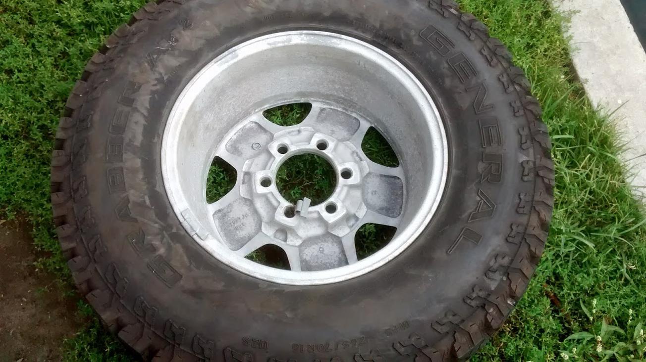

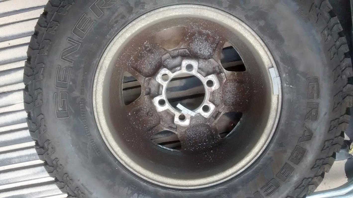

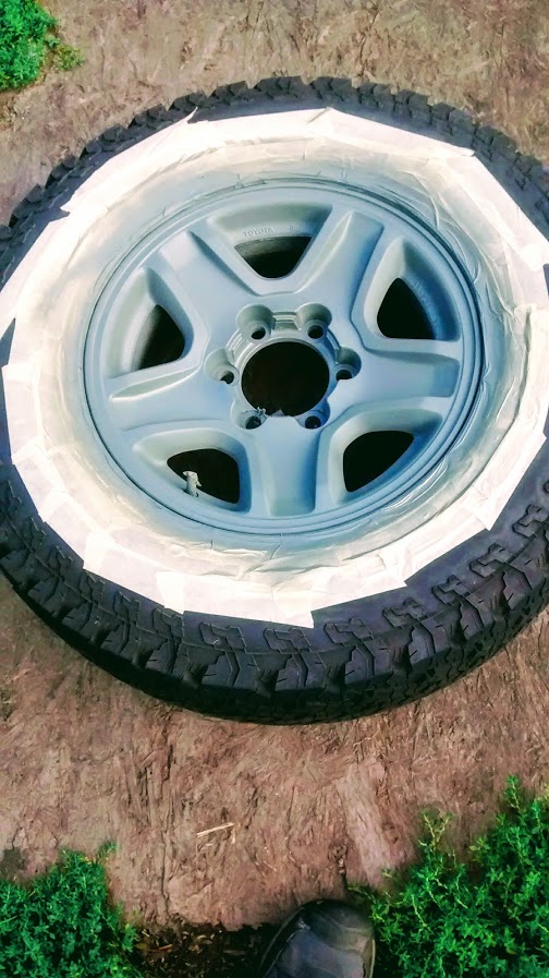

now that the new wheels and tires are on I have been tackling the corrosion on the stock rims. After 17 years on the road they needed a little help. I used a angle grinder and a sandblaster from harbor freight. I just sand blast on the back side. and mostly scochbrite pads on the front so now i just have to sand out the back side of three more and the priming is done. i am going to use a copper metalic plasti dip on the fronts and some black enamel on the back side.

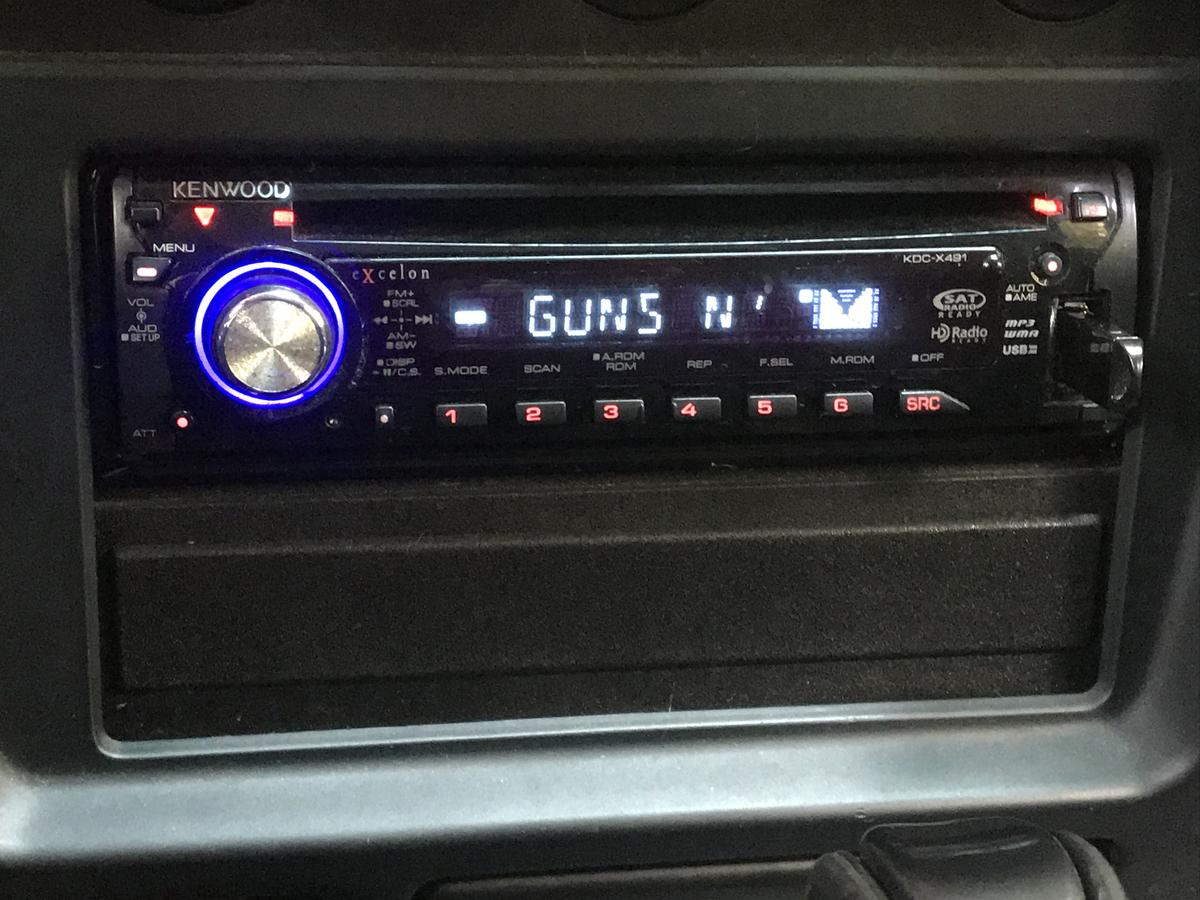

New stero
Nothing special other than its perfect, no cutting fit for
the easy install.
