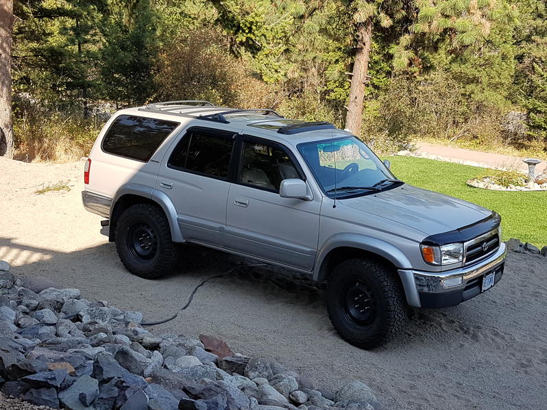

Finished installing wheel spacers
And pulled the running boards off my sons 2005 Sport. Before:
After:

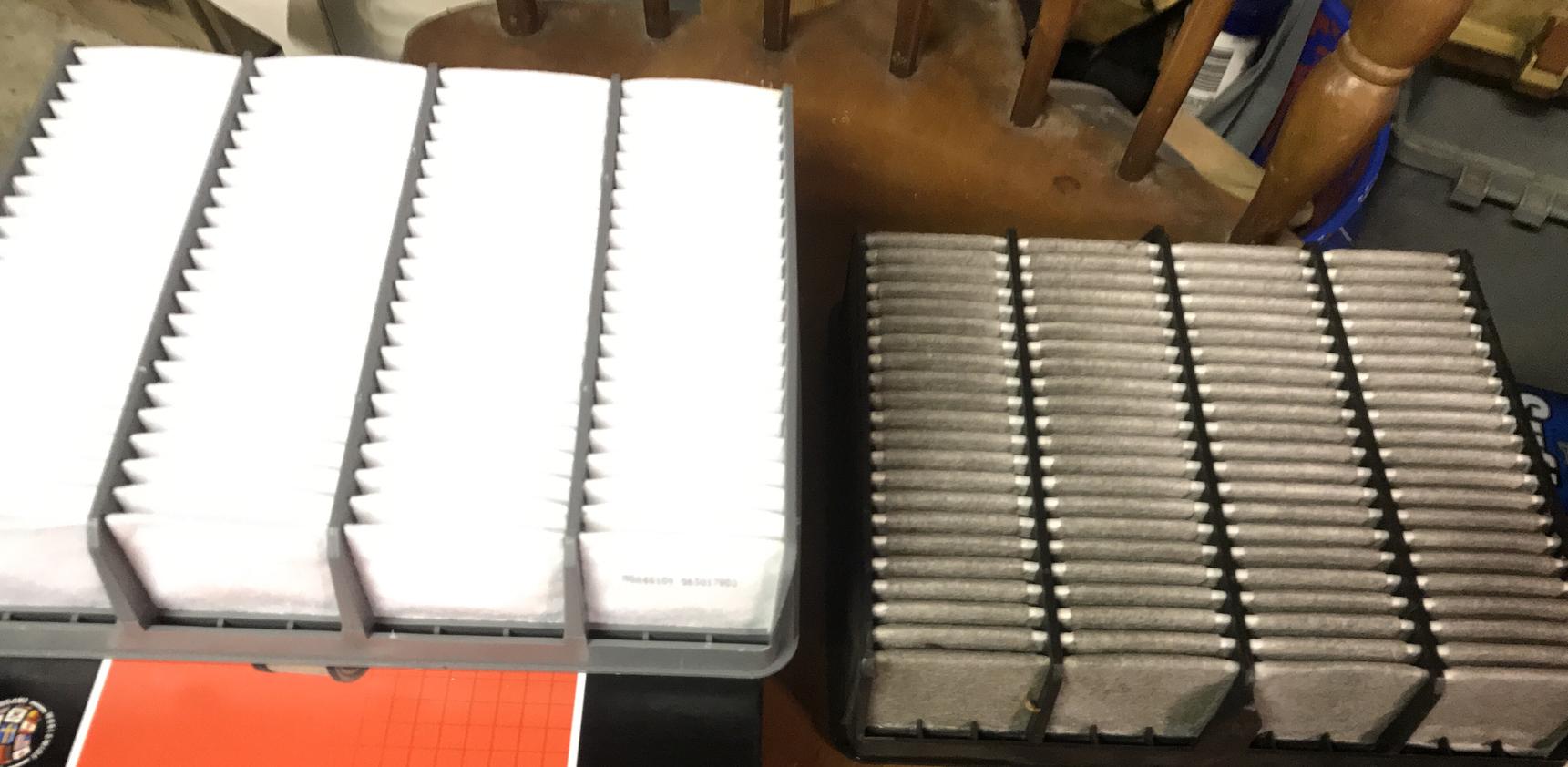

A dirty filter replaced
Yikes. Maybe not as bad as the one here w/ a family of
squirrels living in it but not so good either.

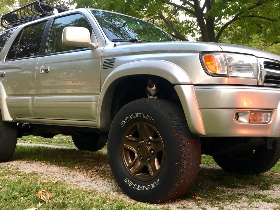

Installed the new kitty upgrade overnight
Came out first thing this morning to find someone trying to homestead my wheel well. "That's one nice f()$&*%# kitty" -Bubbles

Nice rims. Care to share how you colored them?

Thanks. I really just spray painted them to see if I would actually like the color before committing to having them powder coated (they were also looking pretty bad beforehand, so it was a pretty low risk move). Anyway, I used isopropyl alcohol to clean them thoroughly, followed by some 320 grit sandpaper to get the major grooves smoothed out; more isopropyl, masking (lots of masking, don't rush this step), then three coats of Rustoleum metallic primer + paint in "Rustic Mist" color, and finished with two coats of Rustoleum crystal clear enamel. I recently had to re-mask and touch up a little blemish that I picked up from a stray rock on the highway, but even the coverup is pretty much undetectable. Overall I'm a fan, and it was surprisingly easy if you're patient with it.

Right on!
Are you gonna powder coat them or run em as is?
