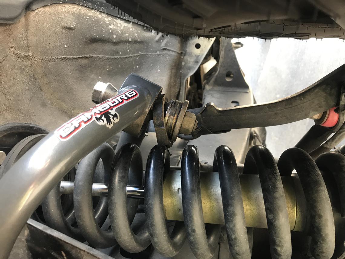

This is what happened today :cry2: (if anyone could tell me how to flip a pic that would be great)

It looks like the spindle to me and if so it's going to be expensive. Especially at a dealer.. ouch. You should look at buying beefed up spindle braces.
I'm not sure if it was the snap ring that failed or that big metal ring on the spindle. But either way I'm getting a new snap ring and UCA spindle adapter, taking it over to the dealership to get it fixed
Could possibly just upgrade to uniball. Should eliminate both possibilities, due to the way it sandwiches the spindle with a bolt and washer.
Edit: that looks like a uniball already and the lip that rides on top of the spindle sheared off. I'd call camburg if that's theirs.

Can you provide some back story to 'what' happened prior? I would be curious as I know some people who run them with zero problems and they are not nice to the trucks :)

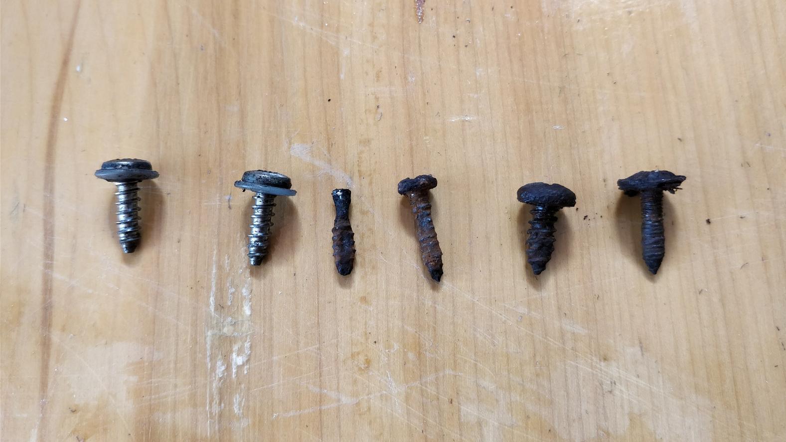

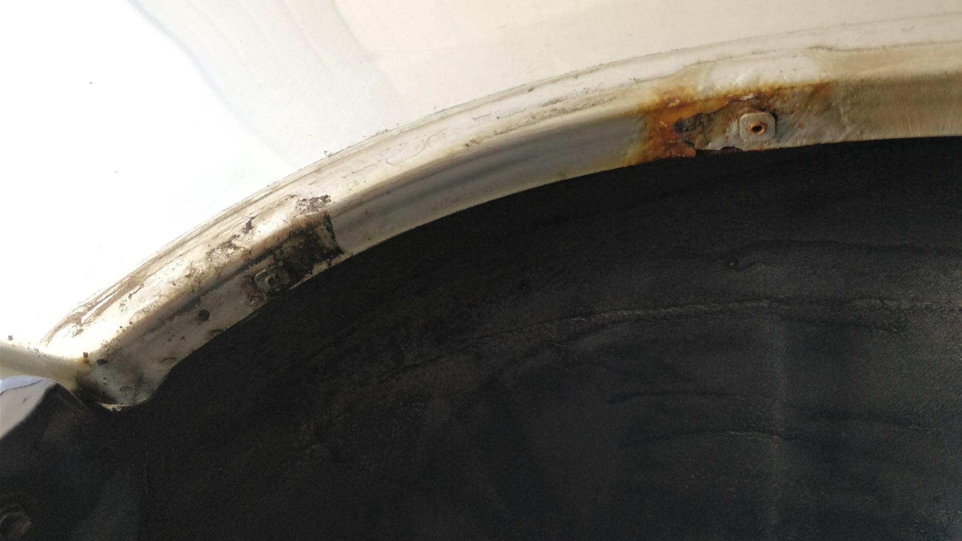

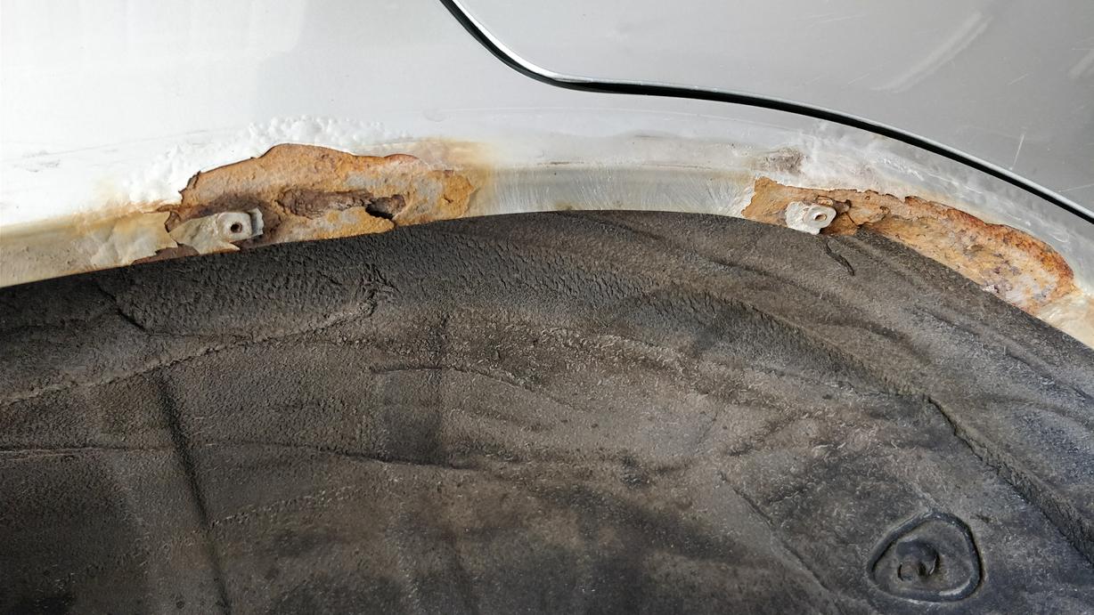

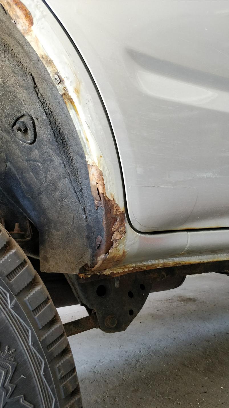

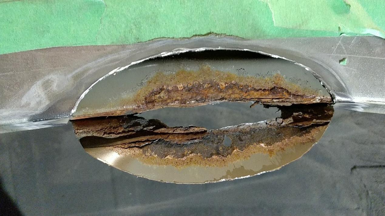

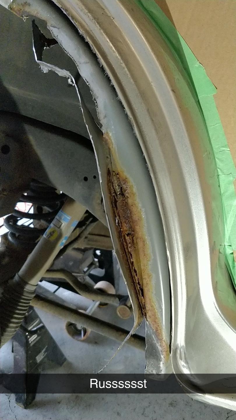

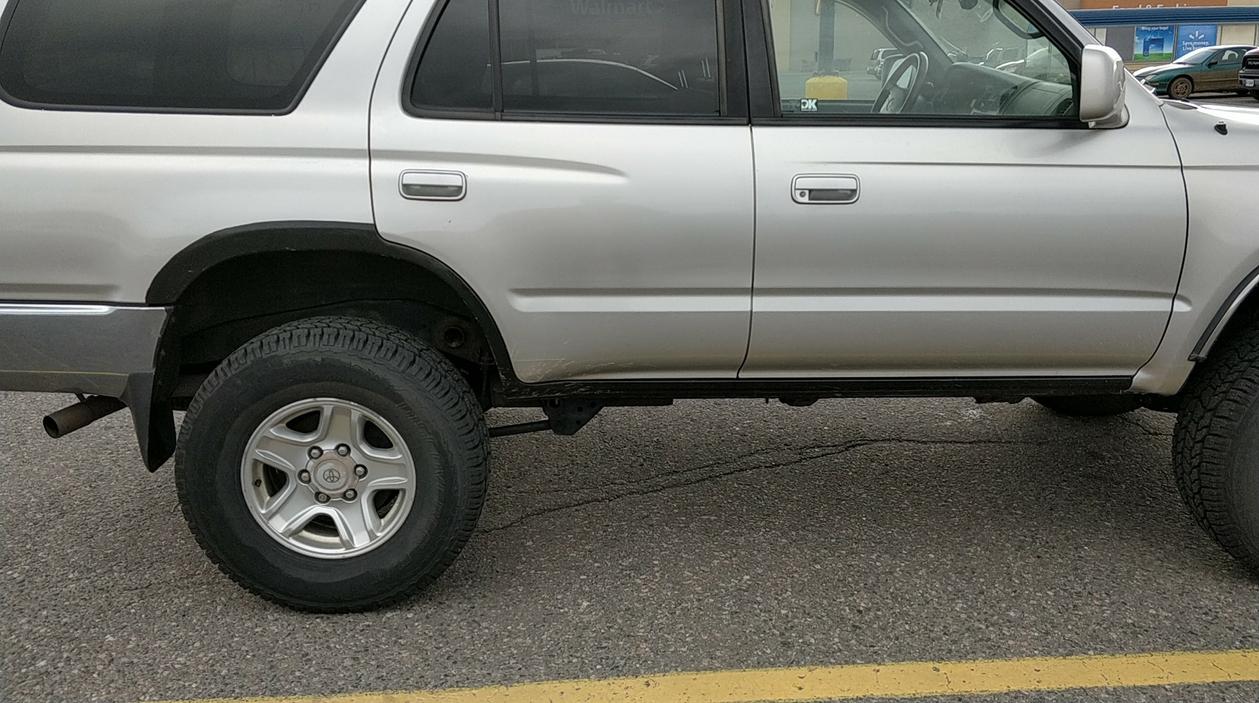

Decided to *finally* take the running boards off and found a ton of rust on the dog legs and some idiotic s**t the PO did that probably caused most of it. He must've taken the rear fender flares off at some point, lost the screws, and replaced them with whatever kinda-sorta fit.
So, having never done body work before and needing to drive 2200km in 2 weeks, I started cutting... I'm an idiot that loves his truck too much. Thankfully I only did one side. I'll get to the other eventually.
I cut out all the rust, cleaned up everything I could by hand, air die grinder, glass blasting. Then painted the insides with rust converting primer(Corroseal), and Weld-Thru primer where I was going to weld. The dog leg I ordered from Wolf Steel over in Quebec didn't fit worth a s**t; so I beat the crap out of it till it fit. Welded that in and applied Bondo Glass and Bondo Hair. After that was smooth enough(I was losing my patience), I taped off where I would paint, prepared the surface and lather on three layers of Chassis Saver. I used Chassis saver cause I didn't have time to paint it properly, but still wanted good rust protection. It turned out better than expected, I'm pretty happy with it.
Nice. Just a question, how did you weld the bodywork without burning through the thin metal?
You have to stick to quick spot welds and jump from one side to the other. Lots of practice definitely helps.
Wasn't a failure on camburgs part, that part of the spindle is factory and sheared off for some reason.
