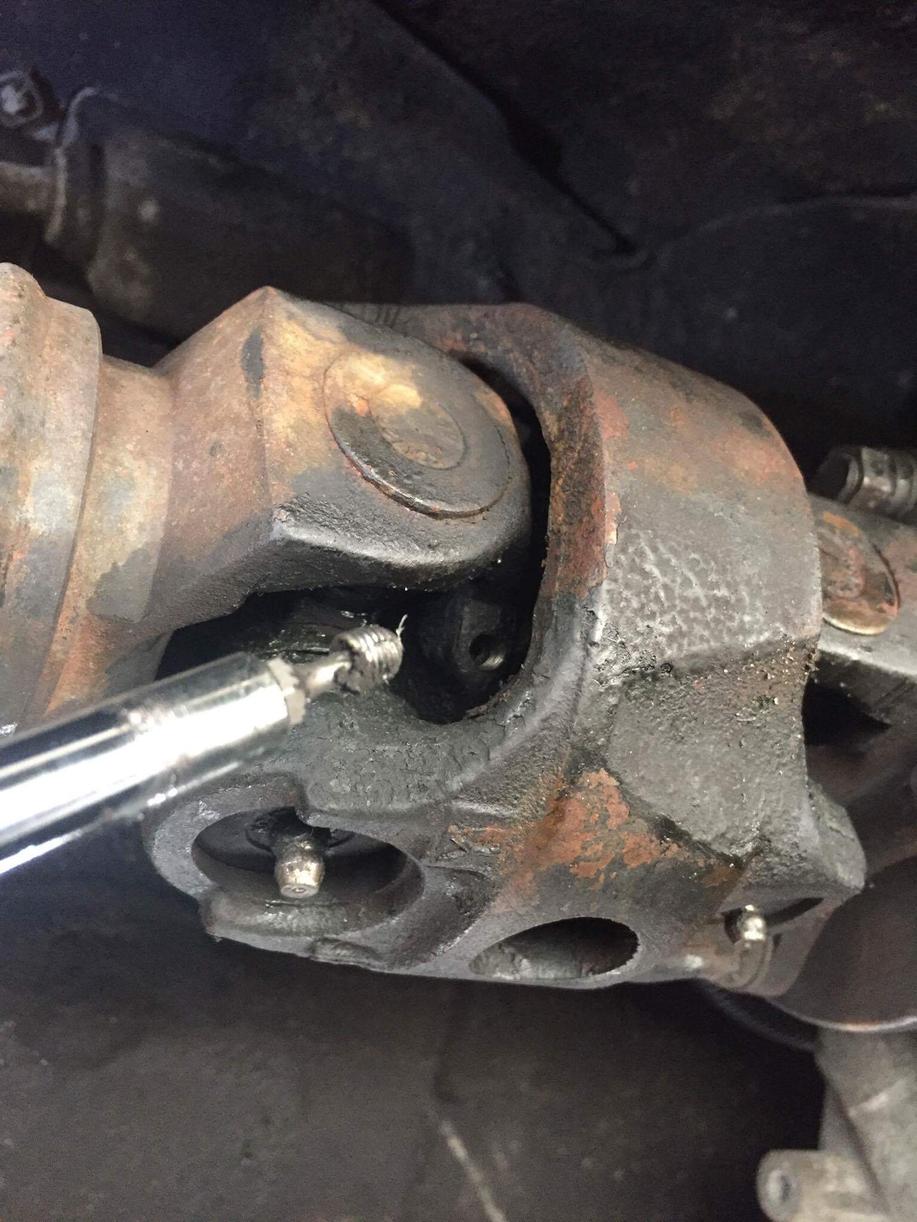

Pulled the rear driveshaft and replaced this little gem...tried everything I could think to try to get the right angle without pulling the driveshaft and probably spent more time doing that than it actually took me to do it this way. Regardless, all is right in driveshaft grease land now and I can sleep soundly knowing my driveshaft bolts have been retorqued.
