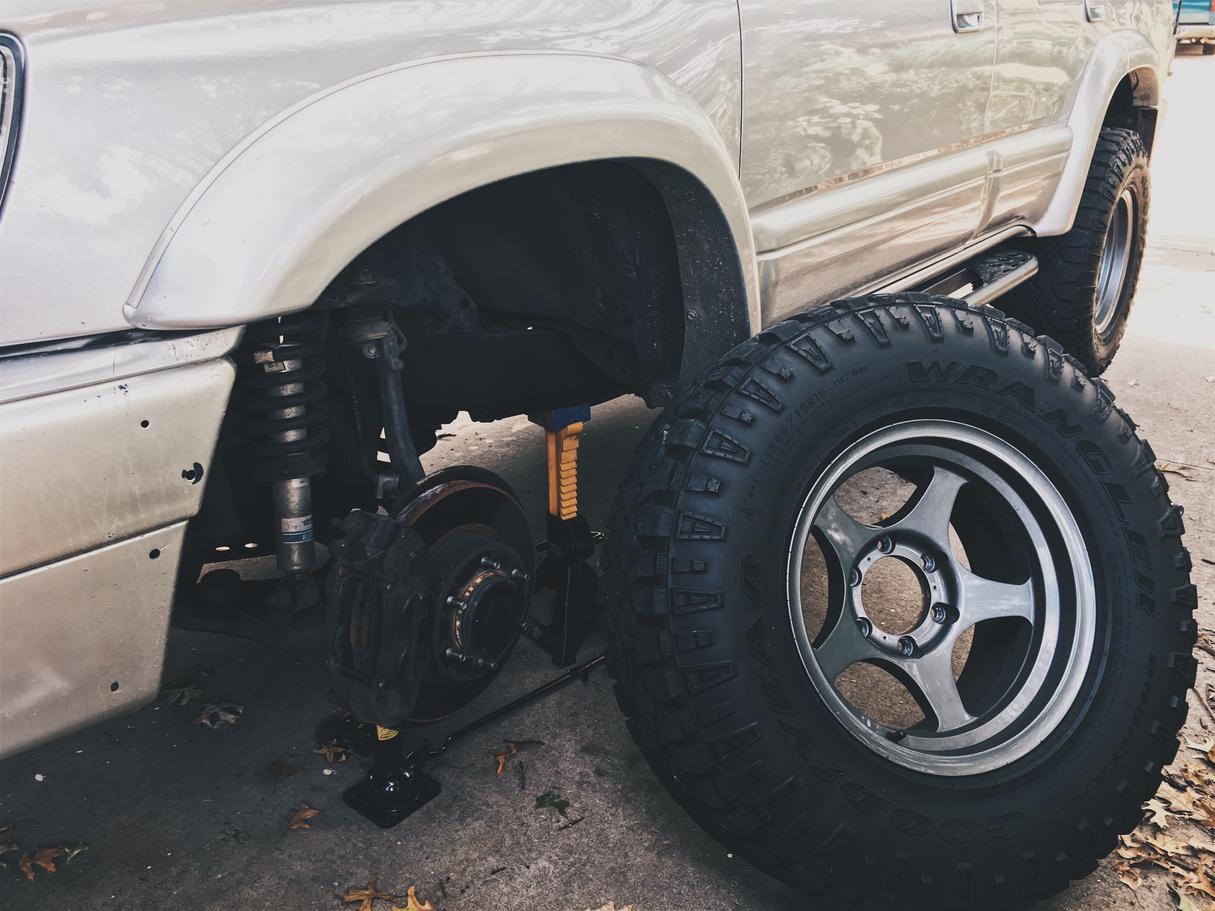

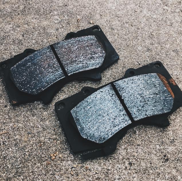

Finished up my 231 Tundra big brake revival. Had some terrible shaking during high speed braking that shook the entire car. Pretty scary, but found that the Autozone remanufactured caliper had seized against the rotor.
