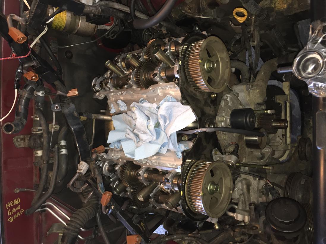

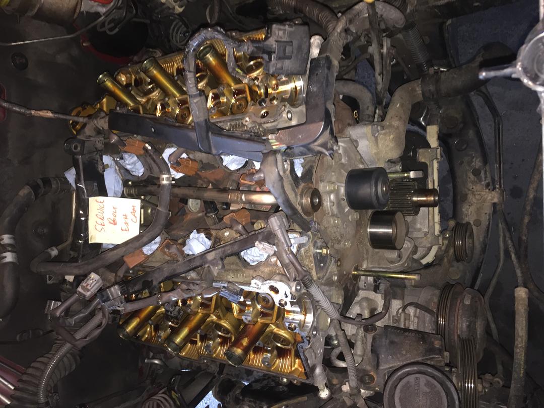

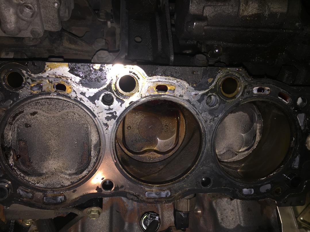

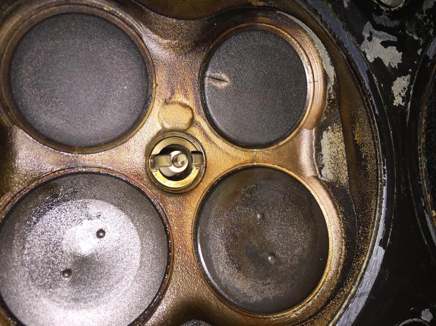

Rebuilt my top end. R&R head gaskets, top end gasket set, and had both heads rebuilt. Two and a half days of work, plus a few days of machine work. Runs great now and no more P0300 and coolant loss!

I'm curious if the shop CC'd the heads before and after, was your chamber volume affected? What gasket did you use? Did you reuse the head studs/bolts or use new? Will you retorque after X miles?

I’d have to check my paperwork from the machine shop, but they barely had to deck the heads as there was no warpage (didn’t overheat). It was more so just part of the rebuild, and confirmed that oem hg are fine with the minimal decking. Oem hg, aftermarket (Yotashop) upper end gasket kit, and new head bolts cuz TTY bolts. I don’t plan on retorqing the head bolts, unless I can find it in the FSM, tho never had to.

Cool, and as long as none of those head bolts bottom into a water jacket you should be fine.
As far as decking goes, even a few thou off the top will raise your compression, but an aftermarket rebuilders gasket kit usually addresses that.
Let us know how she runs and settles in
