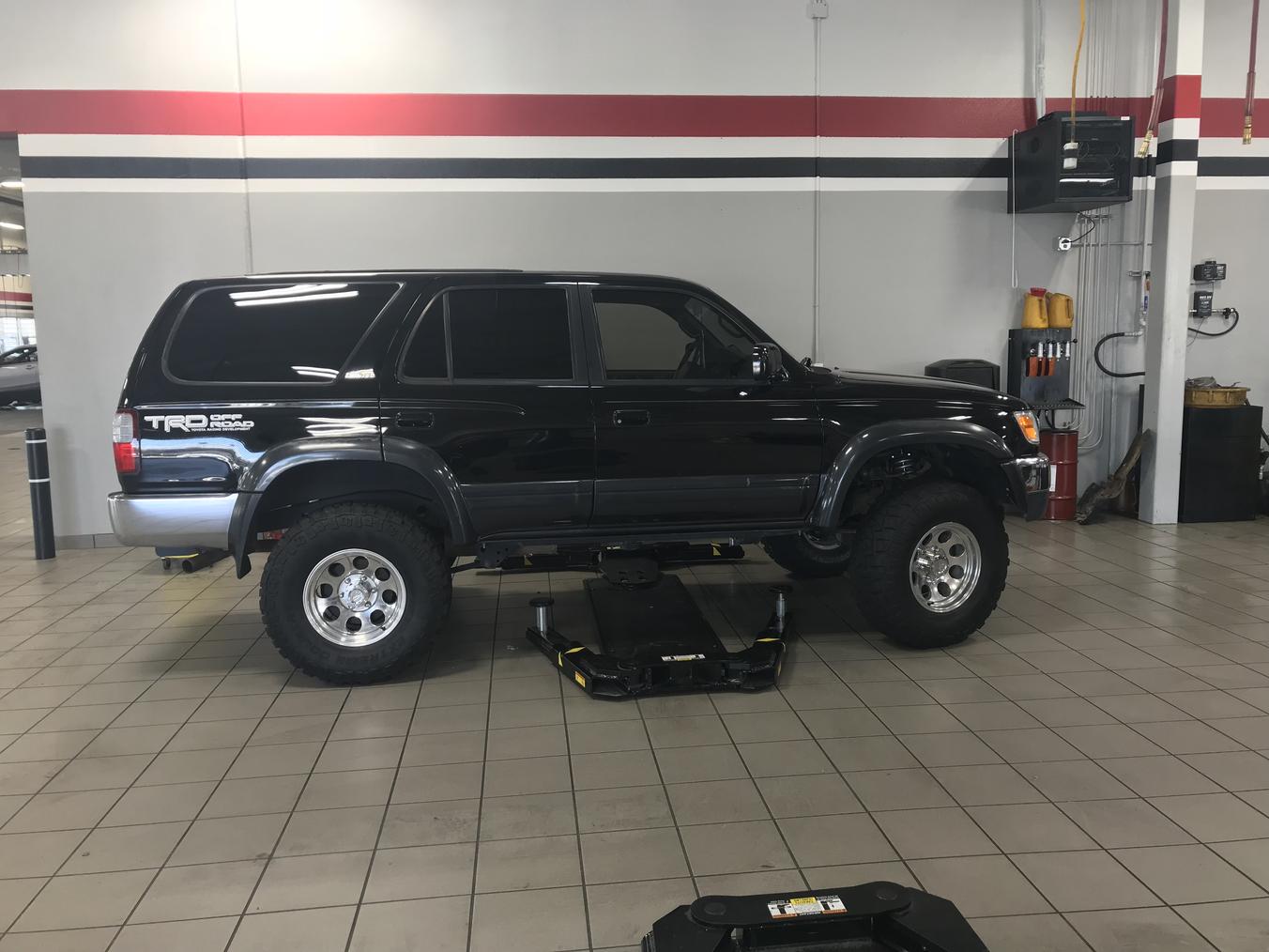

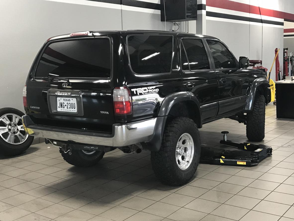

Finally got around to installing my new Toytec lift, loving it so far! Has a pretty nice rake in the back but it's surprisingly not as much as I thought it would be. I would post pics but my iPhone took them in a format that this site can't recognize...

Beautiful TRUCK...

Here's the pics from the lift.

The truck looks great. What really got my attention though is the cleanest shop floor I have ever seen. Do you guys actually do any work in there? lol
Lol when we want to. Nah but really we just spend WAY to much time cleaning it when we’re done. You should’ve seen it while we were working lol.

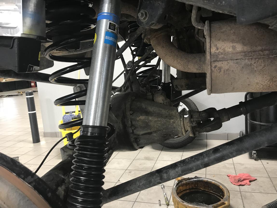

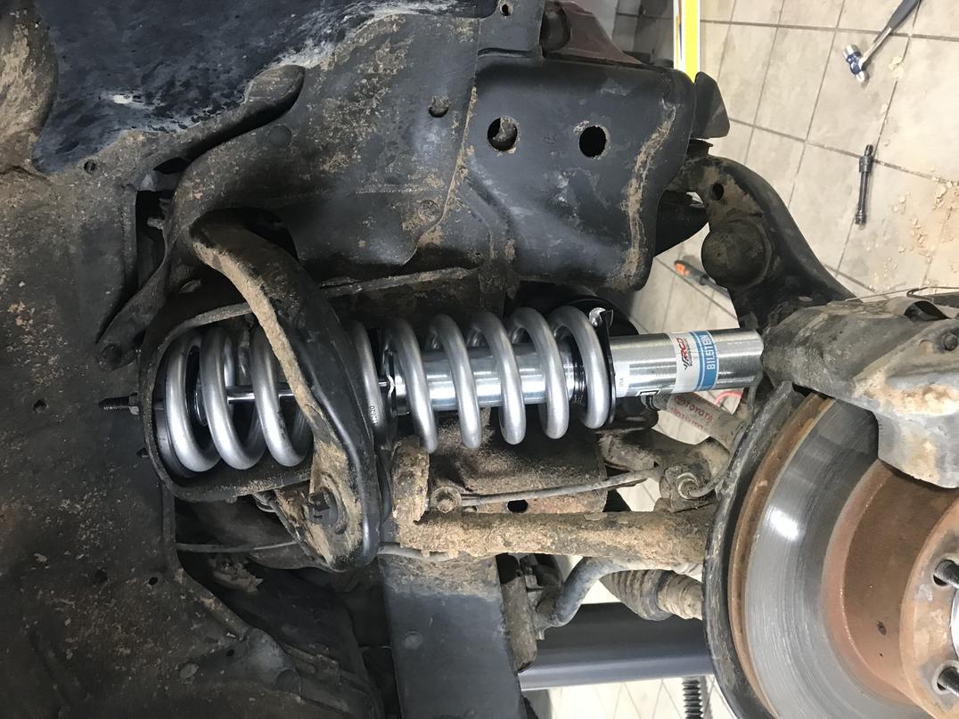

Lift

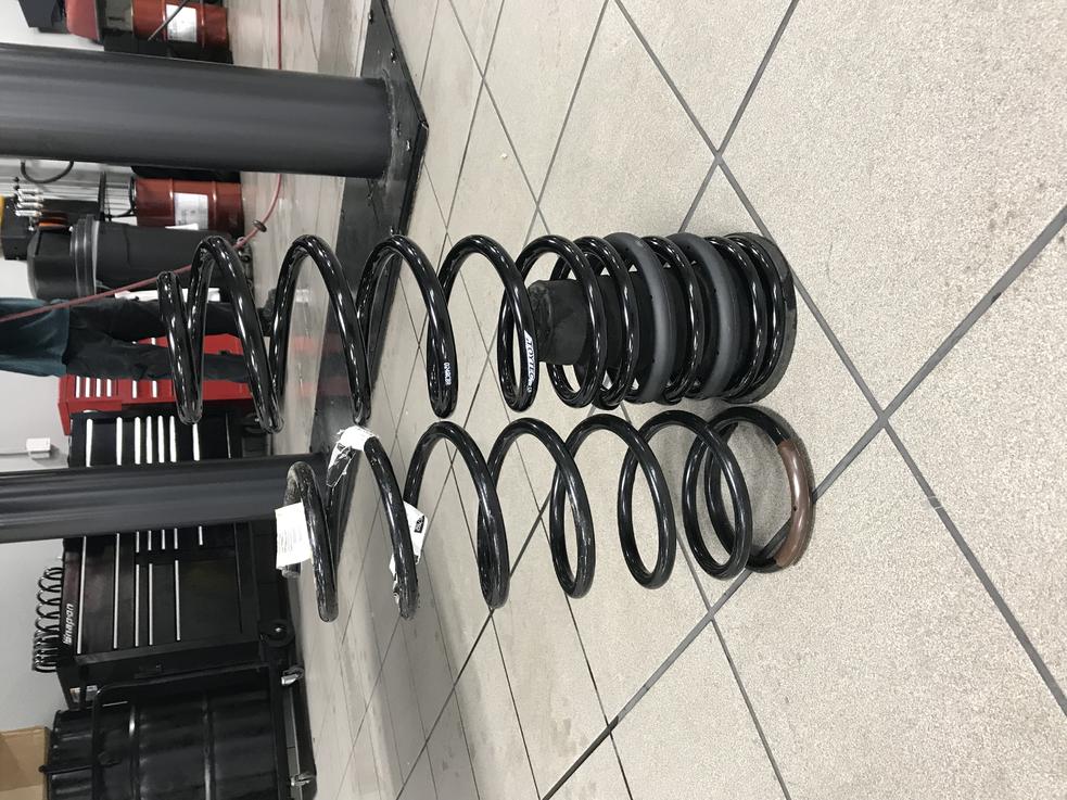

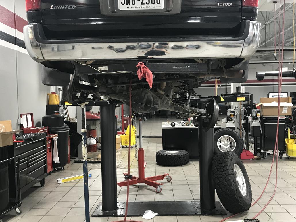

Finally installed my lift.
Front:
- Tundra TRD coils - 48131-AF100 and 48131-AF090
- Bilstein 5100 adjustable shocks - 24-261425
- Monroe top-hats - 904-900
- Monroe Tundra coil isolators - 907926
- SPC Upper Control Arm - 25460
- Toytek differential drop - TAC-DR
- Sway bar links - disconnected
Rear:
- LC 8 wrap coils
- Bilstein 5100 shocks - 24-100144
- Energy rubber bushings - 0.75” eyelet
- adjustable panhard bar
- 4Runner rear coil cone bumpstops (my surf didn't come with any)
- Sway bar links - Moog k90681
- 20” steel braided brake line
