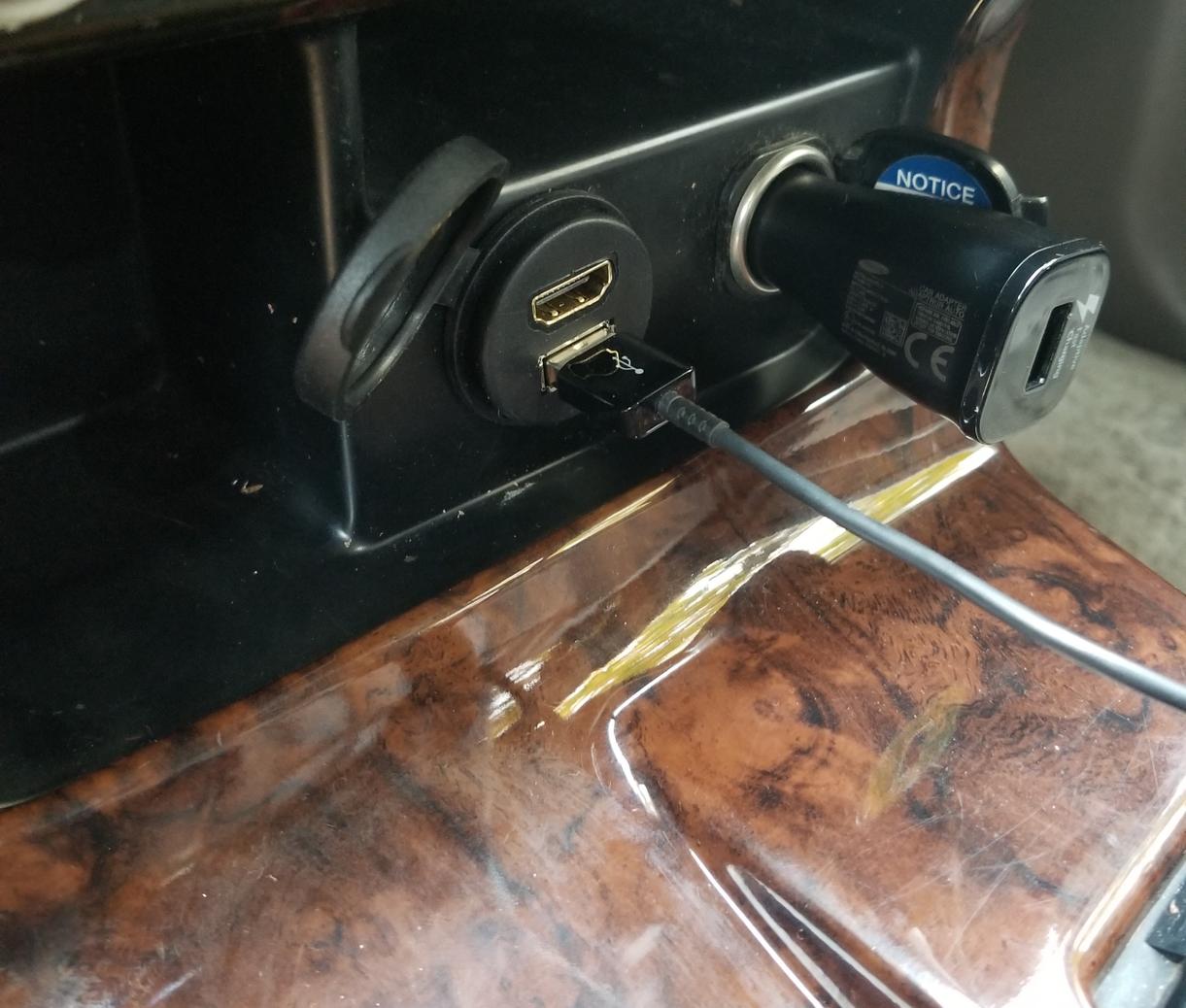

Installed my USB/HDMI port that connects to my stereo.

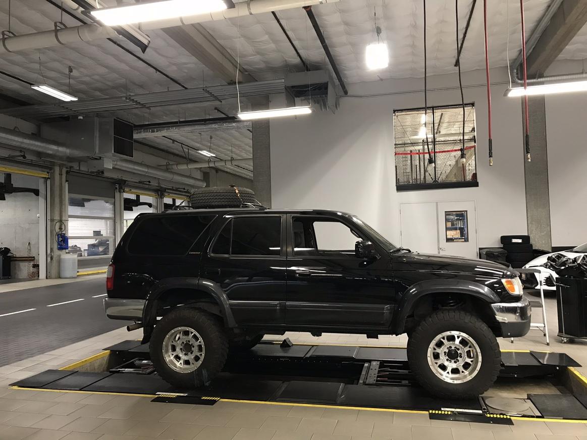

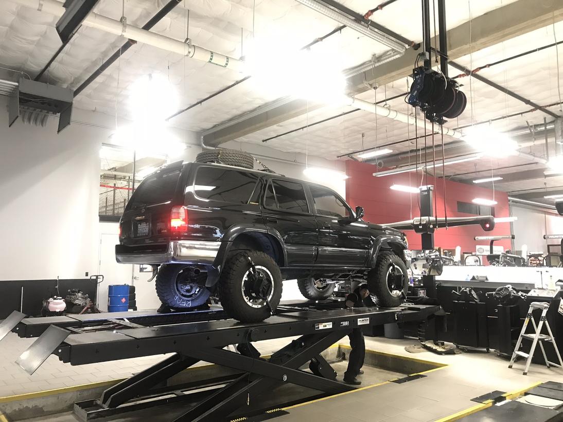

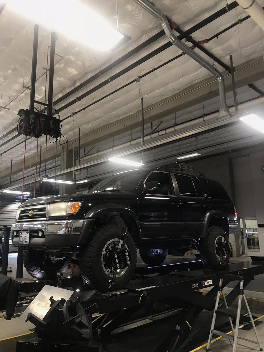

FINALLY!!! got my lift on after weeks of trying to decide what to get. I ended doing the Toytec/Eibach 112620 coils for the front and LC 8 wraps in the rear with 5100's all around. The rake was ridiculous when I first got the car off the lift. I was actually so bummed on how much rake there was. I wish I snapped a photo of it. This made me not want to mount my arb front bumper just yet. Anyways, heres how it looks: I have my stock rims and tires(4) in the trunk and my tool box in the trunk to weigh the rear down a little to even out the rake. Hopefully she settles down a bit after a few weeks... Btw I'm on the 2nd perch up front.
What model 5100 Billies? The 620# Eibach coils are what I run on Taco Billies(D558). I'm on the second perch with a Relentless bumper and engo winch. You could go up again when you put on the ARB if you are running Tundra billies. They have 5 perches.
If the 8 wraps are used I wouldn't count on any settling. You've got a couple options at this point if you really can't live with the rake. New rear bumper but then you'll really compress the 8 wraps. New springs. Obviously the springs are cheaper and you could sell the 8 wraps to make up for it. I have some 3" Toytec 9602RC sitting in the garage that I removed when I added my rear bumper. They road very well without the added weight. They're a solid choice if you go lower.
I have the tundra 5100s. I am a little skeptical about going up the the 3rd perch. I keep hearing about harsh ride quality. I absolutely love the way it rides right now with the 4 tires in the back. I don't feel that the spring is over compressed at all right now and like others said, it rides like a Cadillac. I might just live with it until I get a rear bumper that can weight it down as much as the 4 wheels in my trunk lol.
Also on about the settling. I was always unsure of that. People always talk about used LC coils settling but don't most people get theme used so how would they settle more? I did a little research on the forum, might have been on a different one, but some dude talked about how they have been uncompressed for a while in cold and hot weather cycles so now since theyre are being put back under load, that they should still have about .5"-1.0" of settling to go... ? Can someone confirm this.
If anything I either get leveling spaces for the front, get smaller lc coils, or move up to the 3rd perch on the tundra 5100s
