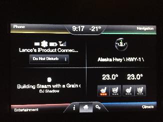

On Friday I'm having the heated seats function added to the driver and passenger seats, through my local VW dealership and their third party partner.

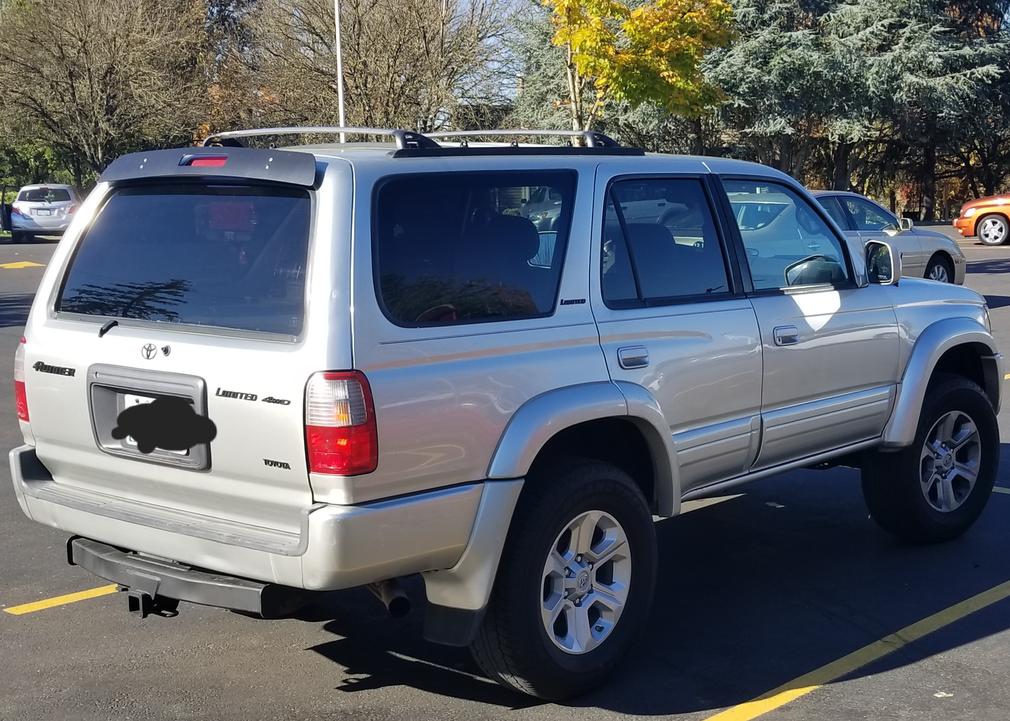

Picked up these 2016 alloys. Guy had them on for a week, then stored them in his garage for a year, got all 4 with lug nuts for $280. I had a momentary panic when I first saw them thinking, those look way bigger than 17"...they measure 18.5" across the face...but my 16" rims measure 17" across the face, so I think (unless one of you guys tell me I am an idiot) that these are 17" rims that will be getting snow tires soon.

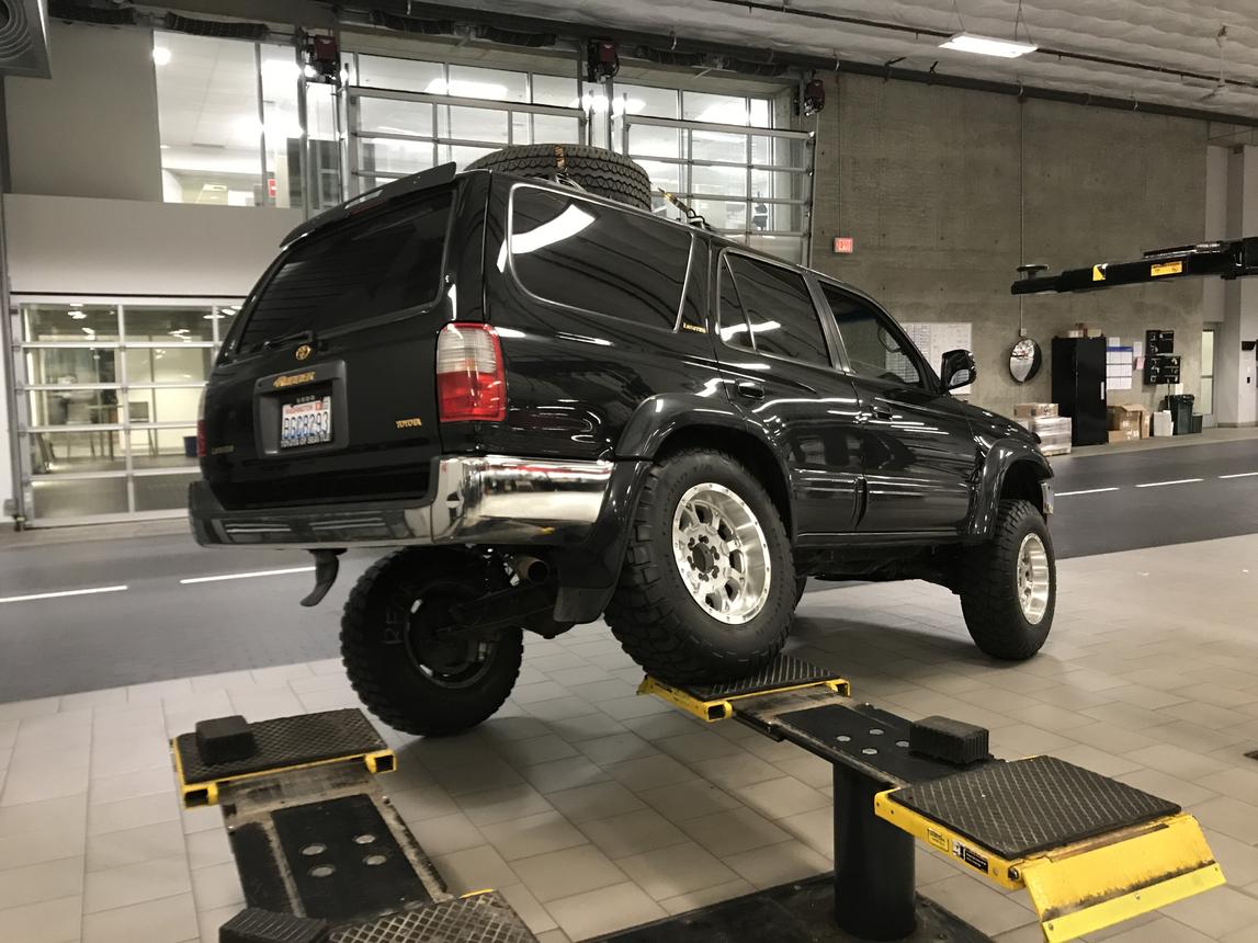

put in a new rear center brake line today. Didn't get an extended aftermarket one. I ended up using a brake line off a 2nd gen 4runner with was a couple inches longer. not as long as an aftermarket one but definitely enough slack for my lift even at flex. heres a little flex action with both sway bars still on

They are 17's, I have the same ones on my 3rd gen

how much is that going to set you back?
$500 for both seats, with a warranty. They just did it on my wife's Tiguan (paid by the dealer, part of the deal when we bought it) and man, they did an excellent job. The switches are higher quality than OEM Volkswagen ones. And it works like a charm.
NICE Christian!! That rig looks super clean. I briefly saw your rig the other day as I was pulling out from the pumps at Costco. I really like the way those wheels look on your black 4runner. Very sharp! Looking forward to seeing some more pics for sure.
It's just not fair for a 4runner to look like that, man, shit.
WTH are those wheels? And did you just wax/polish/ceramic coat that paint or what? :jaw::jaw:
