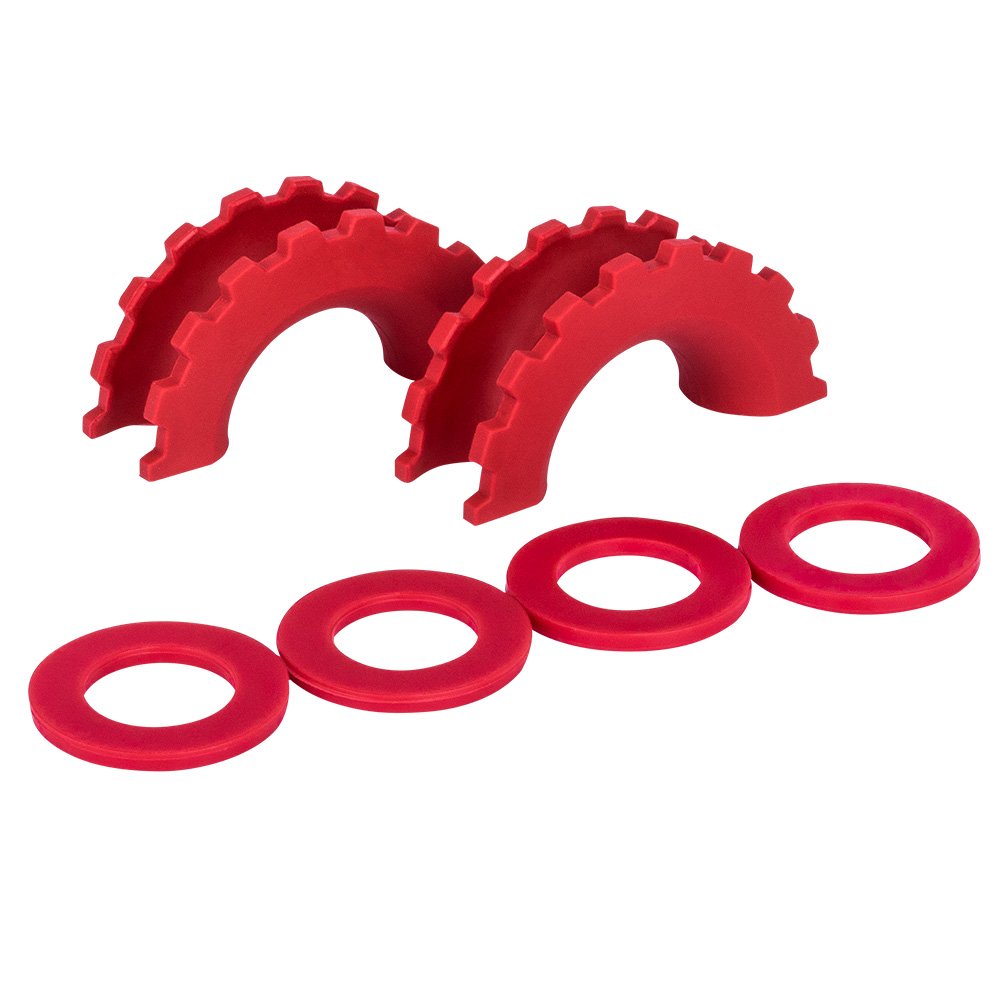

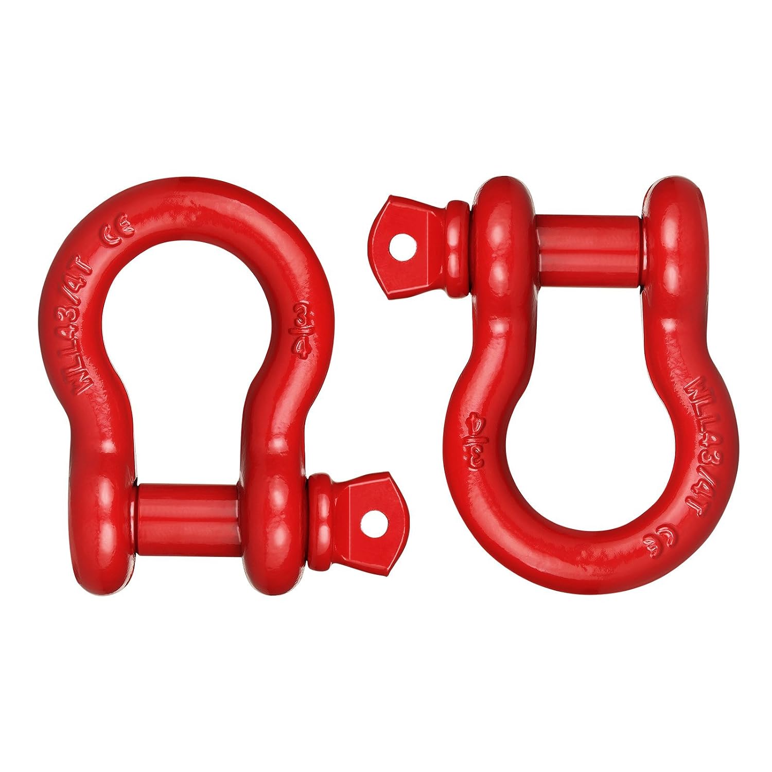

Another thing I want to get are shackles I think red would look nice
At the same time I might as well pick up some shackle isolators to keep the scratching and clanking to a minimum

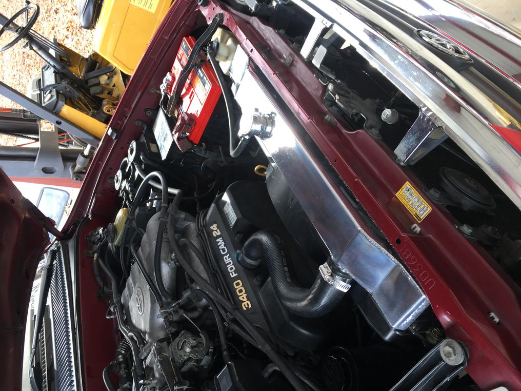

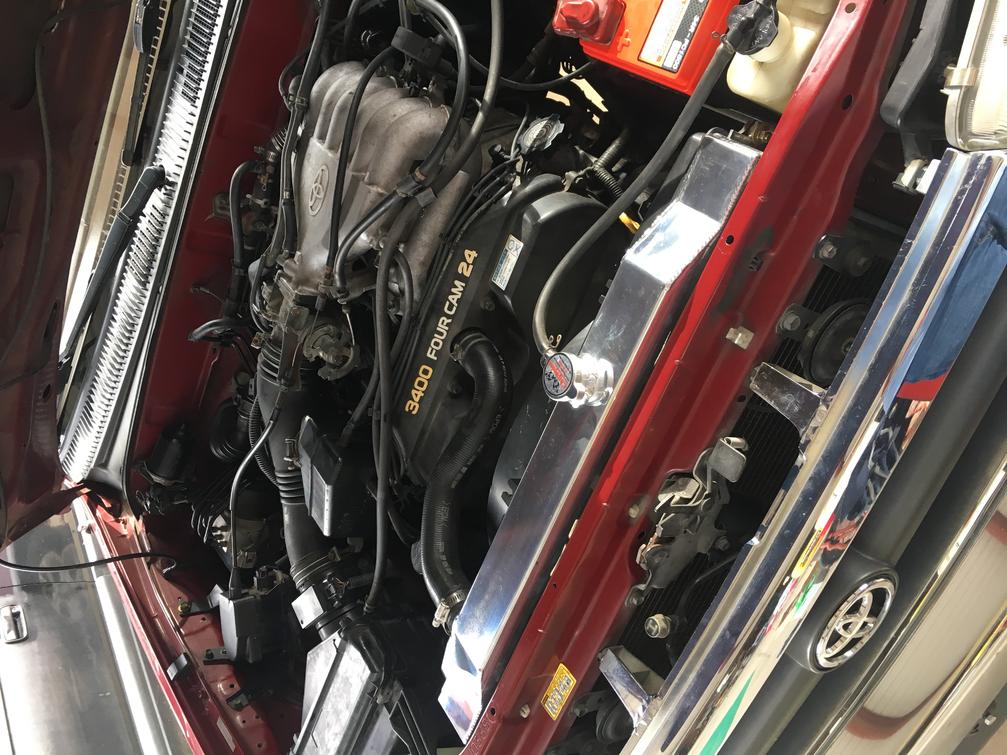

Finally wrapped this up and have it back on the road.
Um98f6rPR0jChDLROnPEBI945mm8_xCALMGPZ1K5bUgu1EOndqapArqjEvEMQboVN_KtaihGtSietWjJCiOmHAfsTSvNHKrlhqJWrSgXMD7w6Y92o3akK9Vz3QnNFLops6We6zhv6j8Ah96Lor20JLCg5t9xbKZPEmW_nQHHLzL0ZkTa5oyWVKm0Fx52ASFsddwQ9wNZAQdvpgMOtk6sDXKg-lWAi4DMcplykZR1Ln3hoGrZ1sbUcgckWF38__SCuSnMy7mvukeZPAcZfs_TgHGB13wjN3pkWS4-H8By6_lhWn2YO9DJDm_Y0JTeJaX0sB-WEh4uEQPV5TjWgk6mDbpgRmxN9b3ng8r7OEuLdoAq0GKXzCJ8lHAxtIvcMFEl6NYDi0yjspb2OLNnLU5T5gDs7pG9HVlWTi9nv2gdnQCh-yb1Ir9cbKdadrE_YSF-MgRk6wswYnEETz_4IdhpX7N5oQXPPI6HpcJILTQ_NxIMb29wGbYKP9q4EiY6pM79XkLumlH8kWrg442TTnSDuIdsWoF6g5cDCeXpothYcWBh25m4vyCgHMfR7BhaHt-mw4J3TLF5mQ9Fgqpg4PEYBKgO8aUGyw_gKgzhOAd5gVw=w678-h944-no
New castings, original valves, camshafts etc. OEM gaskets, head bolts, radiator, hoses, belts, timing belt, injectors cleaned. Lots of fun.
So glad this forum is here, such a fantastic resource that truly made this job go smoothly.
But next time I'm taking it to [MENTION=120071]mtbtim[/MENTION]

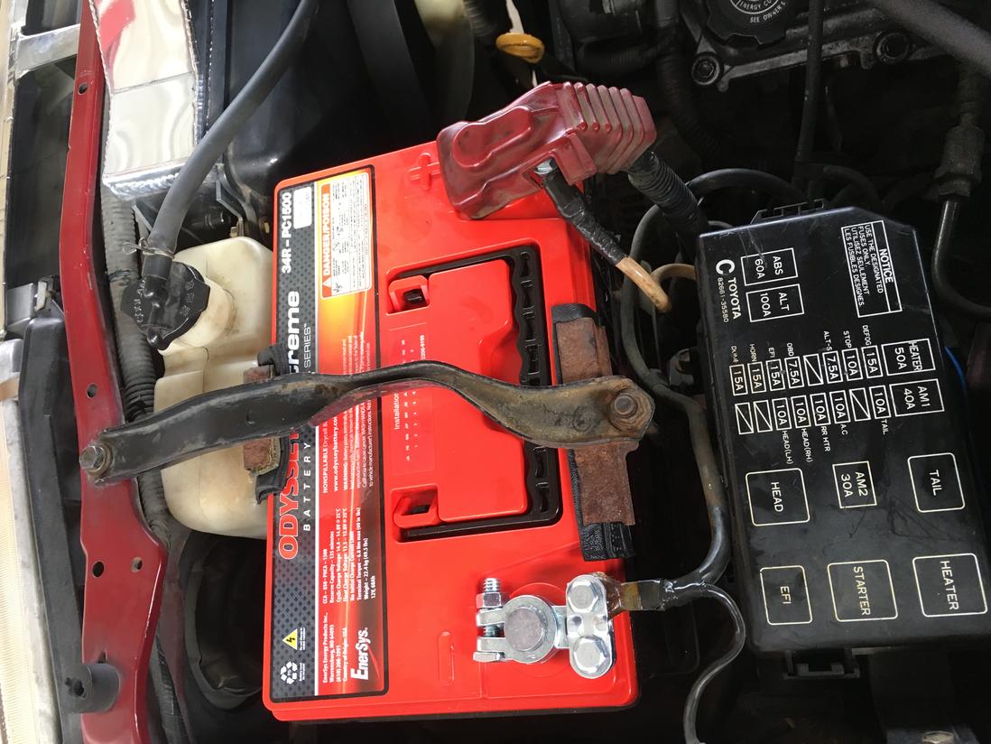

New Champion all aluminum radiator and Odyssey battery.
