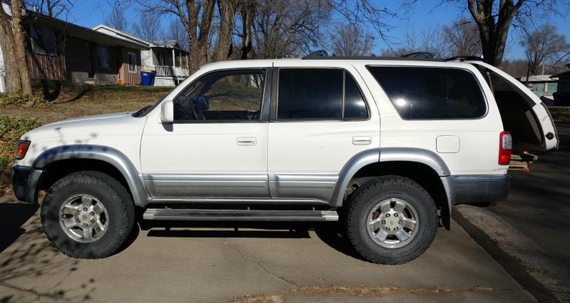

Took a log to the sawmill for some new lumber. Weight in the rear is about 1200 lbs and I'm sitting pretty level, but no rake. I'm running OME 891 coils and they took the weight quite well.
Before is about 25in from wheel hub
After is about 22 in from wheel hub

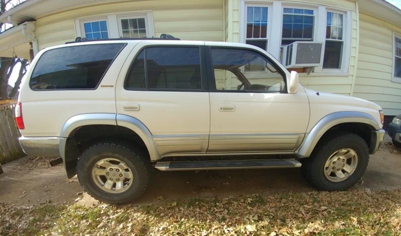

Took my new-to-me '98 LTD to the wash today.
A little backstory: I've never had a vehicle with a retracting antenna before my 4Runner.
Guess who doesn't have a retracting antenna anymore?
I read a few threads here about replacement, but does anyone know the Taco year-models that would fit appropriately, or is it simply safe to assume a 2nd gen (or '98) Taco antenna would fit?

Just buy the replacement mast. not expensive and easy to do.
https://www.ebay.com/itm/NEW-GENUIN...ash=item2ef6d3e0b3:g:hPQAAOSwo4pYHTfh&vxp=mtr
the one I linked is 45.00 but i've seen them for 12.00

Here is the OEM part #'s. Before you pull the whole wire out attach a cable or string/cord/wire to end under the dash so you can fish the new one back thru.
mount p/n 86300-35090
antenna P/n 86309-0C020

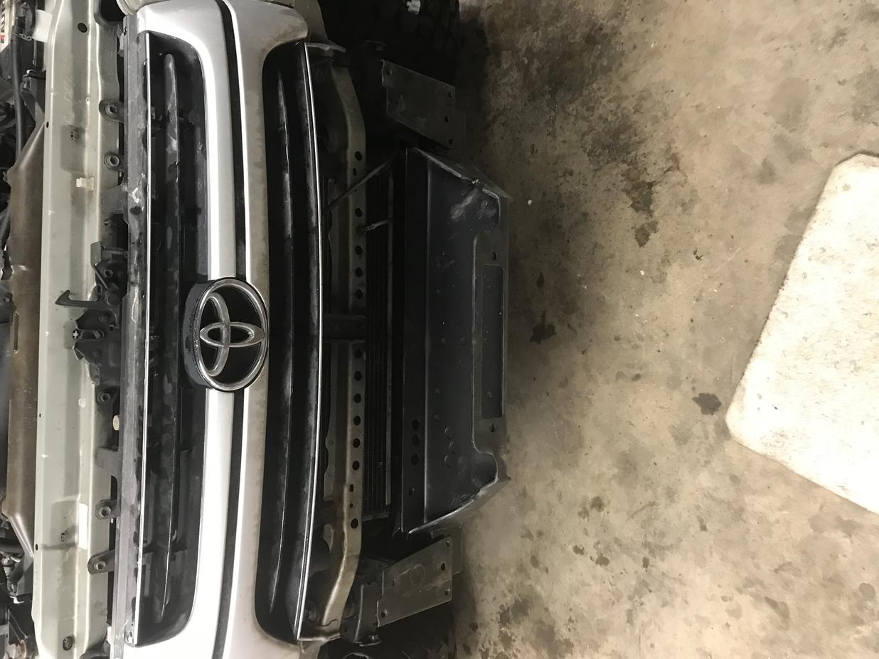

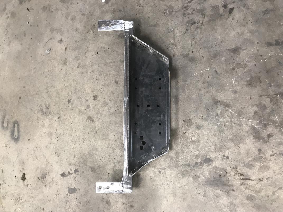

Last night a buddy and me built a hidden winch plate for the 01 fat lip bumper.

Looks interesting, but how thick is the steel you used and why only 2 connections points (tow hooks, I know) to the frame? The winch will potentially pull the entire rolling weight of your vehicle, plus any obstruction like mud.
I tend to worry though

Well winch plate started out as badlands Universal winch plate. We used 1/4 plate for gussets and 1/4 angle. Winch plate sets in line with the frame rails has 4 mounting spots where the tow hooks were. So it sits up pretty high. Way out of the mud u will be dragging the skid plate before even touching the winch plate.
