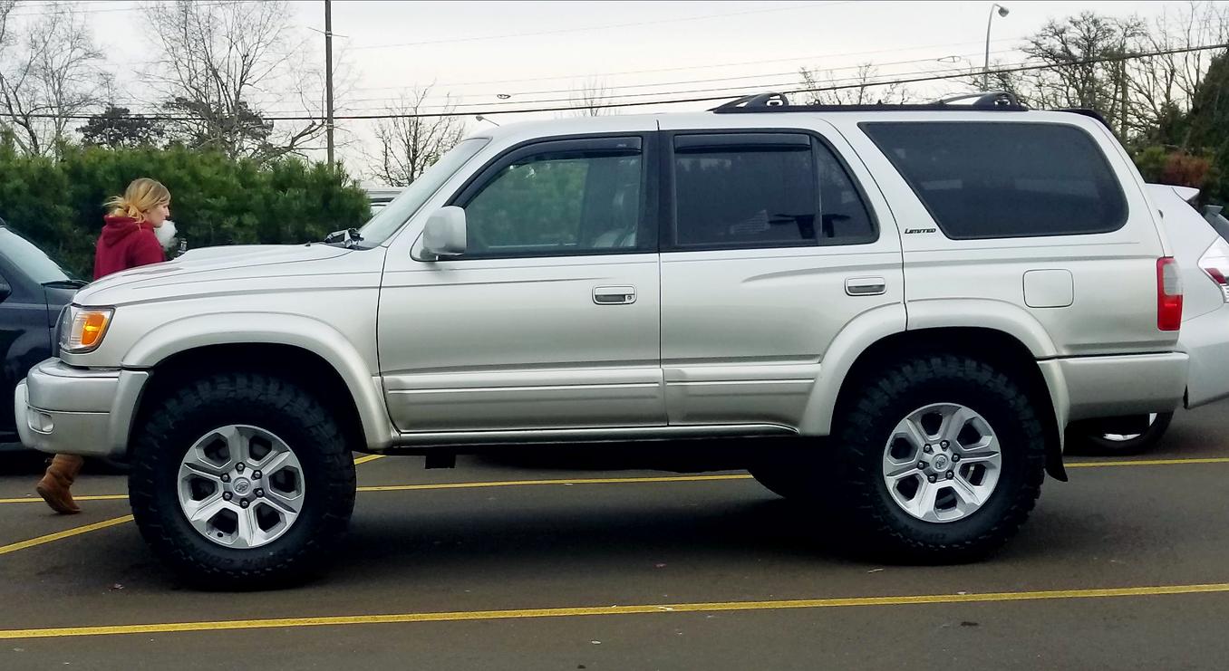

What size tires are you running? That looks pretty small for a 3" lift...
Im running 33x10.50r15
The rear hasnt settled in yet
