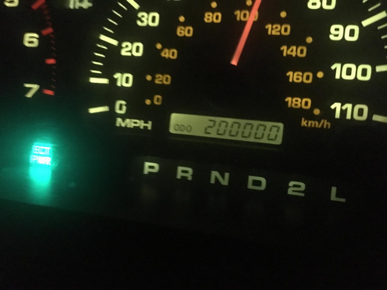

Just turned 200K! A Christmas miracle!

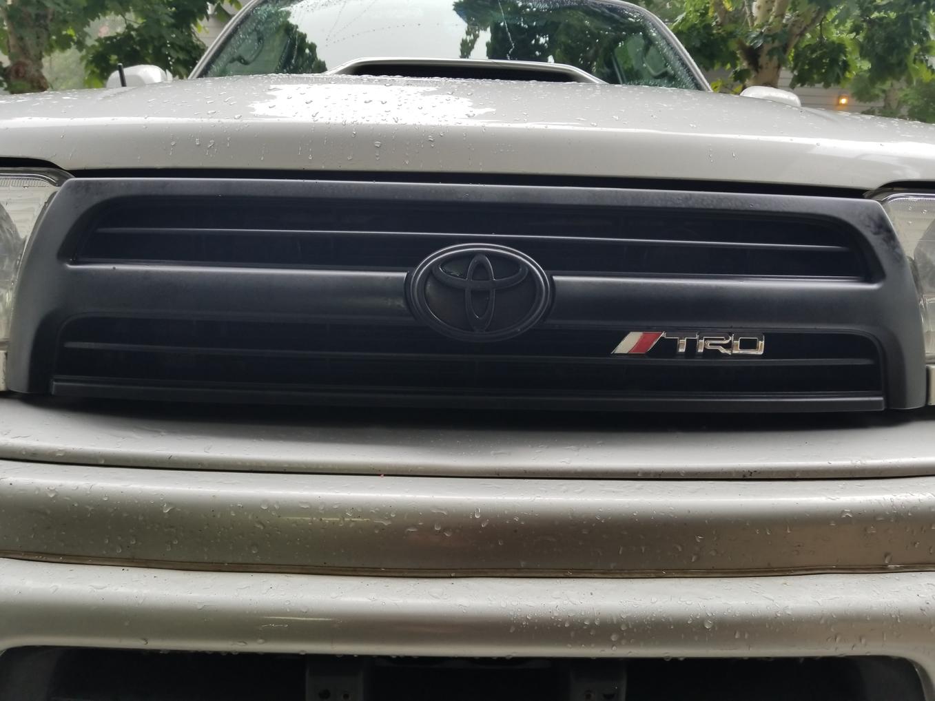

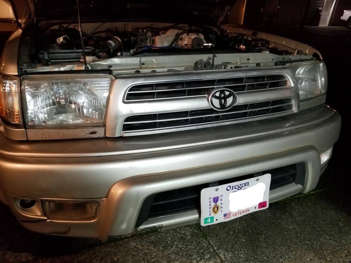

Got the urge to try out the dupli color paint to see if it matched. I already know its a shitty paint job so I don't need your feedback about it. I took auto painting for 2 years but where I live I don't have my booth set up or the supplies to do what I am capable of. It is also 30 degrees out and dark so it was a spur of the moment thing. I also need to properly strip the old grill as the PO plasti dipped the hell out of it.

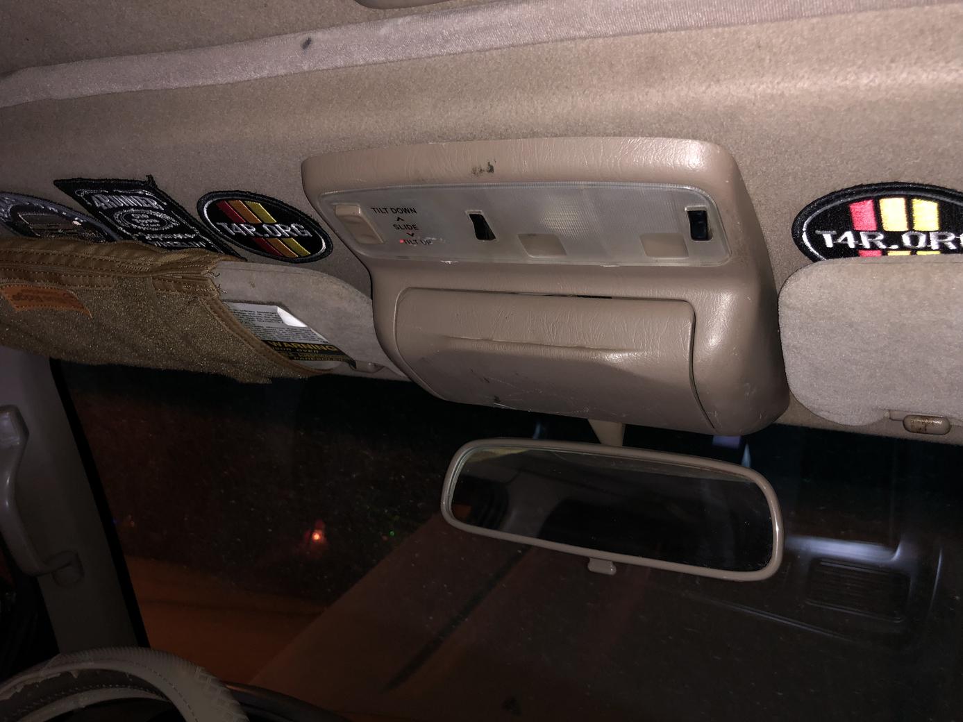

Mocked up my overhead console... just need to ask [MENTION=198376]4Runner4Leon[/MENTION] when he has some free time to possibly wire it up for me. Beer of your choice on me :hello:

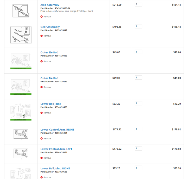

Look who's getting ready to go shopping!!!!! McGeorge is a lot cheaper over Toyota of Dallas on this one for me, even in shipping. Scares the hell out of me when that one Lower Ball Joint doesn't say "Left" on it. I checked it like three times.
Feel free to make sure I didn't throw any 2WD parts in there.... LOL

You have new LBJ bolts too?
In my mind I do... I didn't see them on the site so I was going to search and get the specs. I know they were talked about on here. I've also got to get another set of cam bolts. I've got one set that never went in yet.
Figured all of this, and the ADS Coilovers that I bought I think around Thanksgiving can sit for a few months till I get gears. Then put it all in at once.
Replaced this LEFT ball joint last year if that helps:
LOWER BALL JOINT 43340-39465
Agree- bolts. All I remember is there are an early and late style. I keep a set of the old ones in the tool bag for in cases.
You prolly have it but since I have it handy: 4 Lower ball joint bolts 59 ft lb and loctite, ball joint bolt 105 ft lb
