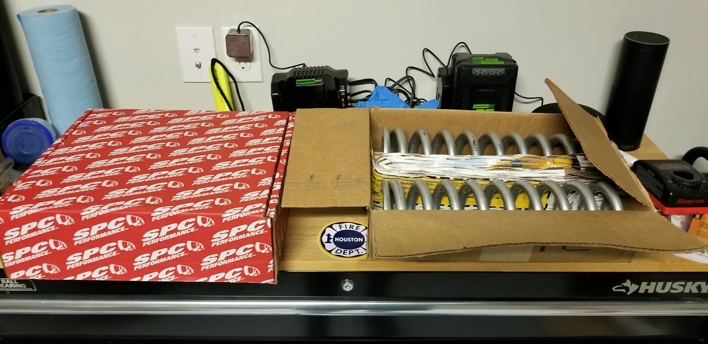

finally installed my rear OME 890 springs and B-5100 struts.
the old stuff was completely gone. struts were rusting away, and wouldn't extend on their own and the top bushing assembly was done incorrectly by the previous owner. The springs, when compressed had about 1/2" gap between each ring.
can already tell the back end is much tighter. very happy. but I can definitely tell that something is clinking in the front end. every speed bump in may parking garage shifts something around. not sure what, maybe wheel bearing? (just installed new UBJ and LBJ and rack bushings.) I have new tie rod end links which need to be installed. I'm thinking go to alignment/brake shop and have them check it out.
much happier with the stance, will have to get some 1/4" or 1/2" spacers after it settles. im still a little low on the drivers side.

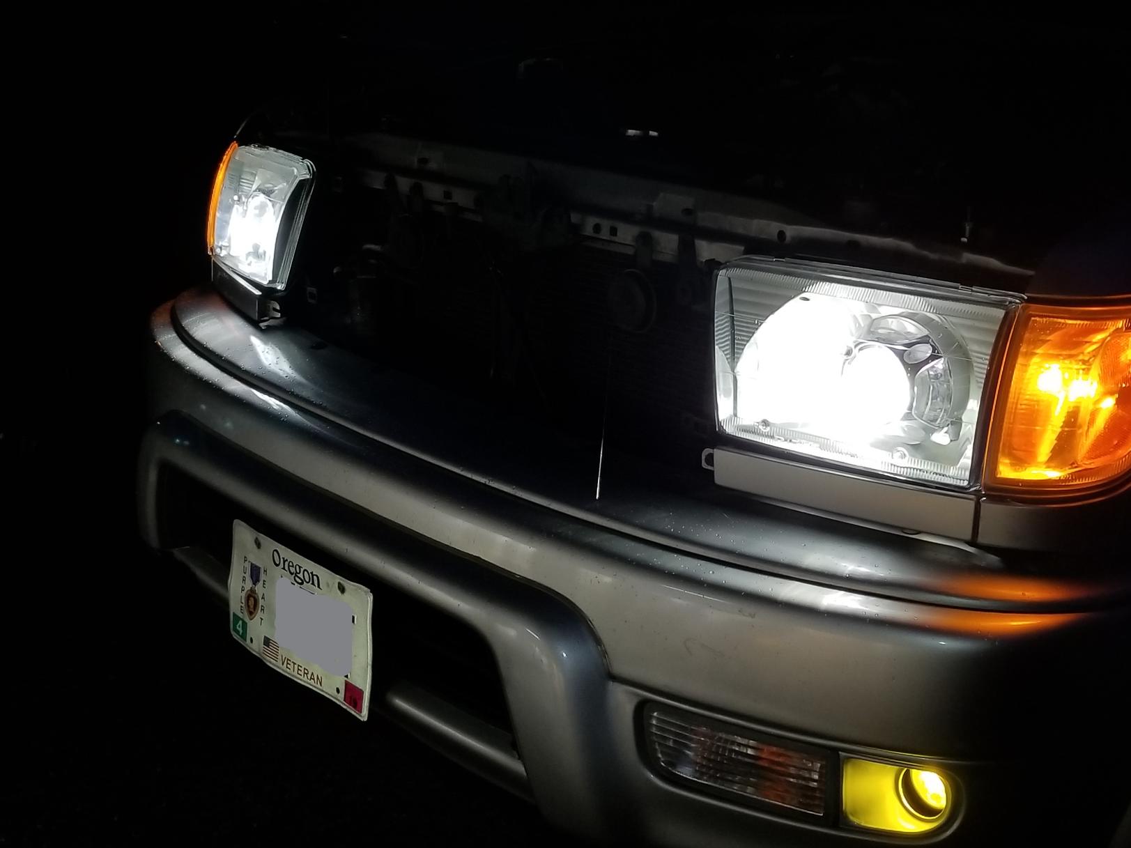

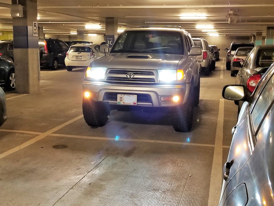

Installed my PIAA solar yellow H3 bulbs in the fogs. It's amazing the difference between a premium halogen and an LED. Top is the LED
