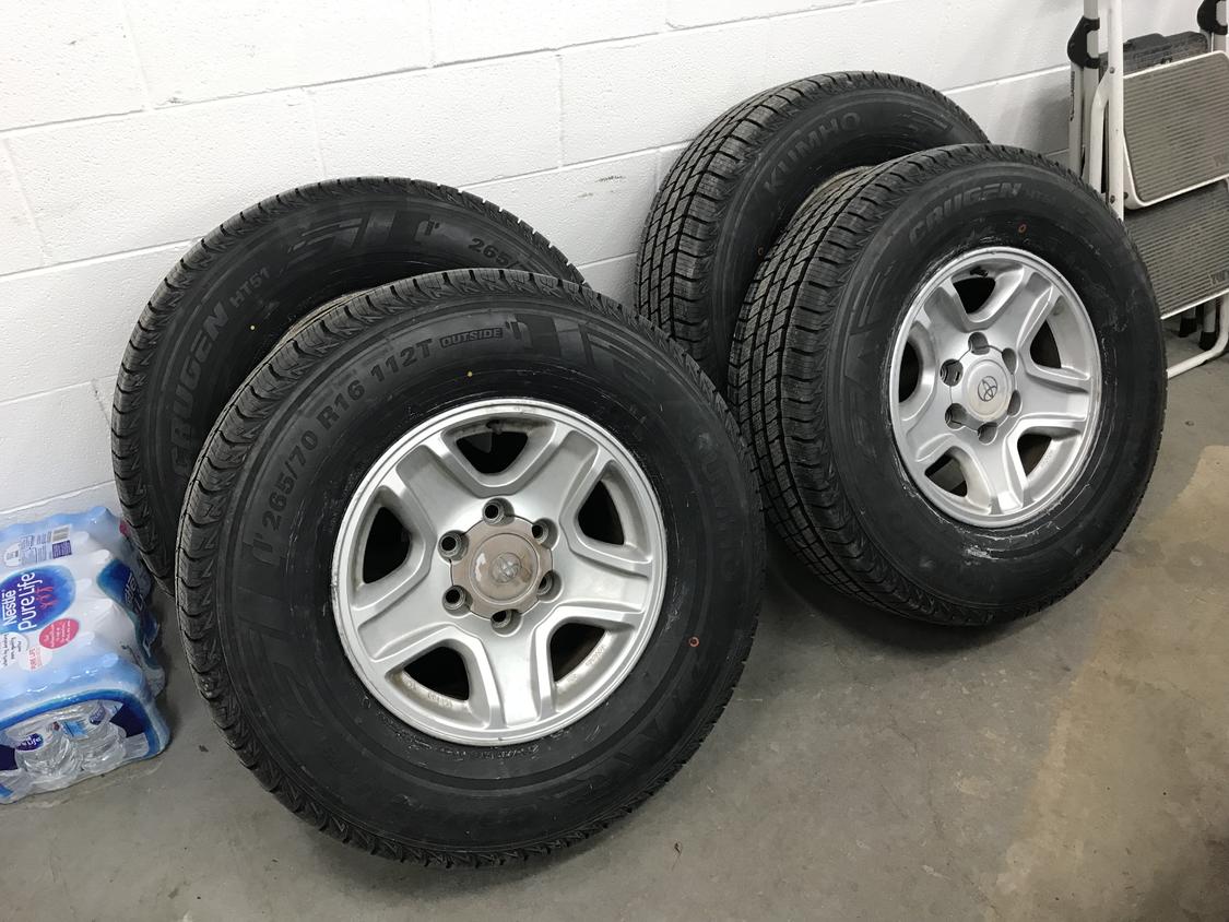

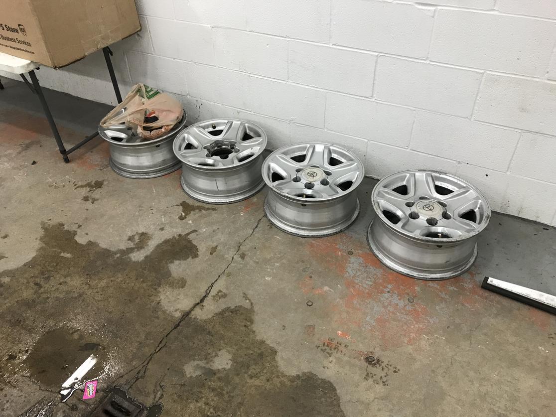

Purchased a couple sets of the 5 spoke wheels from a member here. One set is already mounted with new Kumho street tires and the 2nd set will get some refinishing (powdercoat or DIY paint) then some BFG ko2 tires to get into off roading.
I’ll post some photos when I throw them on the truck.

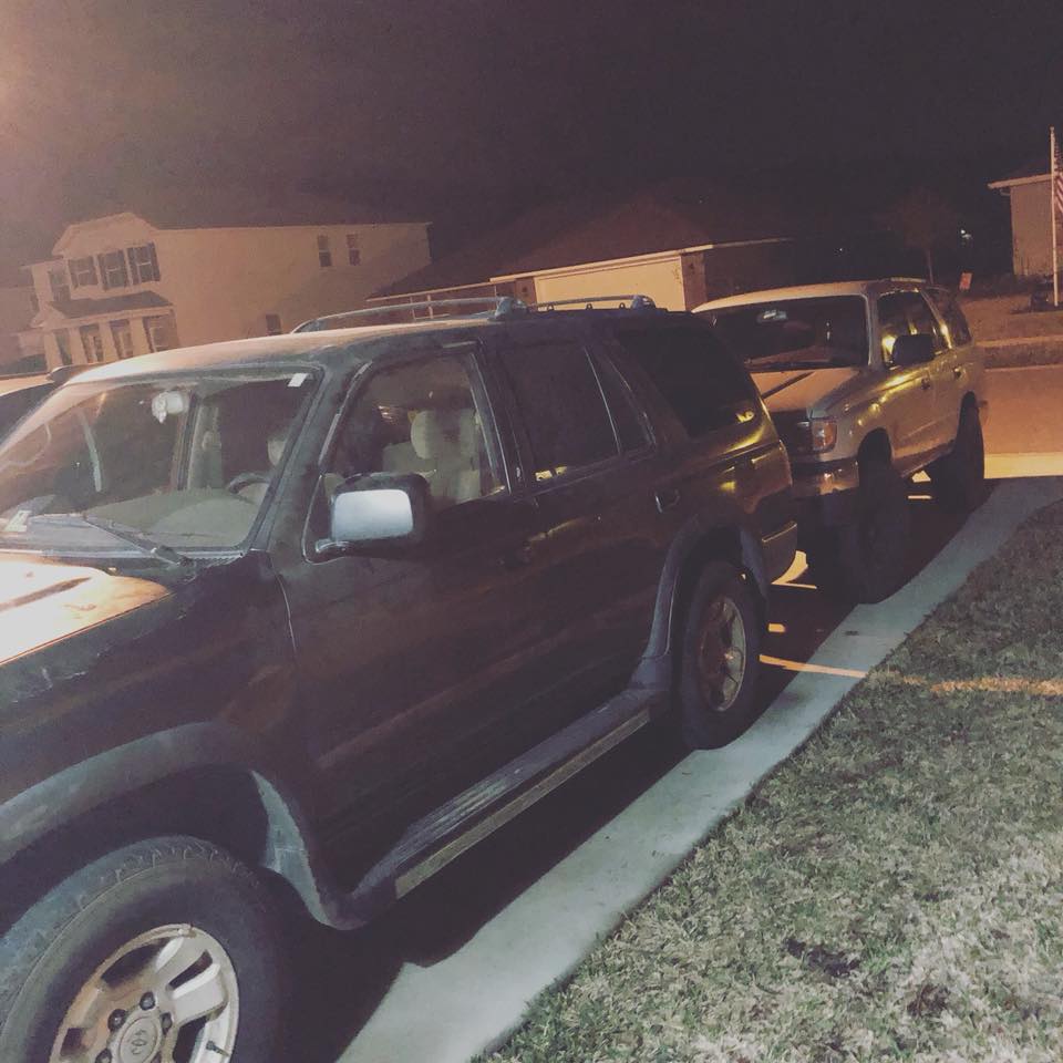

I just purchased mine today so a did a lot to check inspect it and get it home on the bald , dry rotted tires. Much to come along with tons of build threads since this one is gonna get restored.

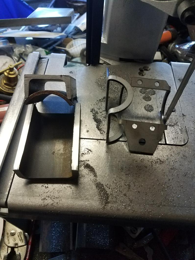

Finally working on a fix for my wiggling Savage swingout. Testing in Moab on the prototype commences in a bit over a week.
