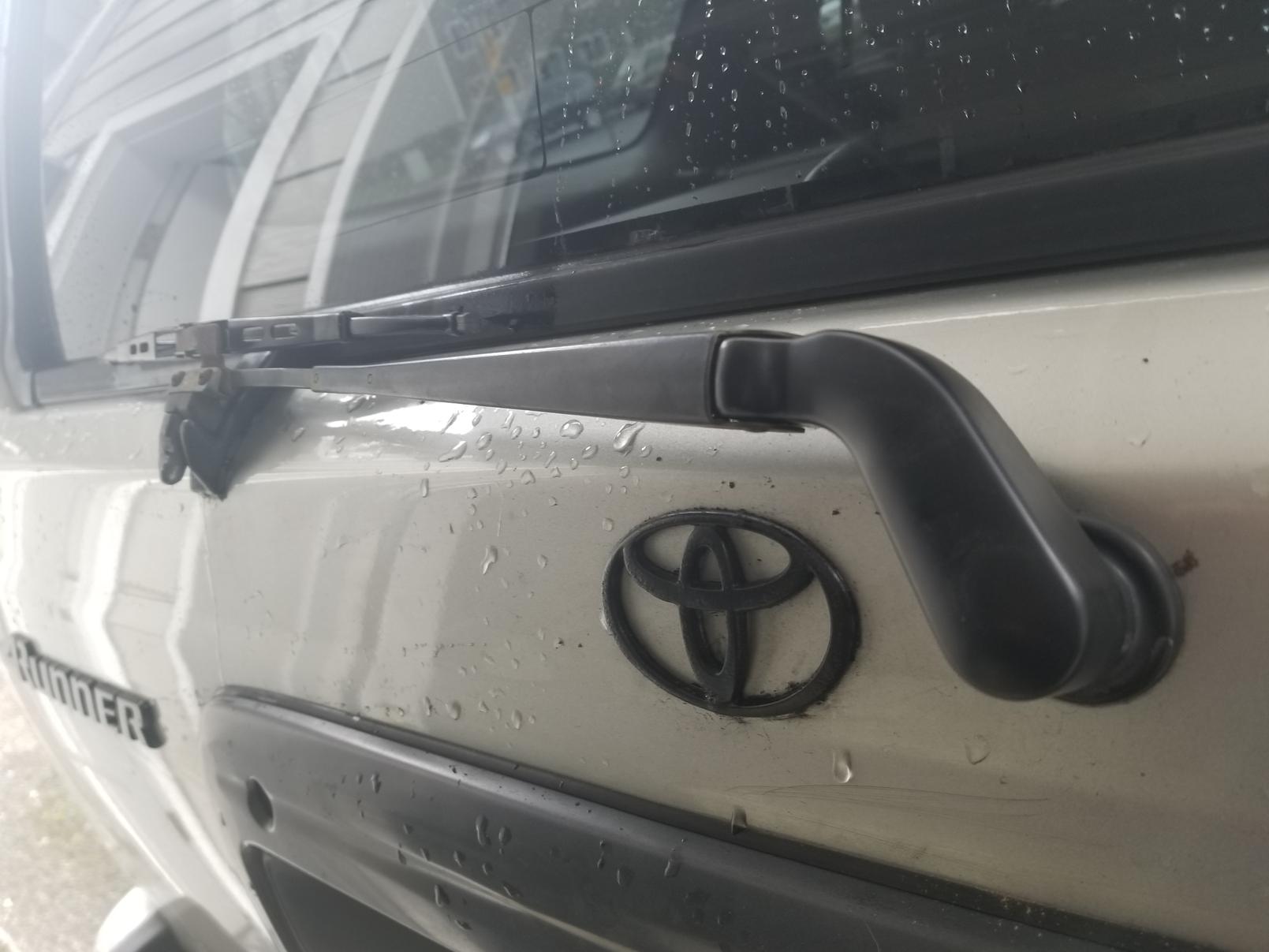

I replaced my rear wiper motor so I can actually have a rear wiper now. My life has come full circle as I can now use my rear wiper.

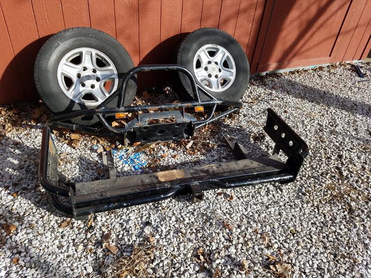

So I didn't get the Sport hood like I was hoping. That's ok though. I found something WAAAAY better. Not a S/C, but almost as good. I'll put up pics tomorrow after I get the other half of it, but let me say this.... it's the score of my life.
Addicted Off-road front and rear bumpers. 33 bucks for the front, 29 for the rear. Couldn't believe it. Need some paint but that be easy.
Nice find! I thought I got a killer deal when I got my Addicted Offroad front bumper used for $350 or so

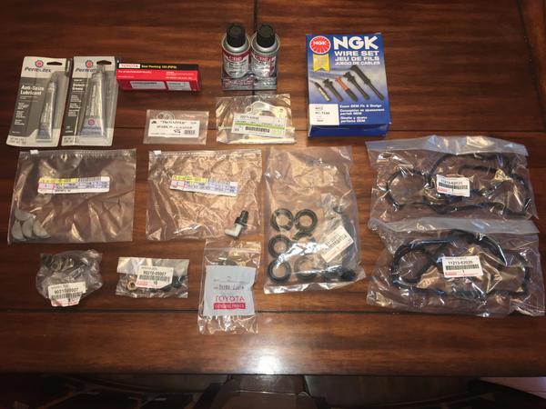

Got started on valve cover gaskets and radiator last night. IMG_20180215_180009340.jpg

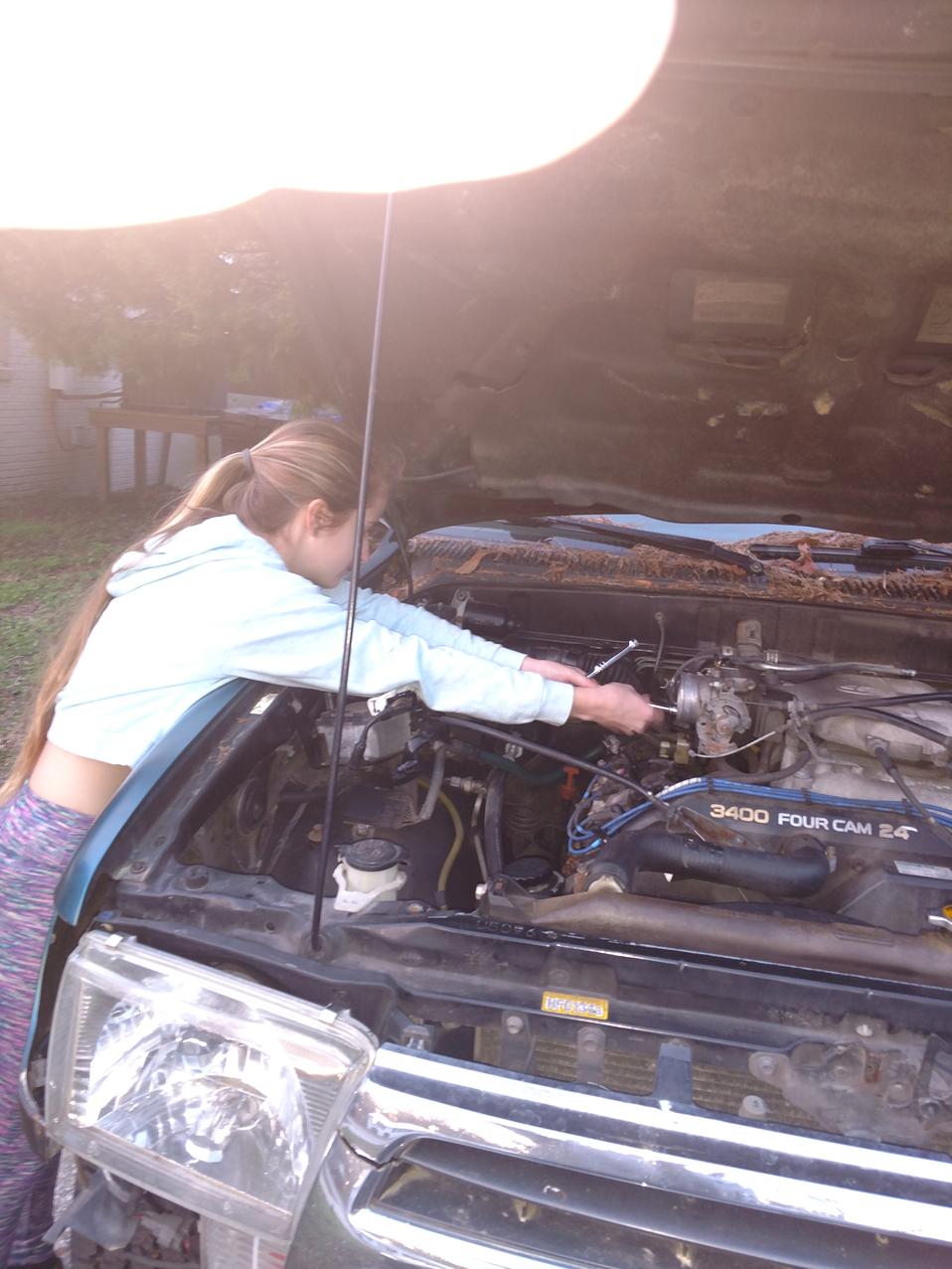

Bella was home from school today (teacher work day) Decided to do some herself. Managed to remove the intake manifold. Not to many 15 year girls or boys will mess with this stuff these days. We got the covers off when I got home.
For the bad part. Gaskets have been done before, no evidence of RVT or FIPC where they were supposed to be. And i almost didnt need a ratchet to remove the bolts, very loose. makes me wonder who was working on it. I think while I have the radiator off I should check the timing belt. Supposedly recently done.
Keep this in mind when you are putting them back on. These need very little torque. Too much and you will crack the cover. The spec is surprisingly low on these.
Just FYI.
Just FYI.
53 inch pounds I believe. On new crush washers. I learned the hard way on old cork gaskets many moons ago. There were some of these I could have taken out with my fingers.
Holy Hell man, that is the deal of a lifetime. Nice find.
I pooped a little when I walked up to it in the yard and saw those on there. They try to charge me 110 for the rear bumper because they thought it was a subframe. I convinced them it was just a beefy hitch and that knocked it down to 27 plus tax. I'm pretty sure I couldn't even buy the material for $63.
