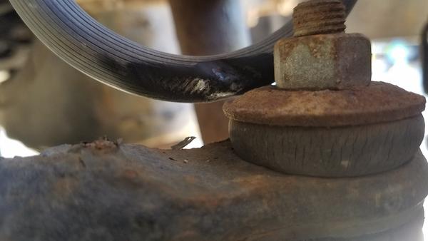

My RF brake hose is rubbing against the sway bar, not sure if the bracket is bent or the hose too long. It might be the root cause of my weak brake pedal.

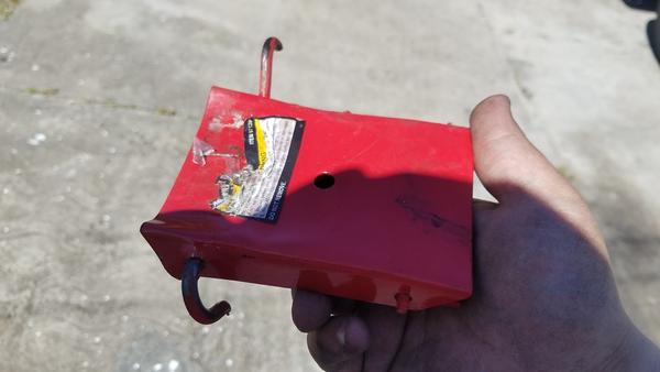

Destroyed one of my little fold-able wheel chocks, he will be missed

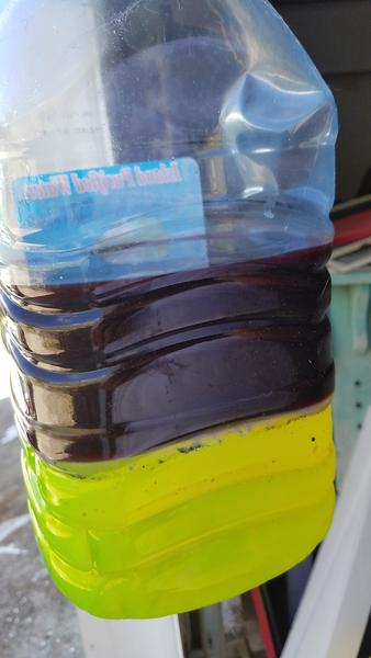

And lastly I learned the density of transmission fluid is less than a 50/50 mixture of ethylene glycol. Now that I think about it I guess it is basically an oil.

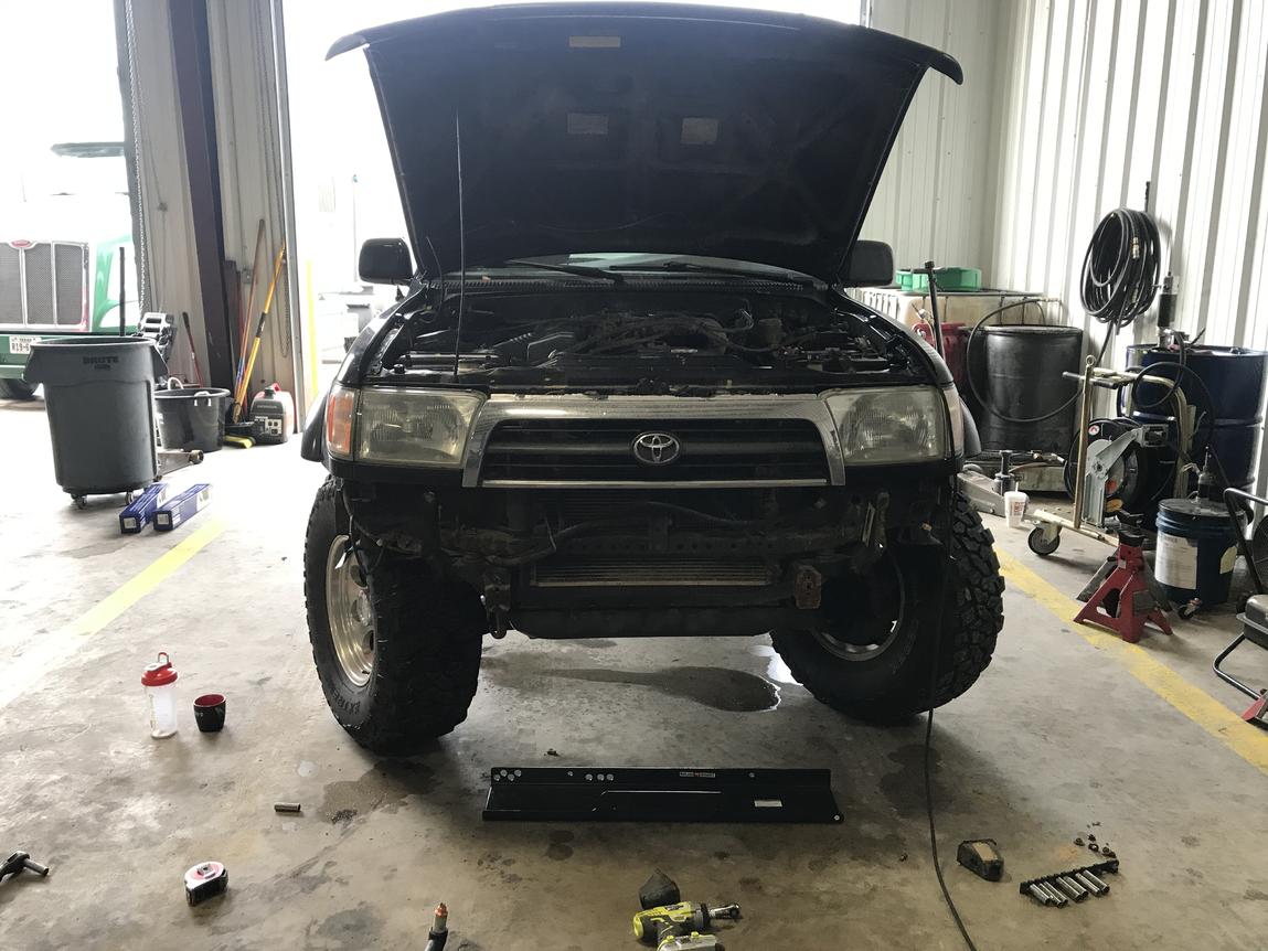

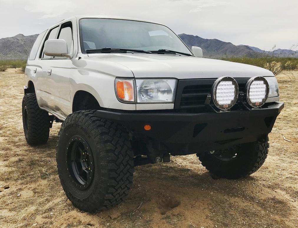

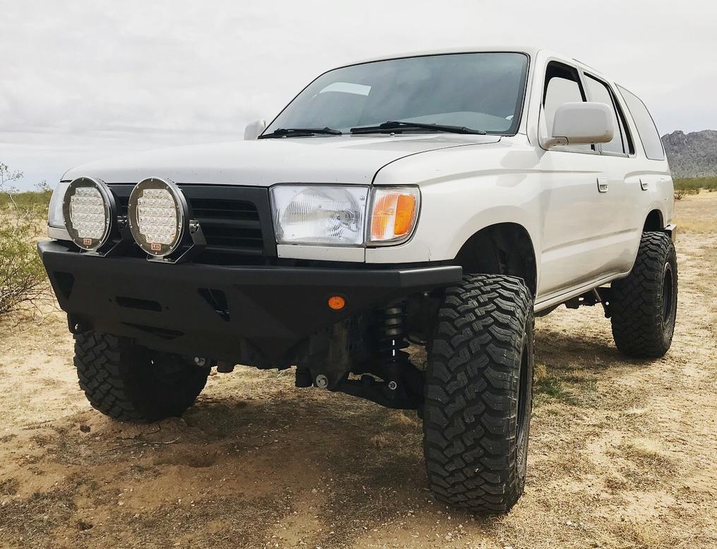

Haven't been on here in awhile. Finished up my CBI DIY Tacoma Bumper. Threw some cheap LEDs on for good measure. I don't know if I'll keep them for too long. I think I'd like some Squadron Sports. Next up is a winch and some amber dust/fogs...and sliders.
Do ya get tons of rocks thrown up chipping the paint with no fender flares and wheels sticking out? I'm putting Limited flares on cause it drives me nuts
Every once in awhile I'll hear a rock fly up and clunk but haven't noticed anything specifically from rocks flying up. It's not totally apparent in the photos but my truck has its fair share of chips and scratches from tight trails and what not. I don't totally neglect it but i'm past the point of caring too much about the paint.

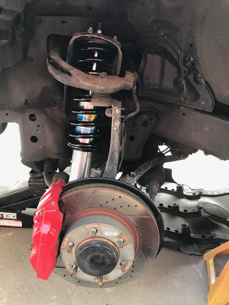

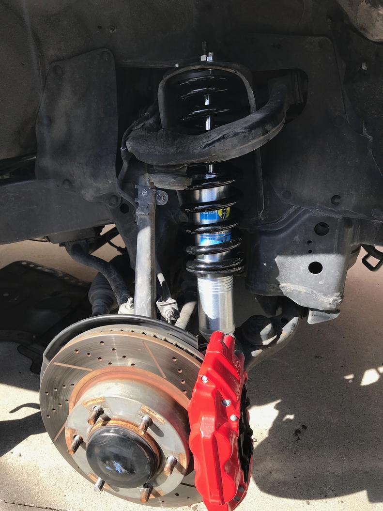

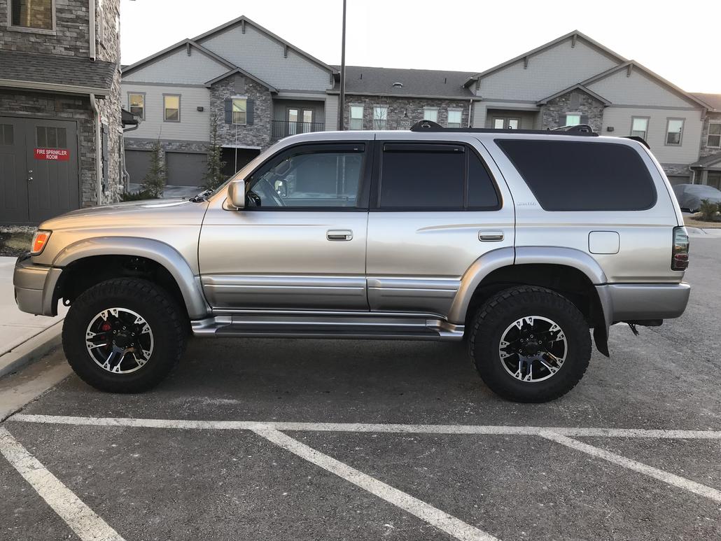

Installed my Bilstein 6112's on 2.3" setting.

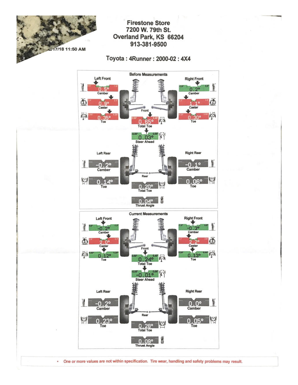

Got my alignment done after installing the 6112's. Had tires balanced and rotated for the first time after buying the truck.
Caster is still off but I'm good with what they were able to do with it until I get aftermarket UCA's.

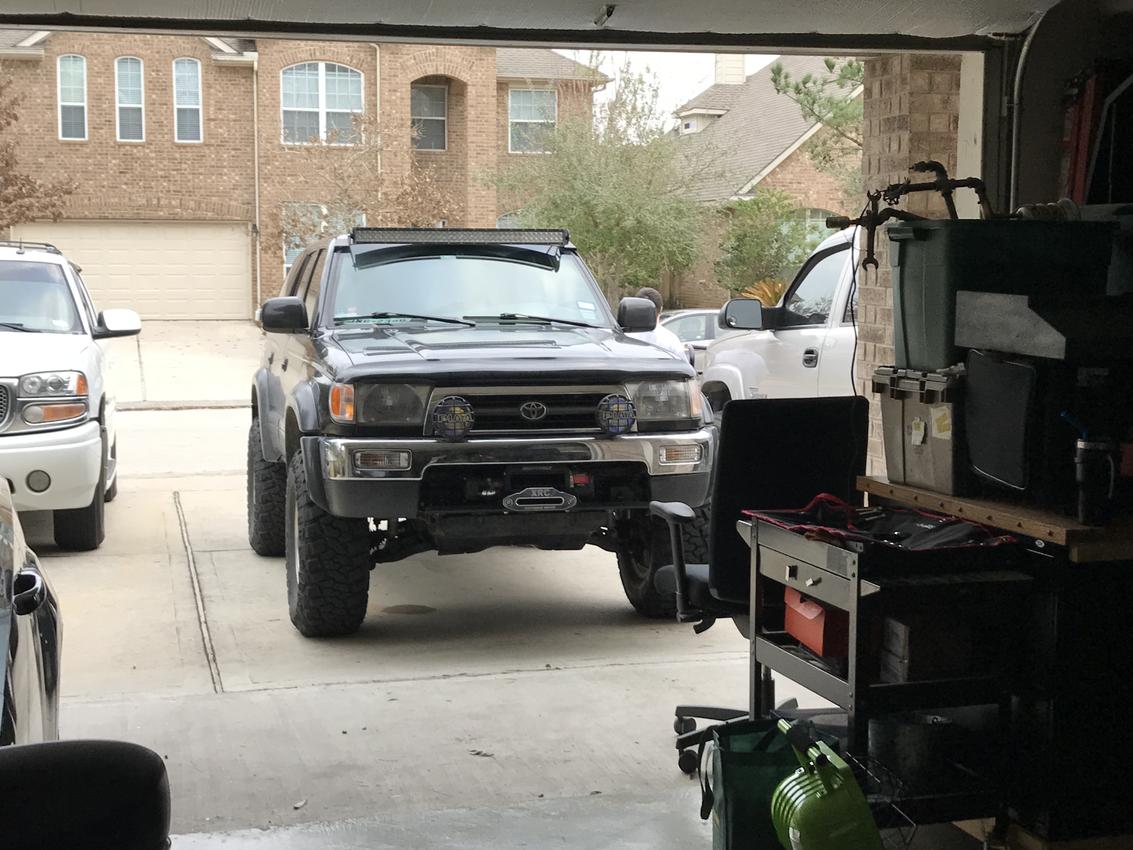

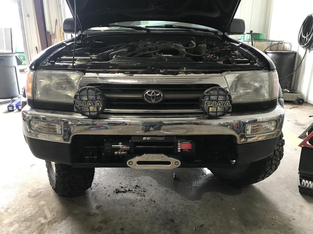

Got the custom mounted winch plate/winch on! Still need to wire it up and spool the rope though.
