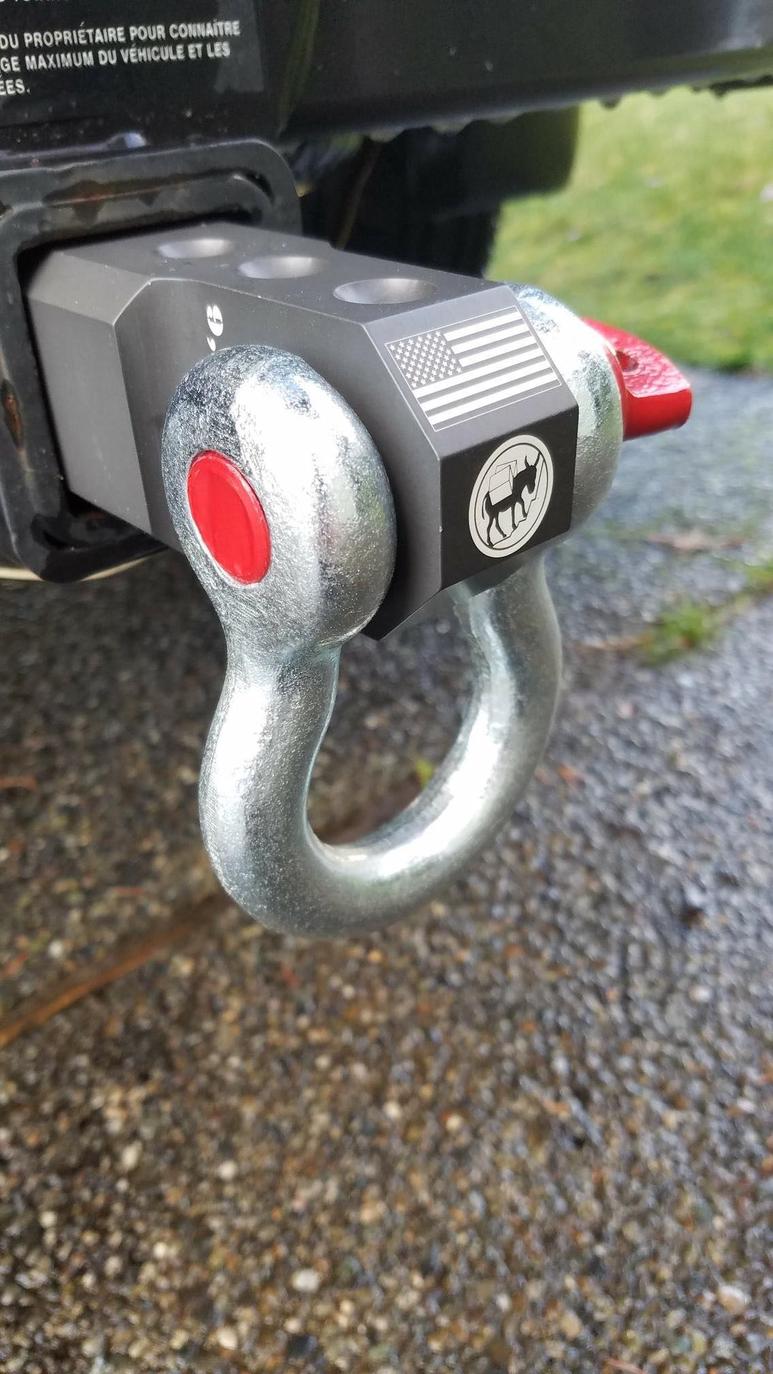

Gave her a much needed mid-winter wash and picked up some new recovery gear from my local shop.

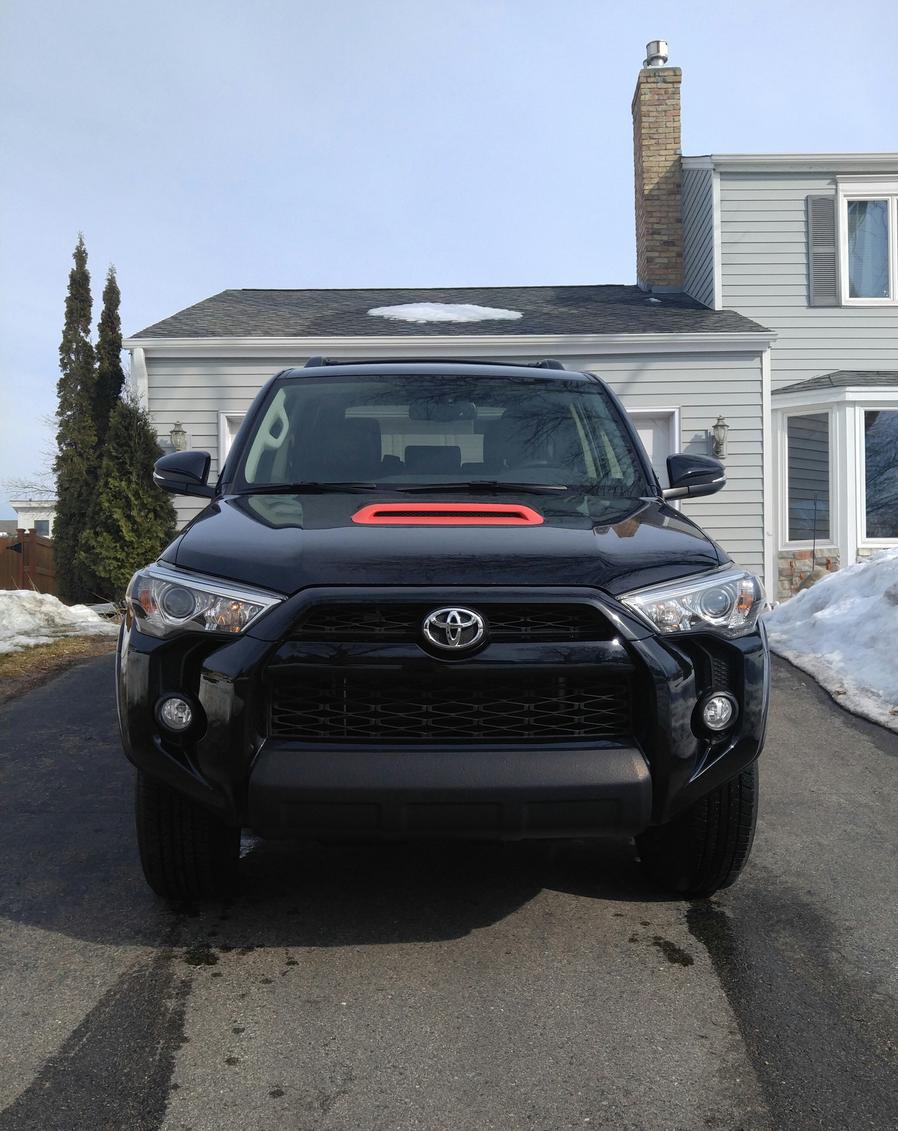

Dipped my front bumper from the ORP grey to a textured black and turned my hood scoop red. Super pleased with how it turned out.

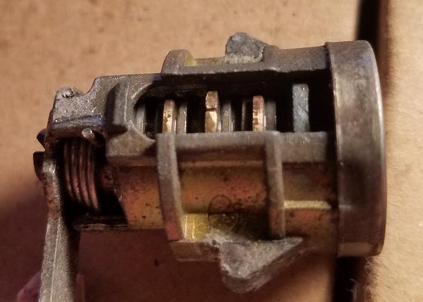

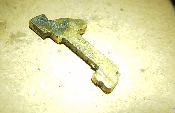

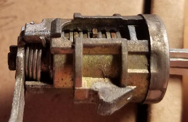

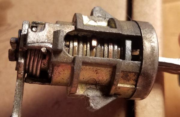

My driver side door lock decided it was done turning. I took it apart to investigate why and found a split wafer refusing to retract on one side. I tried some silicone spray to no avail. Ive already been to locksmith for new keys in November (He also sprayed some lock grease into the lock cylinder then) so I decided to just remove it. Problem solved, took about an hour from disassembly to reassembly.

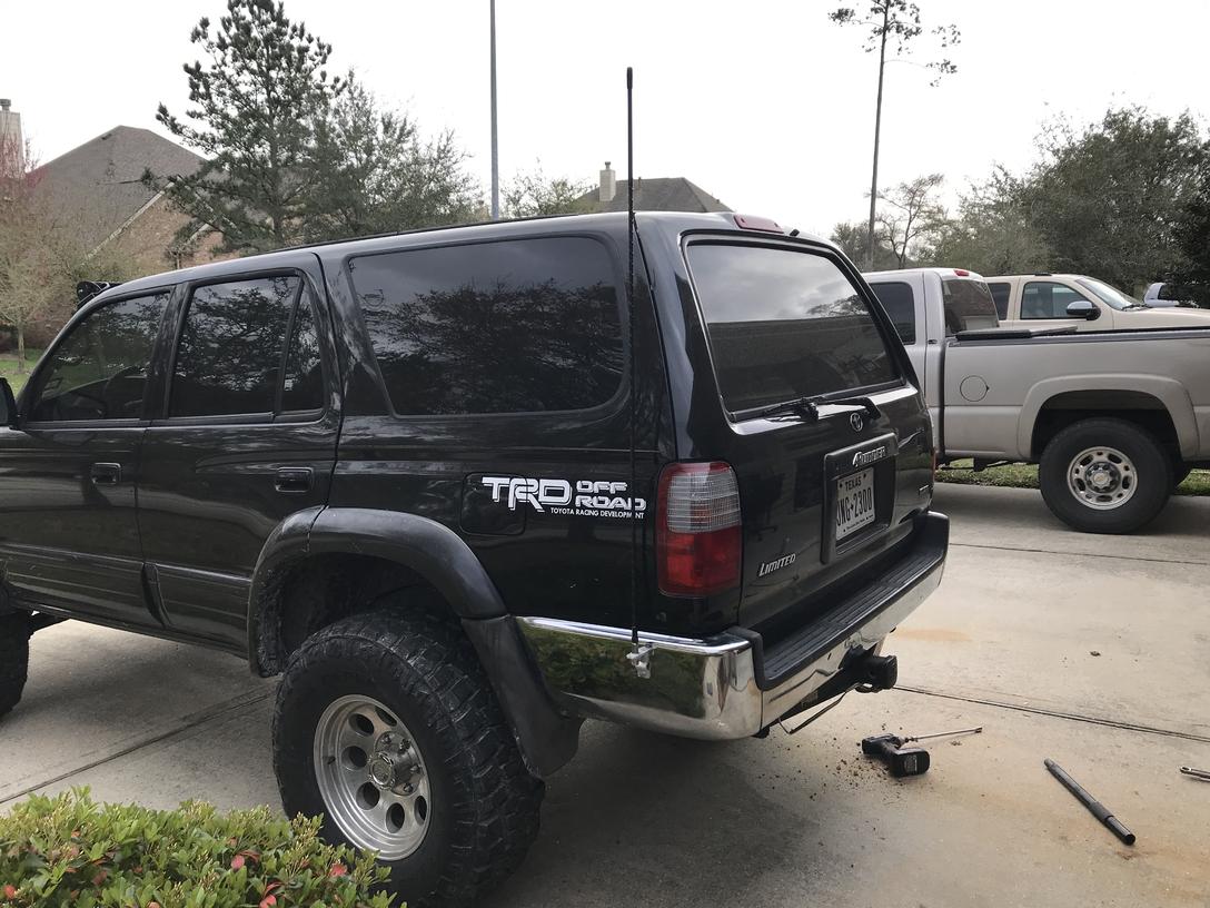

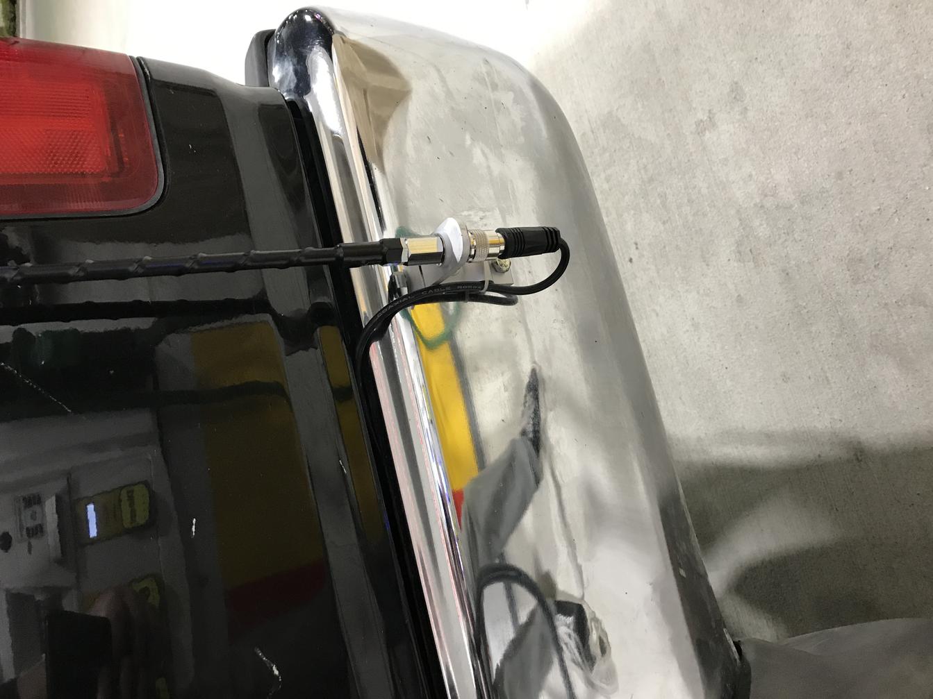

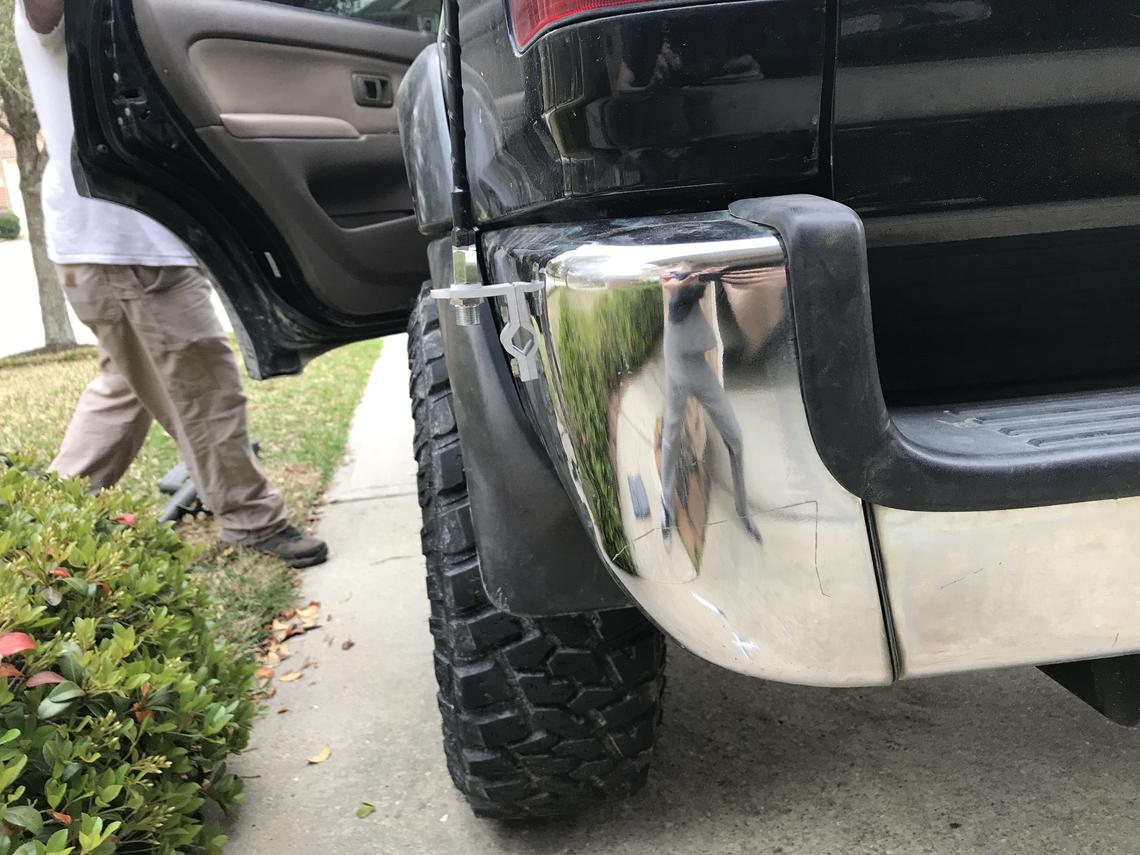

Removed the bumper to bang out the rather larger dent that was on the drivers side piece and installed my CB antenna mast.
The flare is not touching the bumper because it is torn. I really need to get a new one...
