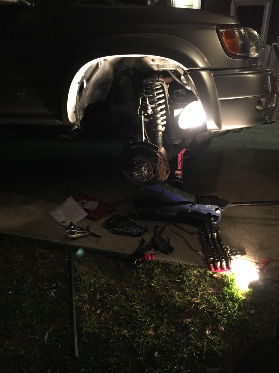

Spent 3+ hours trying to install new 5100/OME front shocks on the 99 this weekend to no avail. I can't get the LCA down far enough to allow the top hat on the new spring to fit in. I also don't think the Duralast top hat is the same size (measures ~1/8th inch bigger than OEM) so that isn't helping the situation. Tried loosening the UCA bolt, disconnected the LBJ/sway bar and used weight/leverage with a long crow bar.
Now looking at completely dropping the LCA, taking the time to do new bushings and installing the shocks at that time. On the fence about just doing new UCAs while I am at it too.
Thoughts? I didn't think this install would be such a damn hassle.

You can loosen the LCA cam bolts and that should give you the ability to put the strut in. Then you need to take it in immediately for an alignment. Unless you know how to do a string alignment. Or you can go all the way and do new bushings.

I feel your pain, after breaking a pair of spring compressors from autozone. Scariest thing to happen, luckily no injuries. My brother and I went with the NO spring compressor way. We had both in within 45 minutes. Youll need another person to help.

I used the ol bottle jack trick to get mine in.
Two weeks ago...replaced both front wheel bearings and a new hub on passenger side.

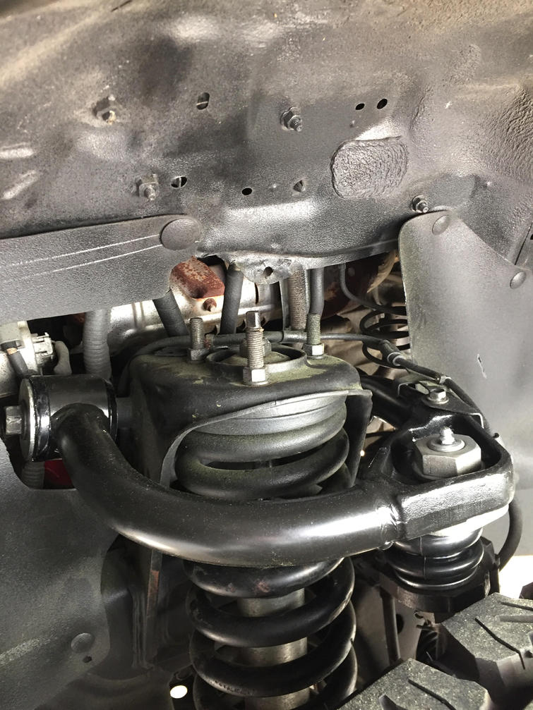

This past weekend, installed SPC upper control arms so I could get the camber back within spec.

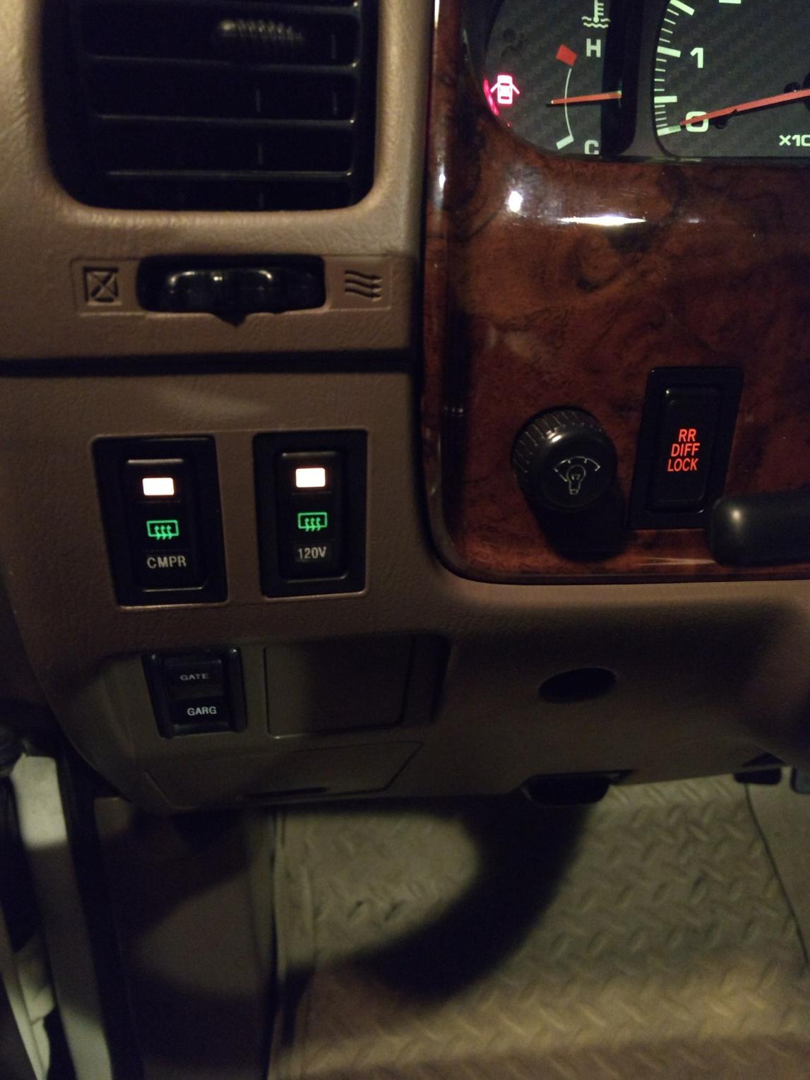

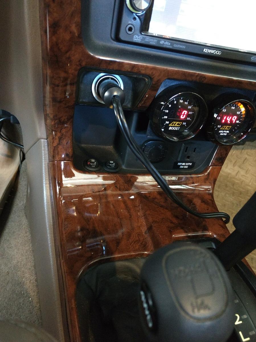

Also rewired my compressor for my Airlift and added a 120V outlet and power button (using 2nd gen buttons).

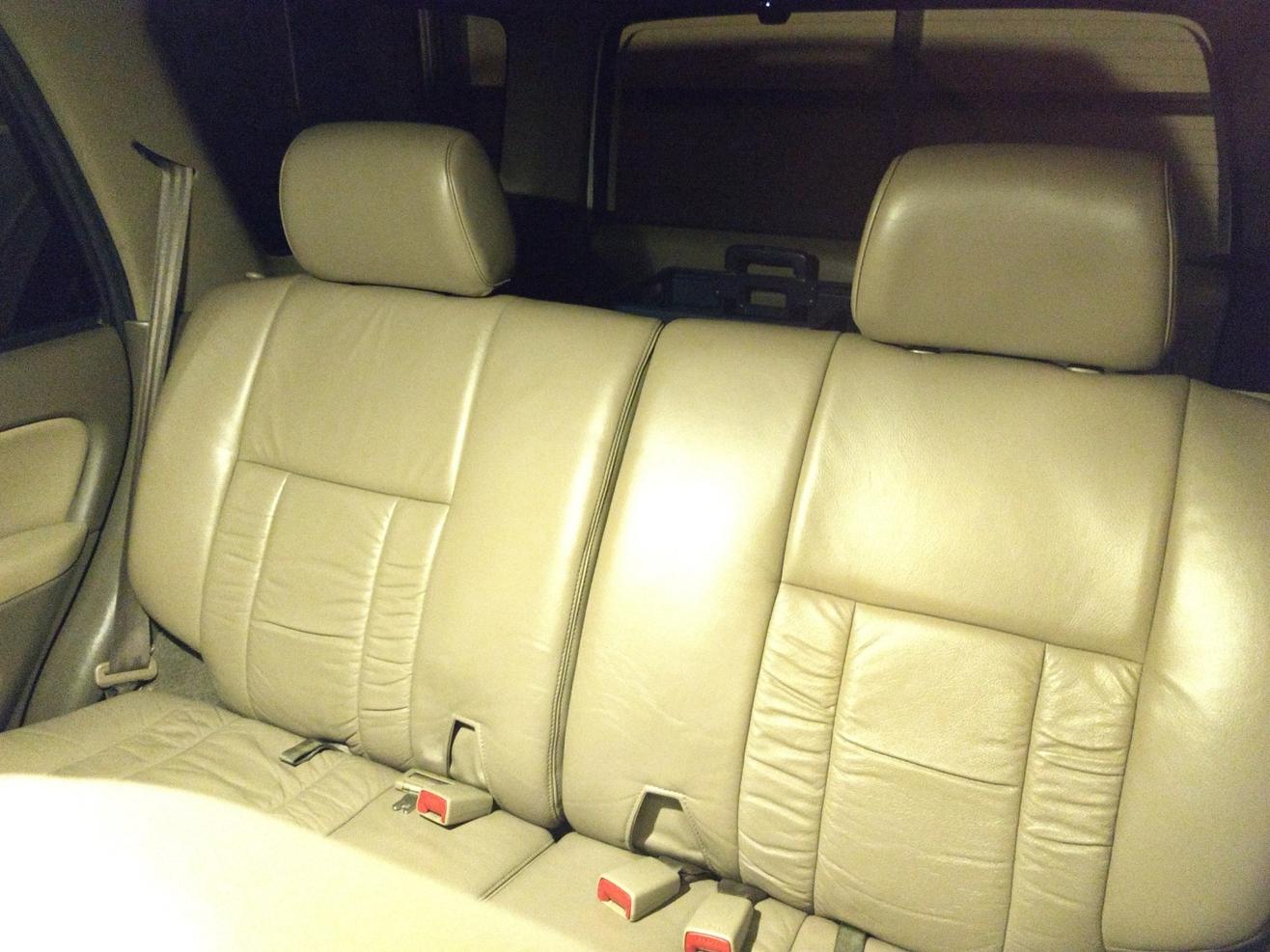

I also found mint condition 2nd gen front oak leather headrests which worked great for the rear (they tilt forward, which is nice as a headrest).

Wired up a light for the Rear Diff locker switch.

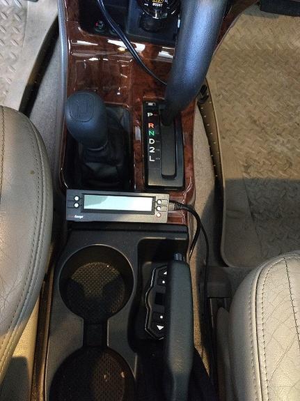

Also, rewired a 2nd gen window button to control my garage remote and moved my scangauge to the shifter console since I needed the area it was in for the new buttons.
.[/QUOTE]
Can you elaborate and post pics of this please? Thanks
Sent from my iPhone using Tapatalk[/QUOTE]
Sorry, I should have taken pics and done a DIY. But long story short, I figured out which pin was common on the window switch and wired that up to the common + on the remote buttons. Then I soldered a wire to the button's shorting pin and connected that to the top or bottom engagement pins. I have two remotes, so it was important that I wired both up correctly using the common + so it wouldn't cause a short in the remotes. It'd be much simpler if you only have one remote though.
