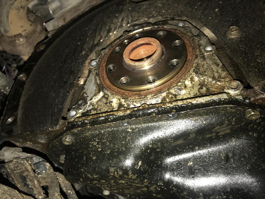

Started tearing her apart today at the dealer for the rear main seal job I'm doing. Also gonna be replacing the rear companion flange seal for the tcase while I'm in there.

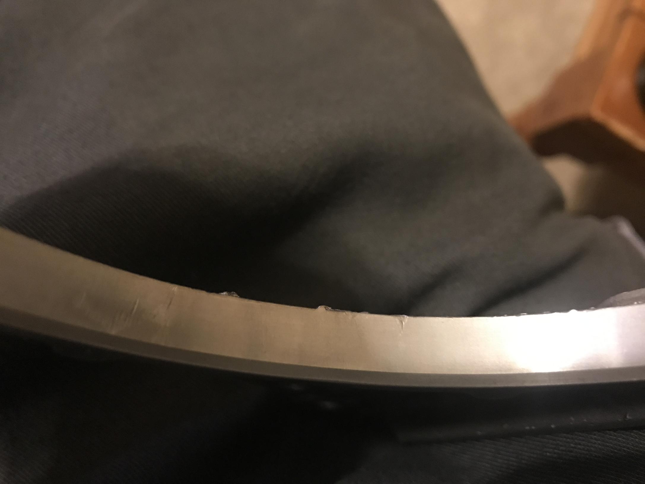

Separated the tranny from the engine and pulled the old rear main out. Was super lucky to be able to remove the snapped bolt on the lower right corner for it as not much was sticking out from the block. Needle nose vice grips came to the rescue here for sure. Also retapped one of the oil pan bolts that go into the retainer plate as the threads were basically gone from it.
Looking at the retainer now, there appears to be some very minor burrs where the seal sits in it. Doesn't look to be a problem and really don't want to wait for a new part to show up so I'm going to either a) not worry about it and just install it or b) put a very thin layer of FIPG around the circumference of the bore then install the seal. Thoughts on this?
