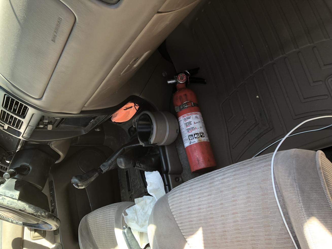

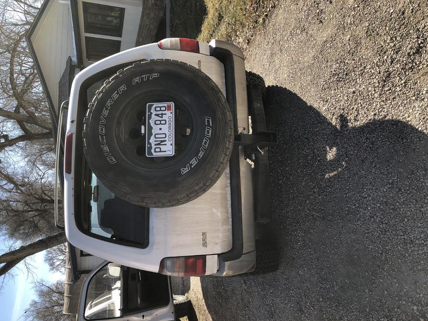

Fabricated a license plate relocation mount for my spare tire carrier, did the ISR mod just to get some more throttle response (I think it accomplished that) and finally got around to mounting my fire extinguisher

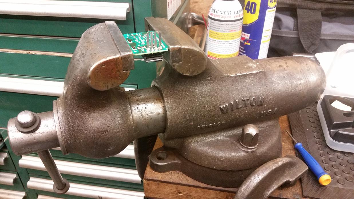

Limited to clock repair today. I'm sans an appendix as of Wednesday so the winter/summer tire swap lifting won't happen for 10 more days...
Cool on the clock repair, are you re-flowing the (I think, large square solders) resistors too?

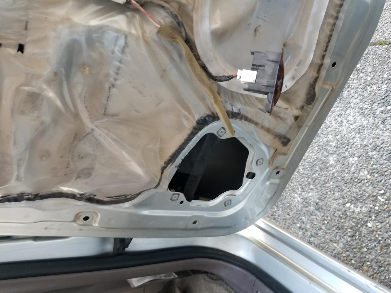

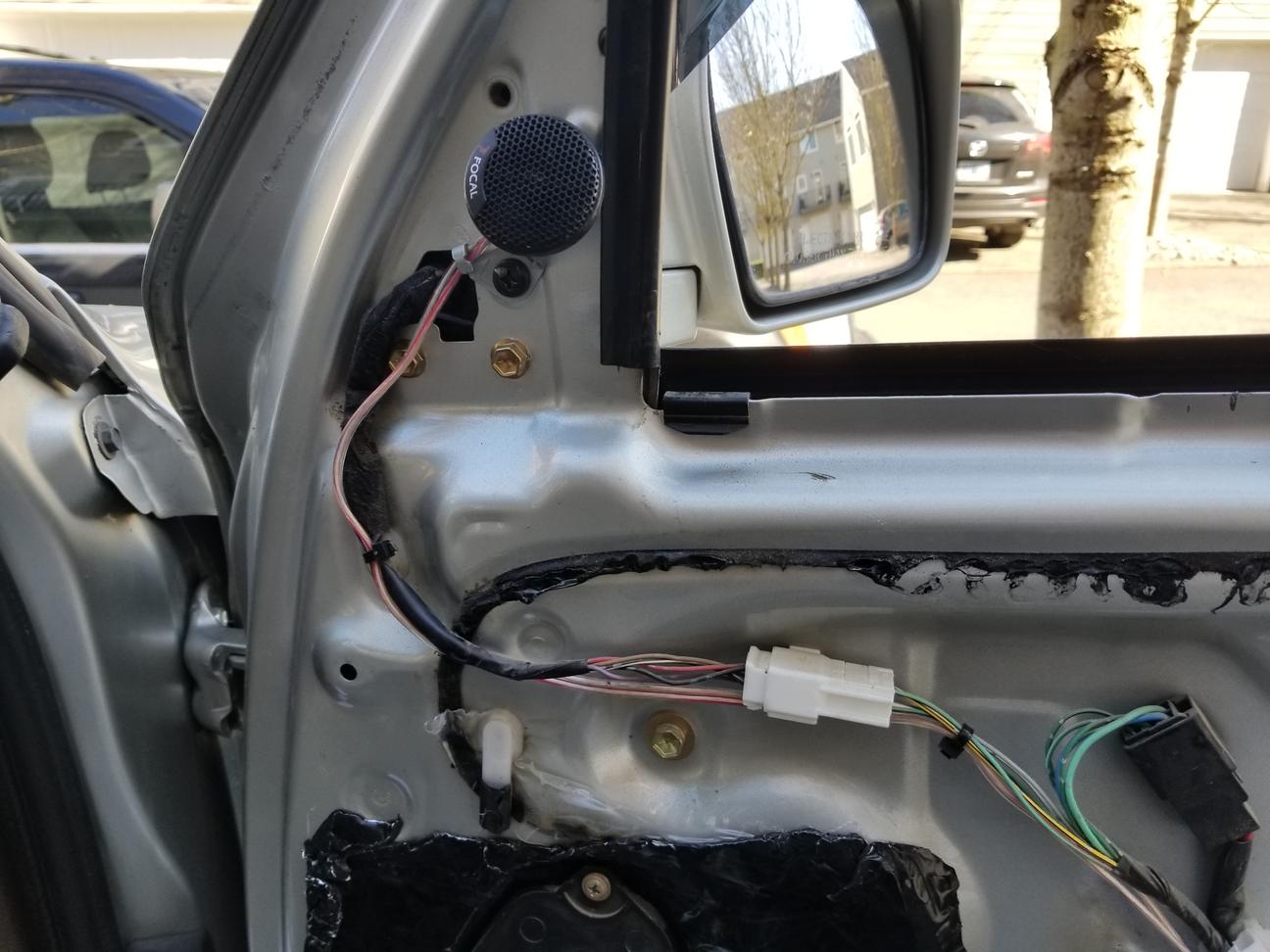

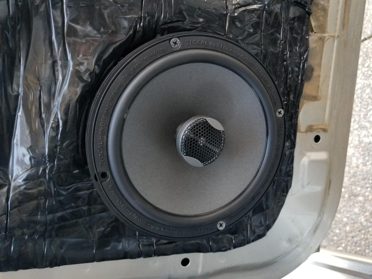

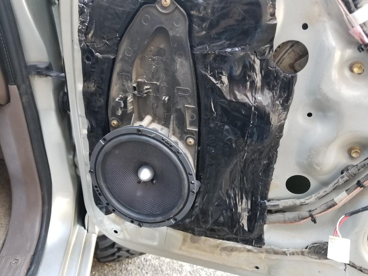

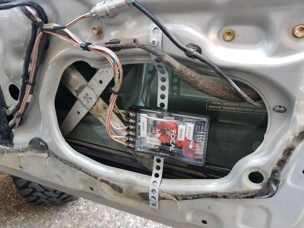

I replaced all those awesome paper speakers with some focal component speakers in the front and focals in the rear also.

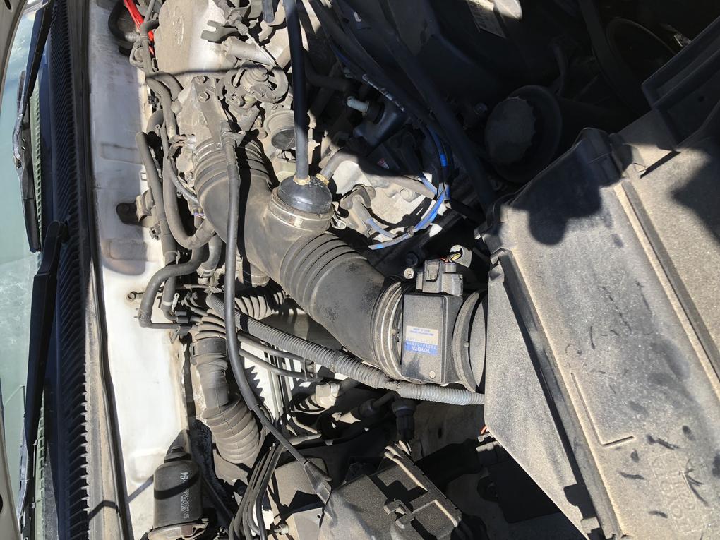

Attempted to clean the MAF, but ran into the "18 years of the elements have turned the MAF screws into mush so I stripped the crap out of them and can't get them off" problem that people seem to have...so once I can figure out how to get those suckers out of there, I'll tackle that.
I followed the advice of others and removed the whole airbox and slotted the stuck screw with a dremel cut-off disk. Then I replaced both screws with M4x0.7x12mm SHCS with lock washers. In case you don't speak screw language, that's a Socket Head Cap Screw, size: M4, thread pitch: 0.7mm, length: 12mm (anything from 10-16mm should fit)
I'm curious how the front tweeter cover fits? It looks like the Focal tweets are larger than the stock ones by about .25" I'm in the process of putting in a new head unit (pioneer AVH-2330) and would like to match it with some quality speakers.
thanks for any input
There is a bracket that you hot glue the tweeters to and they fit perfect behind the little grill thing.
