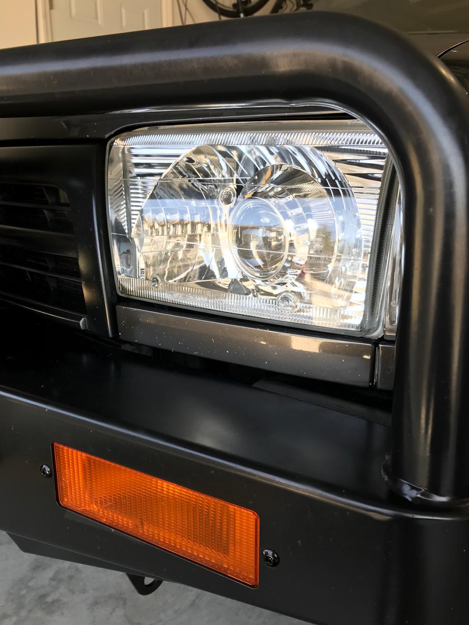

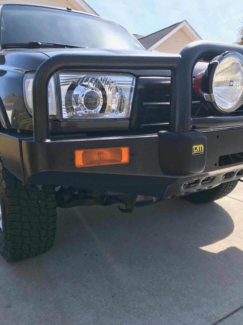

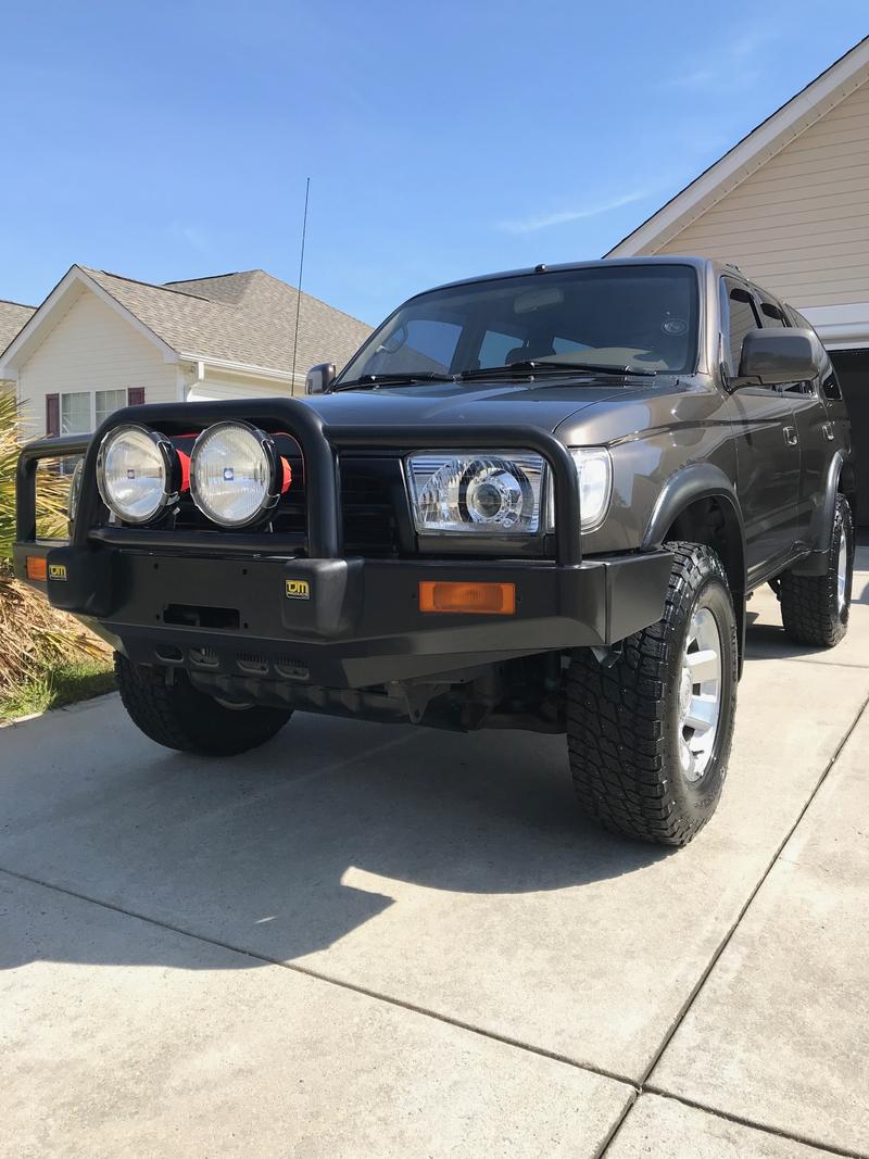

Ahhhhh......now I can finally see........:lightsaber:
