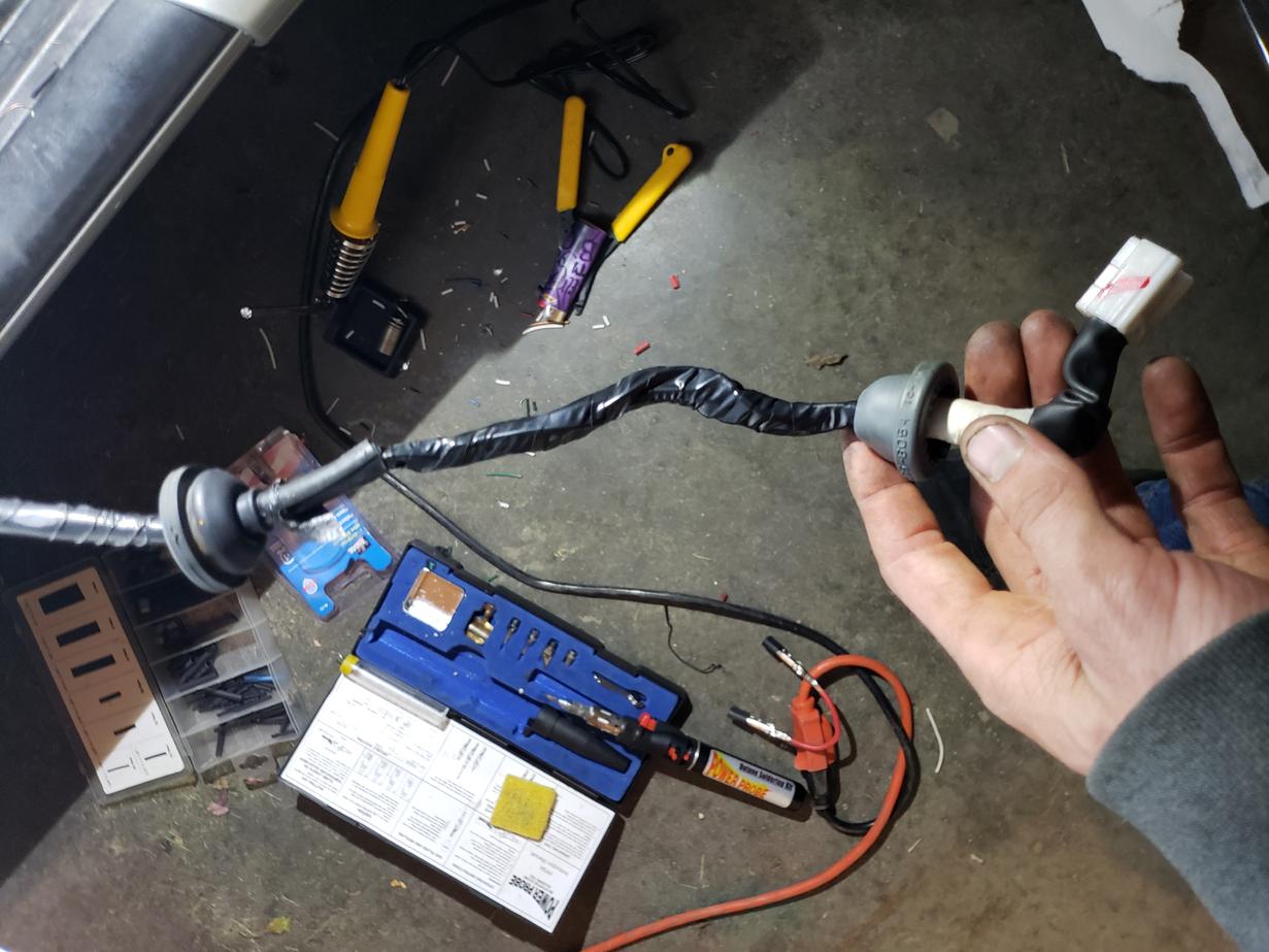

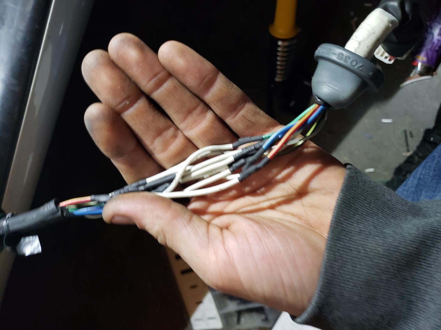

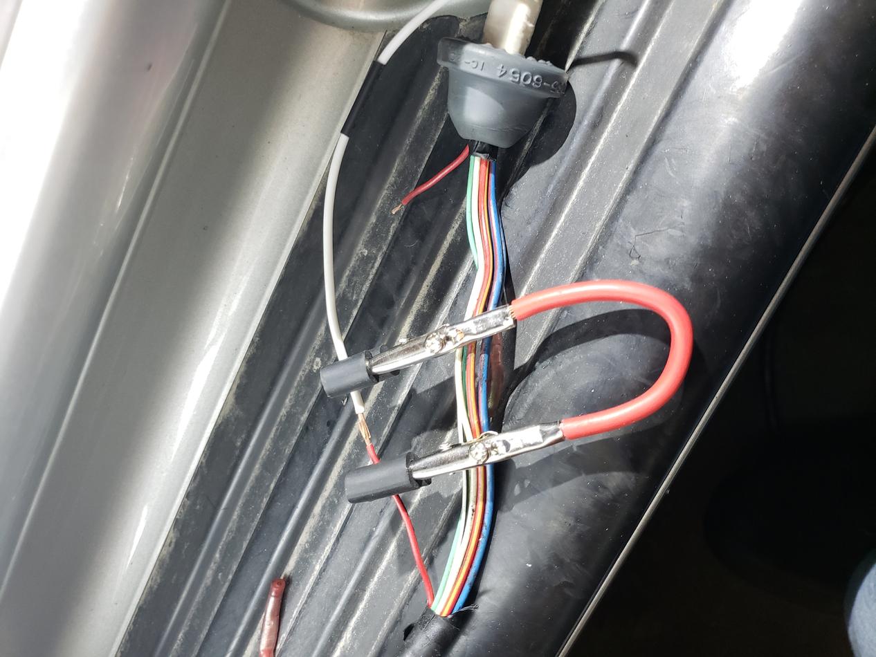

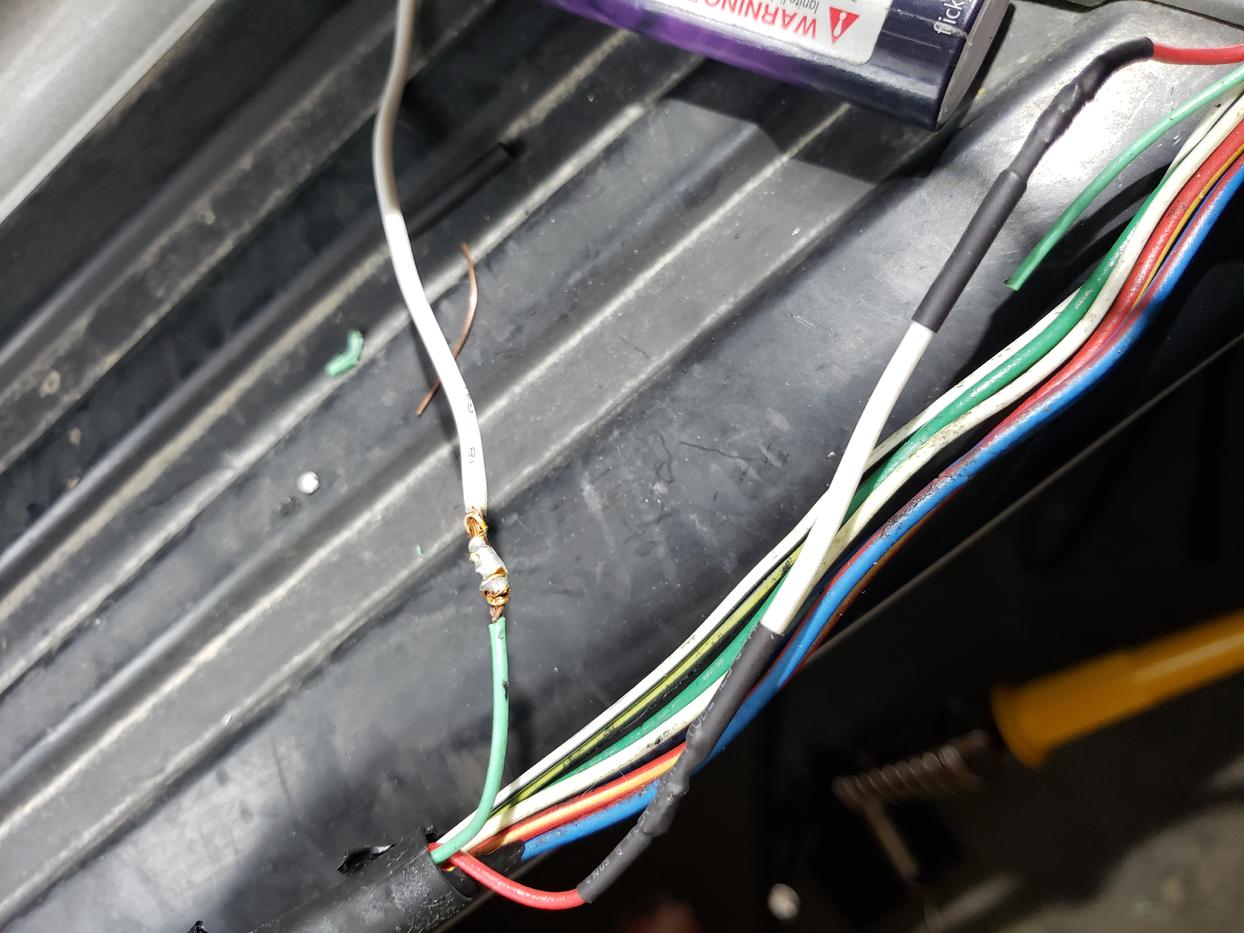

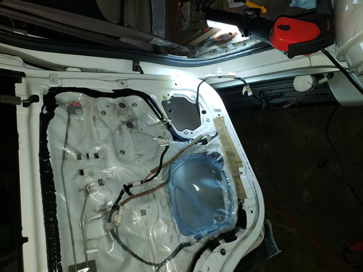

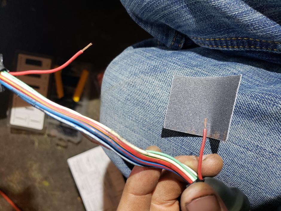

Door Jamb Wire Repair
Noticed my LR speaker stopped working. And sure enough upon inspecting to wires between body and door itself revealed all 9 of the wires cracked and two for speaker broken. Got the panel off and a few other trim pieces so I could unplug the door harness and pull it through speaker hole. Worked out well! Glad I chose to solder and heat shrink vs butt connectors! Happy with end result! Also happy to be done soldering all 18 of those joints! (First 2 pictures are me removing corrosion from factory wires using vinegar and some Emery cloth, after that solder stuck much better!)
