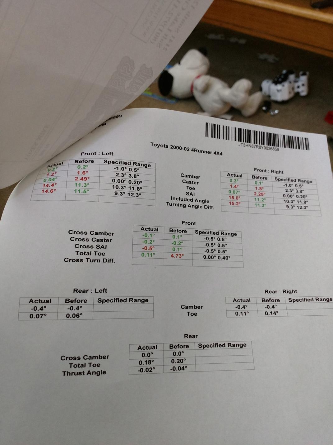

Got an alignment. Sketchy as hell driving it to the shop after all new ball joints and tie rod ends went in.

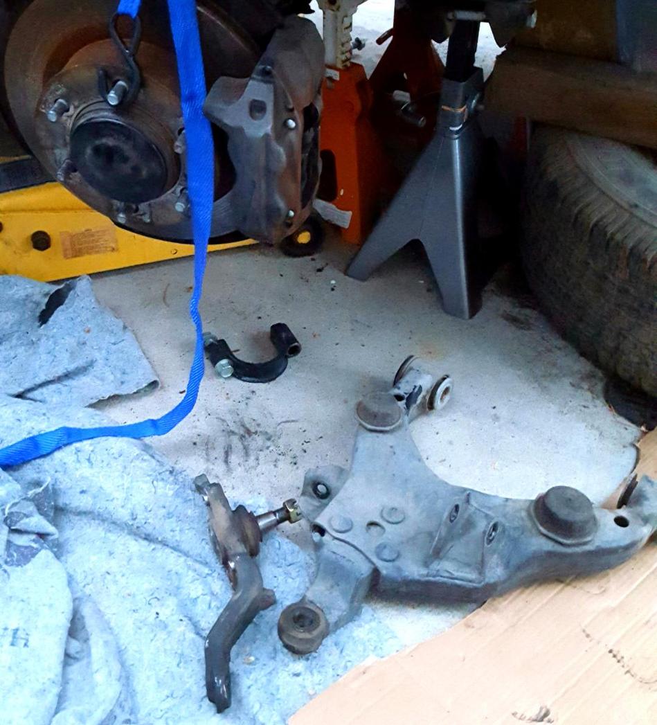

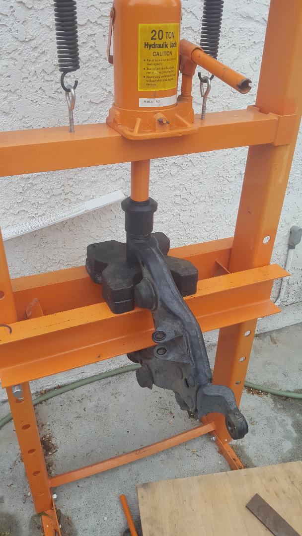

I started on the front end, doing the works, the whole shabang; bushings, ball joints, tie rods, etc.
Timmy's videos make it pretty easy. Thanks again Tim ! I do one side at a time so I can see how to put it back together...just in case.

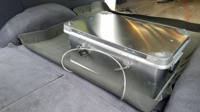

Yesterday I picked up a SwissLink box and installed a tie down for it. Details in my build thread.
Today I rotated the tires.

Wtf!
They call that an alignment? how did it drive after? Your caster is way off specs. I would raise the caster to get that truck straight and better steering return.
What I don't get is why did the SAI and IA change before and after? All they did was a toe set.
Bushings?
What bushings did you use for the control arms, I'm due since I'm over 300k.

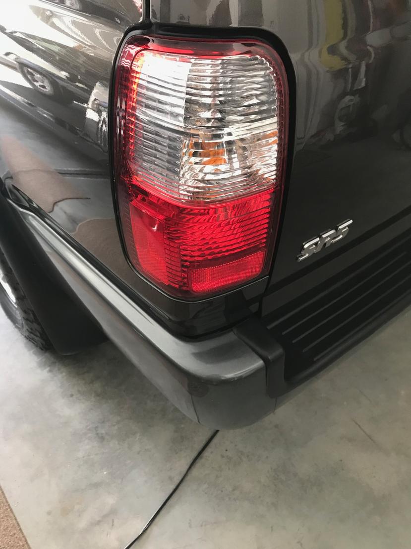

Scored and saved from the crusher - a minty set of 2002 tail lamps!! Replaced the old style. New Zevo LED bulbs throughout / new LED relay / no warning lights, no hyper-flash.... :party:
lol right? Susie needs to take that back and raise hell.
'Set the toe and let it go" That's all the big chain tire stores are capable of doing and when you return to complain about how bad the vehicle steers they will blame every other component on the vehicle as being the problem- not their lack of ability to properly fix something.

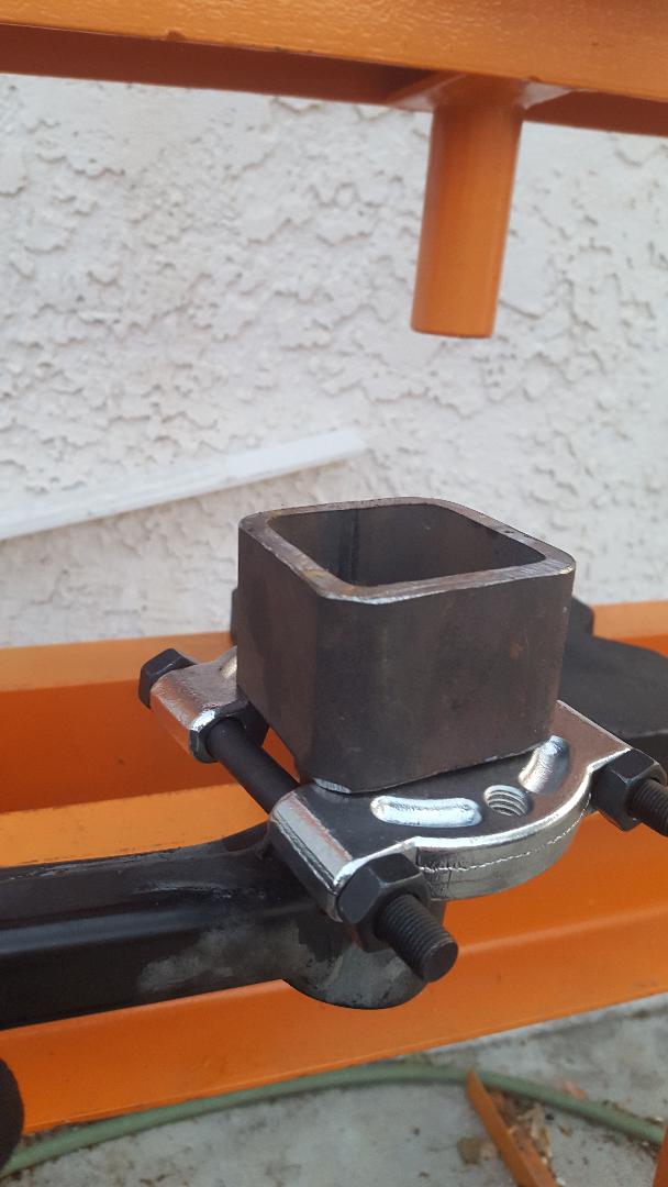

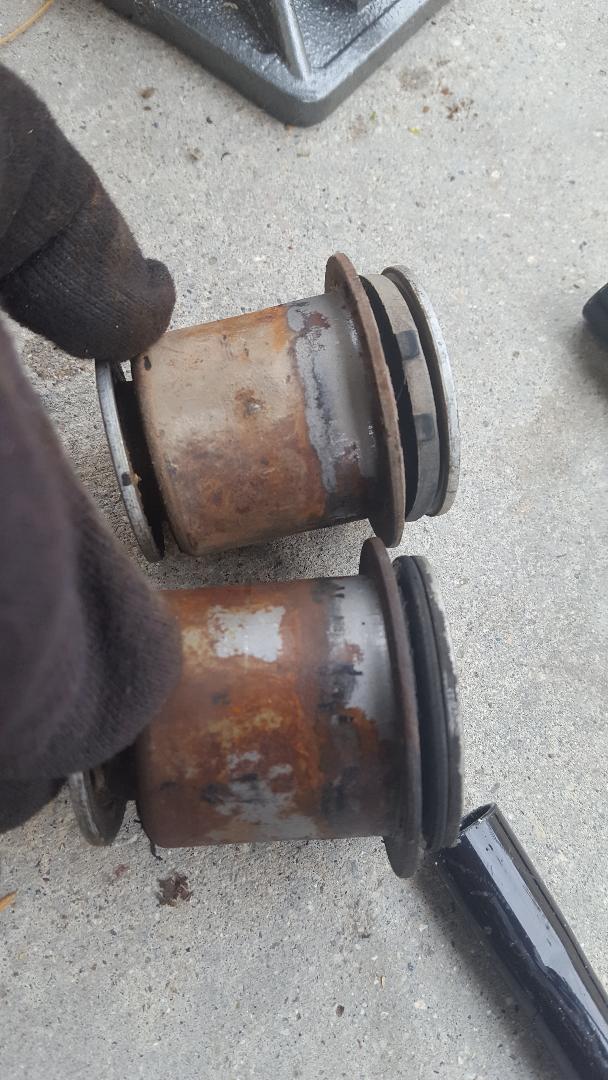

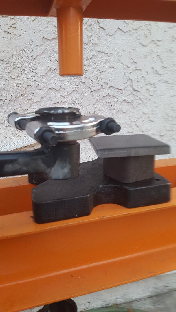

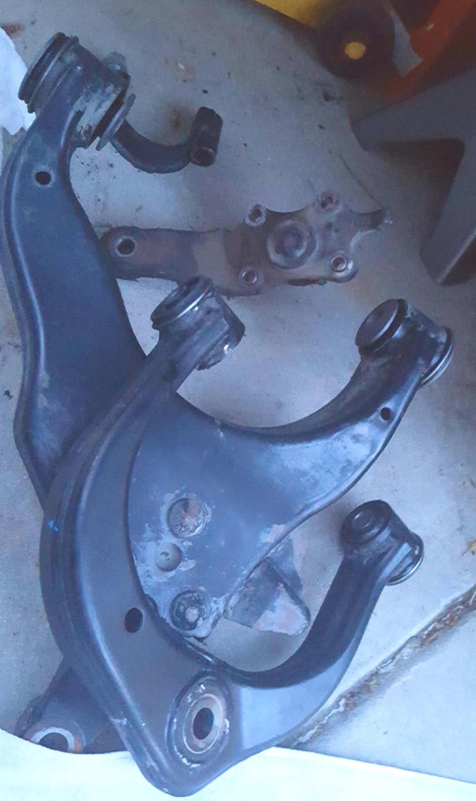

Old lower bushings out,
new lower bushings in.
Old upper bushings out, new upper bushings in.
The happy couple !
Drives straight... And was a reputable shop... I'd better bring these concerns up with the husband, cause I really don't know shiiit about it. Could the suspension lift have anything to do with being off spec?

Be calm Susie
There is no reason to raise hell just ask a question why the caster is still out of specs. did they ran out of adjustment due to the lift? I suggest check you tube about SAI and AI. they can explain it better than I do.
