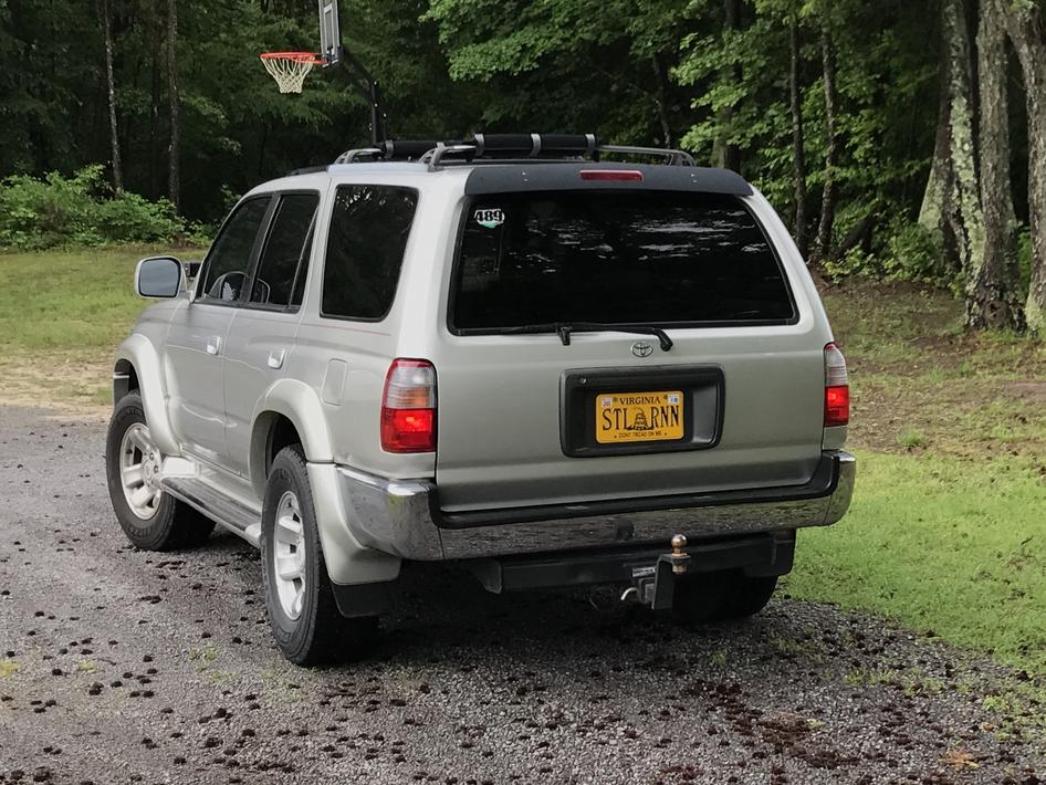

Got a stock spoiler back on and debadged the hatch. Man these things look so much better with the spoiler on.

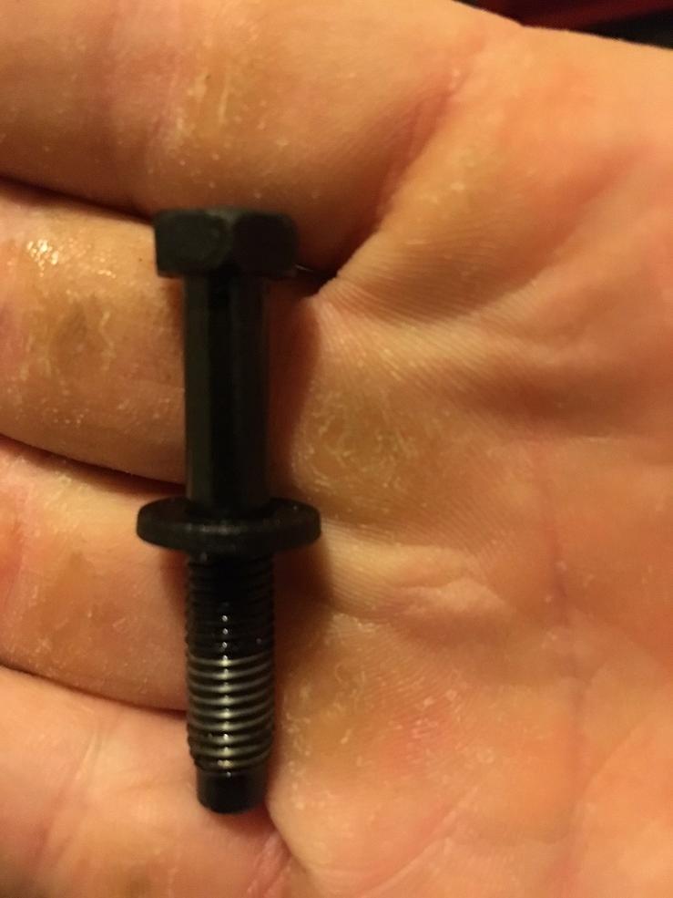

what I did today: bolt search from hell!
What I've done today is trying to find new bolts for the rear cam plug seal (I think that is what it's called?)
I know this: they are 10mm heads, and they look like this (pic attached). I can't find a part number. I tried, and I've ordered the wrong bolts twice - and now finding out they've been discontinued or so I'm told.
Does ANYONE know where to find some new bolts for this sucker? I just want to finish this valve cover job and drive this dang thing, lol.
Thanks for any and all help.

IJunkyard may be a source. This may help:
https://www.tacomaworld.com/threads/stripped-threads-in-camshaft-end-plug-seal-retainer-cap.422146/
The FSM says to put engine oil on the threads and torque 144 inch lbs (12 ft lbs)
Camelback has this part listed. It is called a bearing cap bolt:
https://parts.camelbacktoyota.com/parts/2000/Toyota/4Runner/SR5/index.cfm?siteid=214329
I did my gaskets last weekend and I am glad I did not run into any stripped bolts. Good luck.
