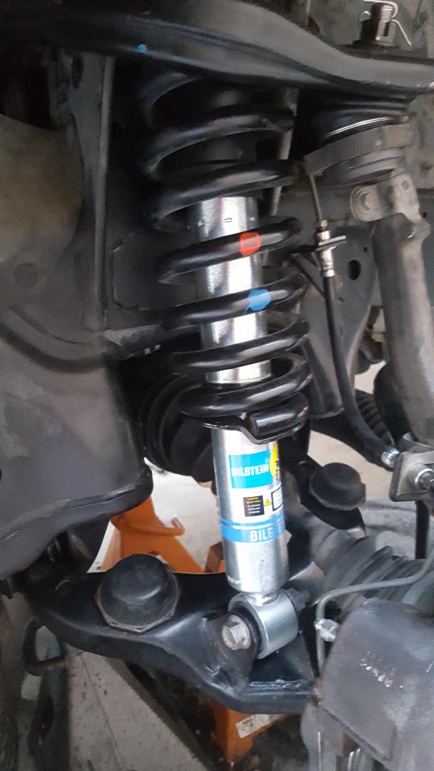

Completed a whole new front end(all ball joints, bushings, tie rod ends) by getting the new shocks and brakes hoses in. Just need someone to pump the brakes and the tires will go back on.
You gotta try the plastic orange juice bottle one man bleeder setup I made.
I'm sure you've seen the 2-3 oz bottle bleeder kits, same principle using 32 oz bottle. Use soft tubing that fits bleeder valve nipple, RTV to seal to bottle cap.
Hook it up pump till you run out of air, or you put air in by running rez dry.
