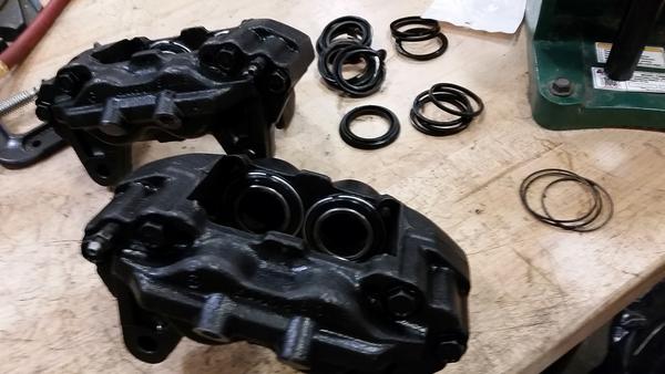

I spent probably too much time trying to refub a set of WE calipers today. I snagged them last week for $16 each, they looked like they were on the main deck of the Titantic.
45 minutes for each one in a blast cabinet got them cleaned up pretty well, then I cleaned and spray bombed w/ a quick dry equipment paint in satin black, it's what I had on hand beside a white appliance epoxy paint.
Once the paint flashed over I tore them down and replaced the seals/dust boots. I found 1 piston that wasn't playing nice so I hit with a scotch brite pad to clean up some crud. The seal kit I used was a Centric brand from Rock Auto. It was rubbish, pure and simple. The dust boots are a different shape compared to the OE and the spring clip has very little lip to grab a hold of, I doubt that these dust boots will last very long. I might postpone using the calipers and just find a Toyota seal kit.

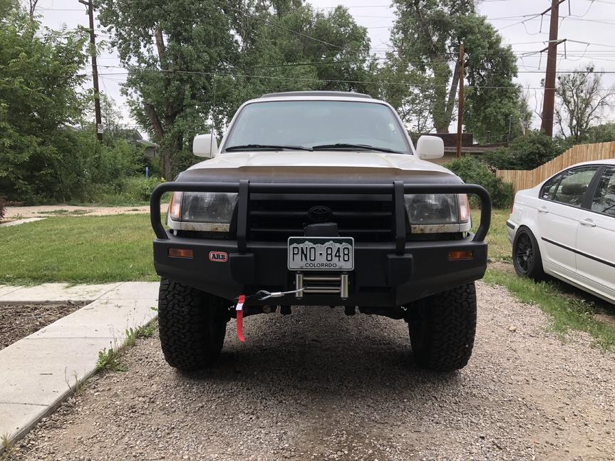

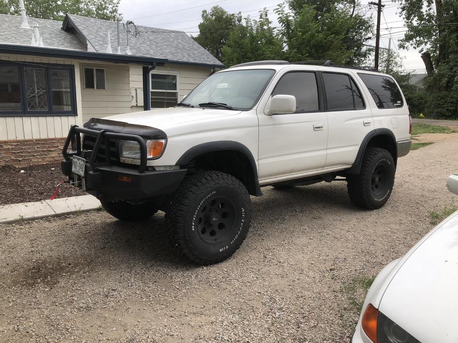

Finally got a chance to install the arb bumper and winch that have been sitting in my garage for the past 6 weeks. What a pain to do solo! Can't decide if I want to do anything about the gap from the body lift or not
Did you reclocking your winch to make reaching the freespool handle easier to access?
Looks awesome!
I just bought my first 4R(2002 LTD), and an ARB Bull Bar bumper/Warn winch will be my first mod.
ETA: How did the body lift cause the gap?
