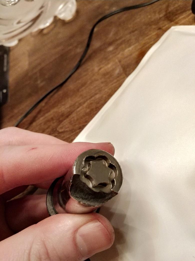

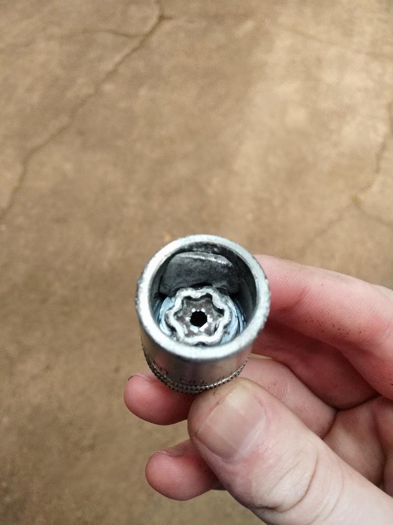

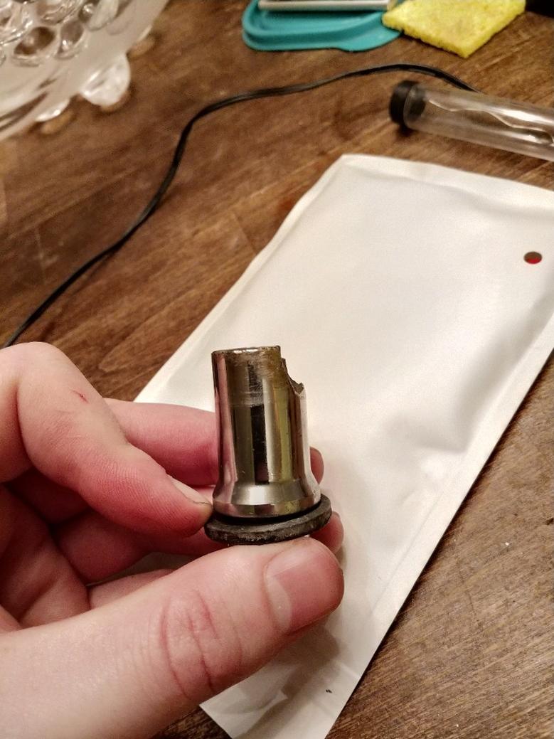

Flat tire+extra tight lug nuts via dealership+awkward OEM wrench+suspect wheel locks = a easy spare swap turning into 48hrs of excessive cursing and struggling to get a broken wheel lock off, bumming rides to tool stores and questioning my general sanity.
In the end, it took banging the lock key with a hammer to dislodge the broken shard (which refused prying, cutting, drilling), hammering key onto the broken lock and with a final Clark Griswold Christmas Vacation-level push, forcing it free. Thankfully tire was patchable. Ordered replacement lug nuts; these locks are going in the dumpster!!!:frusty:
