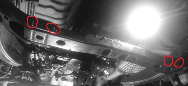

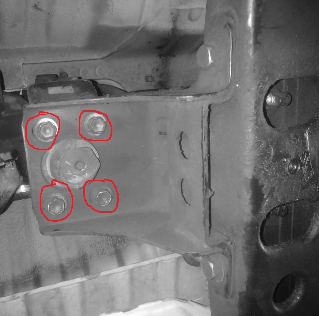

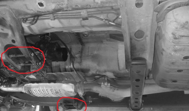

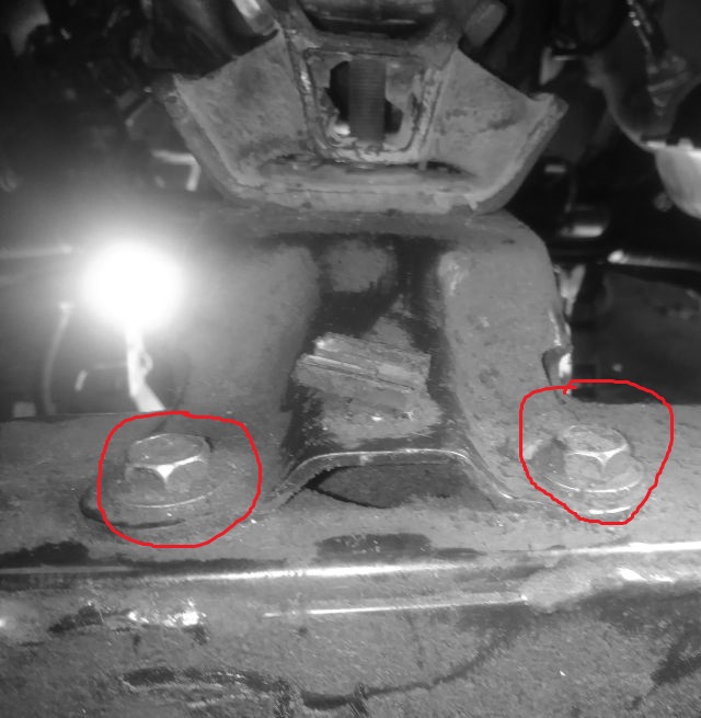

It seems I have three choices, all of which are four bolts.
Either I can remove the entire crossmember, or the center transmission bracket to the crossmember or just the transmission from that bracket.
Any suggestion as to which is the way most people choose?
Just remove the whole crossmember. Don't be surprised if it rusty and really stuck on there. Oh and obviously you want your transmission jack in place and secure (with straps) before removing the crossmember.
Thanks for that advice as that is the last step before the transmission comes out, as everything else is out.
The choice is either the four bolts on the rear mount, or the four bolts on the rearmount bracket, or the four bolts on the entire crossmember.
See pictures below.
Also, do you locktite the clutch bolts when going back in? (What color?)
See pictures below.
Remove the 4 bolts up into the mount (first picture) and the four bolts/nuts into the crossmember (third picture). Make sure the transmission is supported before you remove the crossmember bolts (third picture ones). Looks like you have a 2WD! You'll have it a lot easier (by 100+ lbs) than most of us on here.
Yup. 2WD.
Thanks for letting me know that I should just remove the crossmember, where I followed your advice and first removed the four 12mm bolts on the transmission mount, and then I removed the 4 long 14mm bolts and nuts on the crossmember.

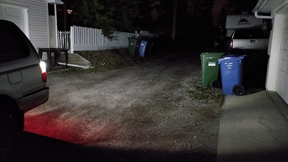

Switched the turn signals from the silly ones at the bottom of the bumper to the corners and replaced all the signal bulbs with LED's. The LED's caused hyperflash so bad that the lights wouldn't even shut off haha. For those interested, the Novita EP35 flasher relay fixes the hyperflashing with all LED bulbs.
The LED reverse lights I put in are brighter than my old headlights haha

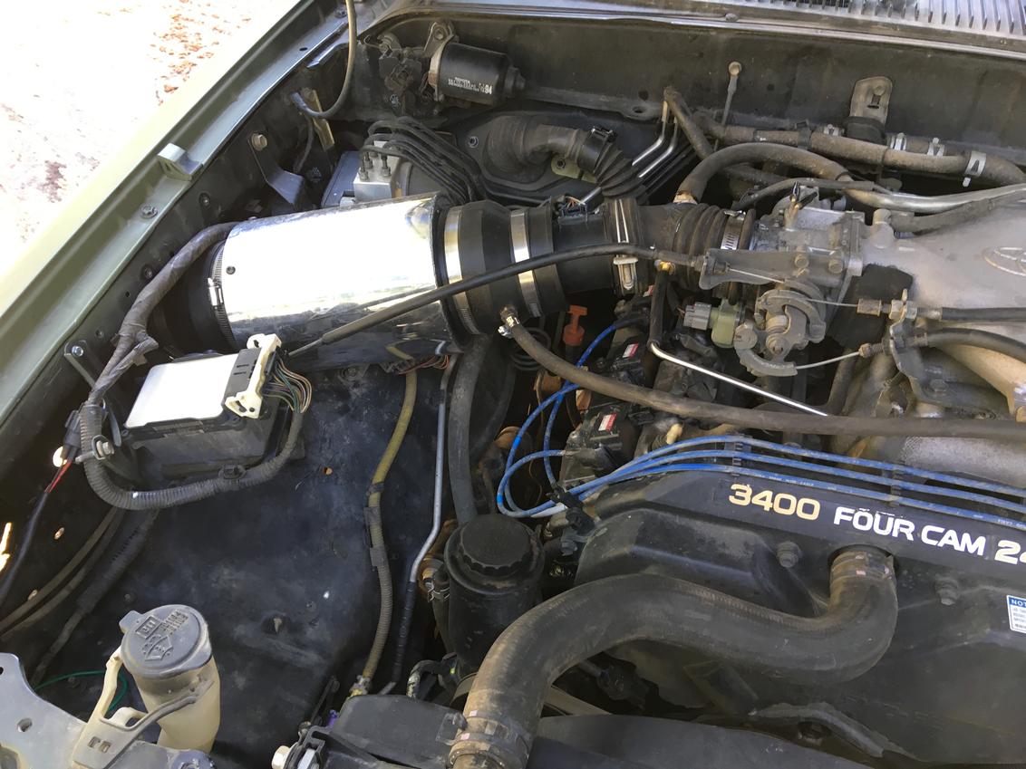

Intake mod and seat function
Finally wired my passenger Audi seat (3rd gen 4runner seats destroy my back) the Audi was my commuter now it’s a donor I guess. Next i want to get the heat function going on them
I also improvised a short ram air intake and took it straight to the side instead of going all the way to the front, I want to add an extra battery where the old filter was. I need to change one thing but it idles perfect and still acts the same so I think my improvisation worked this time. It’s loud though ¯\_(ツ)_/¯
Which bulbs did you use for the reverse lights? I just put LEDs in mine from SuperBrightLEDs and I am pretty disappointed in them
